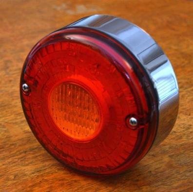

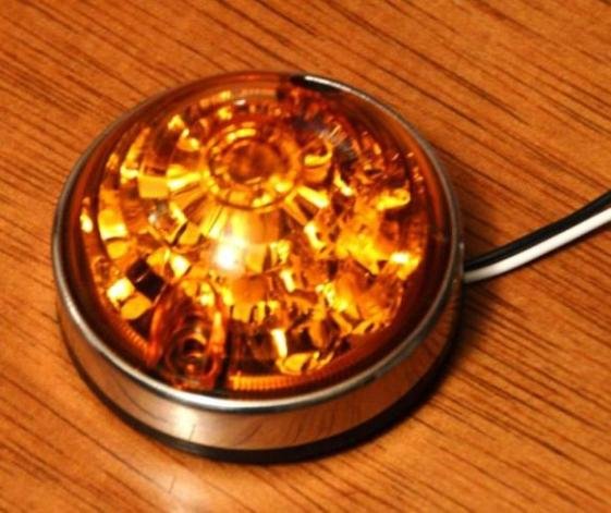

More lights, with added stainless surrounds; the rear p,b,i, led light is made in Aus and sourced through LR Gawley in Markyate. The indicators are led Landrover replacements, online purchase. Side repeaters are the tear drop italian ones.

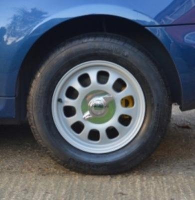

The wheels are matt silver bmw 6.5 x 15 with 225/60 tyres, giving an overall diameter of c.653mm 3% more than standard.

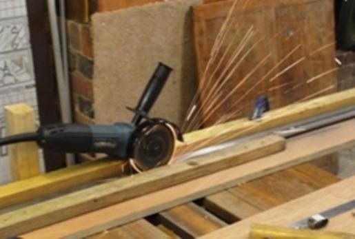

Below we are cutting up a flat oval SS tube to create two side strips, which are then pinched to give a soft V shape profile.[/SIZE]

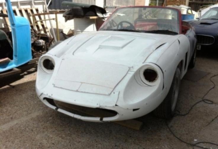

Here is a photo that shows the front end starting to take shape. It is a combination of Dino and SWB panels.

That's looking great
When I saw it in the flesh I was aware just how long the front overhang. But the rear is in proportion and it works.
Its always great to see all the separate elements when they blend into the final shape
