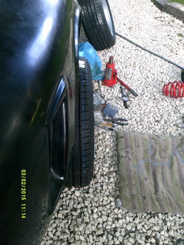

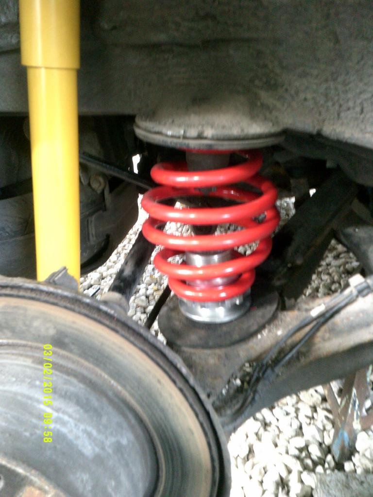

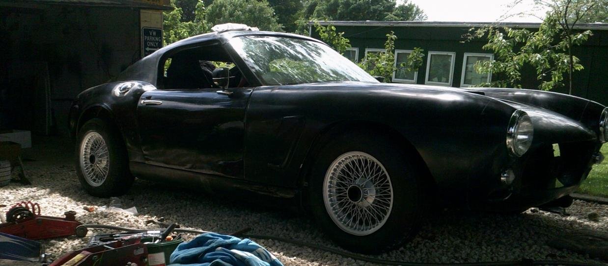

fitted the coil overs today I would have liked it a lot lower at the back but its set at the lowest. front is about spot on but until the wheels are changed and have driven it round the block to settle I not know the finished hight.

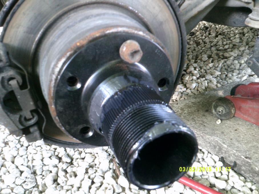

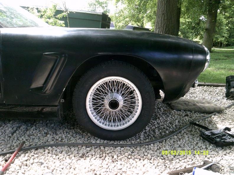

hubs and wire wheels are ready to go on but I am waiting on the spinners but I had to do a trial fit , well you would wouldn't you
new toys
after fitted
trial fit new hubs
27 Jun 2015, 4:51pm

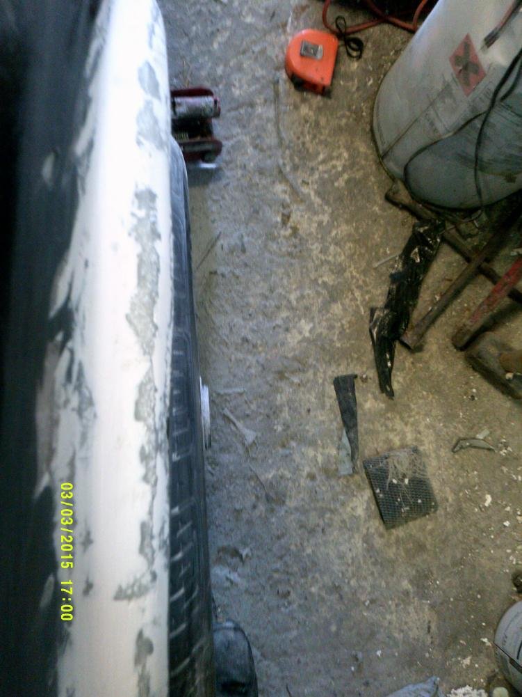

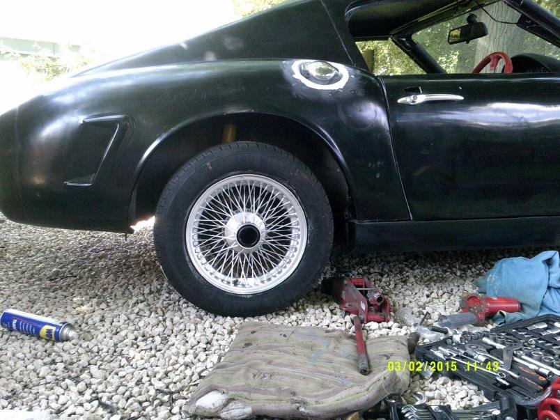

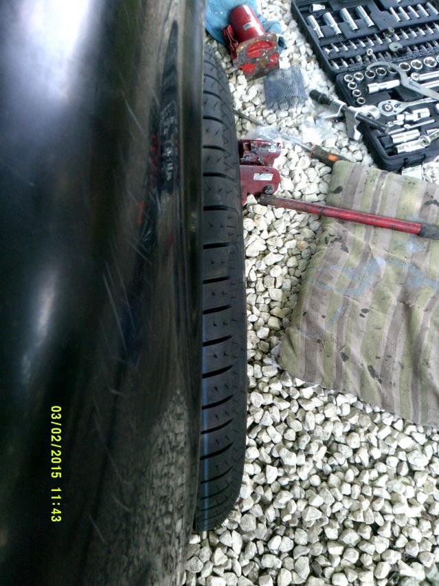

need to work on the rear off set
front wheels fit the arch for hight grate the back is sticking out a good 60mm plus so I need to get around the off set. I think the easiest way is just to flare the top of the arch.has anyone else come across this and dune anything different before I get the angle grinder out.
still on the jack
back on the floor after a bit of bouncing on the rear end
look no spinners lol

Bill Dutton ("Plastic Porsche" forum name) has come up with a way of narrowing the z3 rear axle 22mm per side using different hubs and discs. Have a look at the "250swb wheel information" tread. Or you could just split the arch all the way round with a grinder, leaving the bottom edge attached, and pull out at the top to cover them. Does Look great on those wheels btw.
You will find that the TA Technics rear springs will settle a little with use. You can remove the adjusters, as long as you fit a spacer inside the spring to centre it on the seat.
27 Jun 2015, 5:52pm
thanks I have seen that on the forum some time ago about changing some of the rear end. I think the split arch is the way to go it will give it a more aggressive look and add a few more curves.

ha...as I said I dont like wires but they do fit the car style at round 900 a pop its not a cheap option but some things are worth going that little bit more. just don't tell the wife

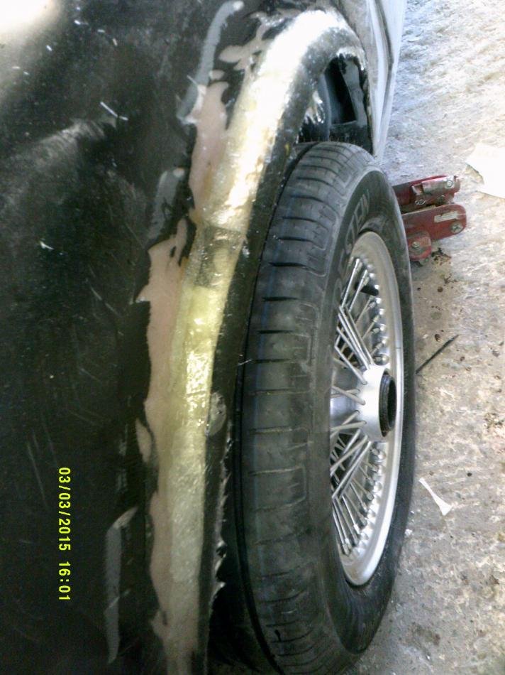

28 Jun 2015, 6:03pm

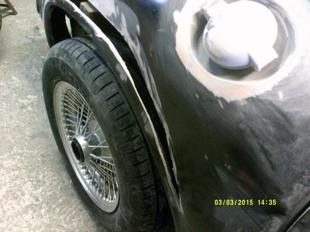

look away if your squeamish

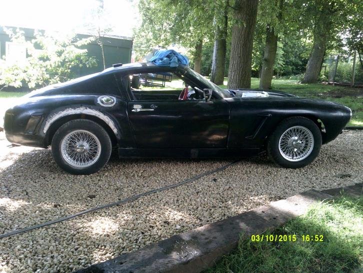

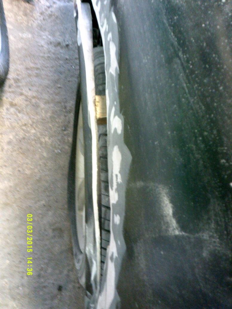

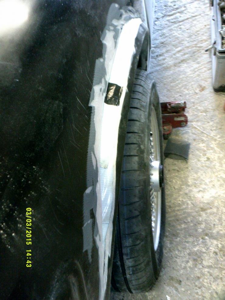

I have split the top of the arch and pulled them 50mm so the top of the wheel is just proud .
I measured a block of wood and propped it open using the shocker as the support
gaffer tape on the rear of the arch just to give the glass some support till it hardens
3 lairs of 600 gram latter
mans best friend a good bit of body filler to smooth over
still needs some work but its getting there, looking down the side front to back it reminds me of the old mk2 jag with the flair on the top of the arch

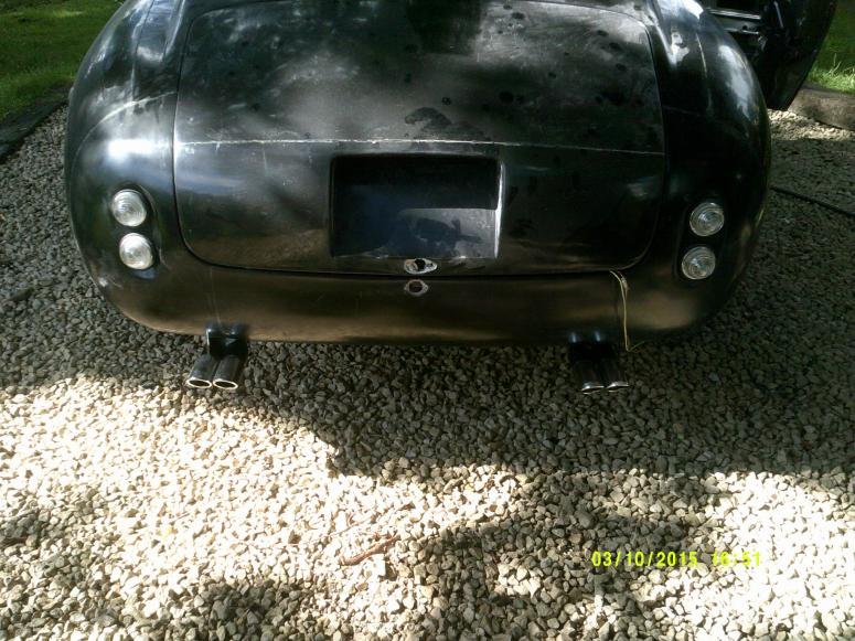

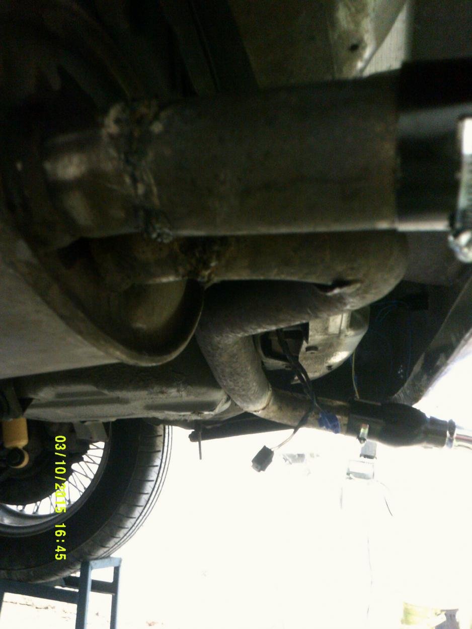

exhaust sorted
thought I would have a pop at the exhaust while I am killing time waiting on the window frames and grill to arrive. I had a back box off a Audi avant kicking around with some good bends on little bit chopping a grinding and this is what I come up with.
Attachment “DSCF0086.jpg” from the original forum could not be reliably recovered.
tail pipes are way to small ebay clanger they did look a lot bigger but they were ok for the mock up. the audi has a wicked tail pipe so I may need to find a other to match it.

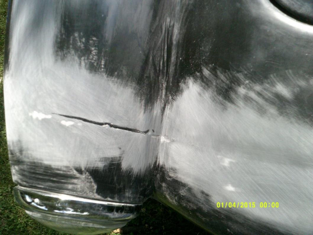

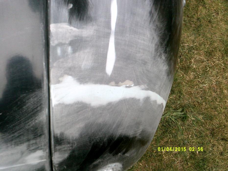

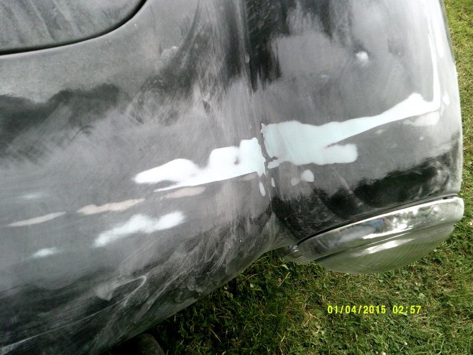

spent the weekend rubbing out joint lines from the moulding bit of before and after for you.
The plan never was to get it perfect but at first glance it is passable for now. as you can see form the pics I had to do some filling I did try to cut it back but the step was to big and I went through the gel coat and some.
Attachment “IMG_20150712_163458.jpg” from the original forum could not be reliably recovered.
The pictures make it look better than it is but experience has tort me to get it passable then let the experts do a proper job when I get it painted.
The boot latch handle has gone in favour of the original bmw latch on a boot pull off a mx5. I like the smooth look of the rear, I moved the handle twice then just took it off a filled in the holes .

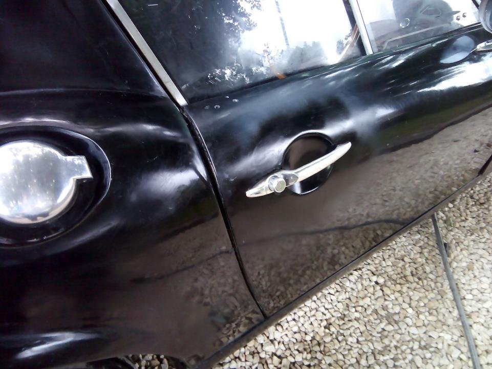

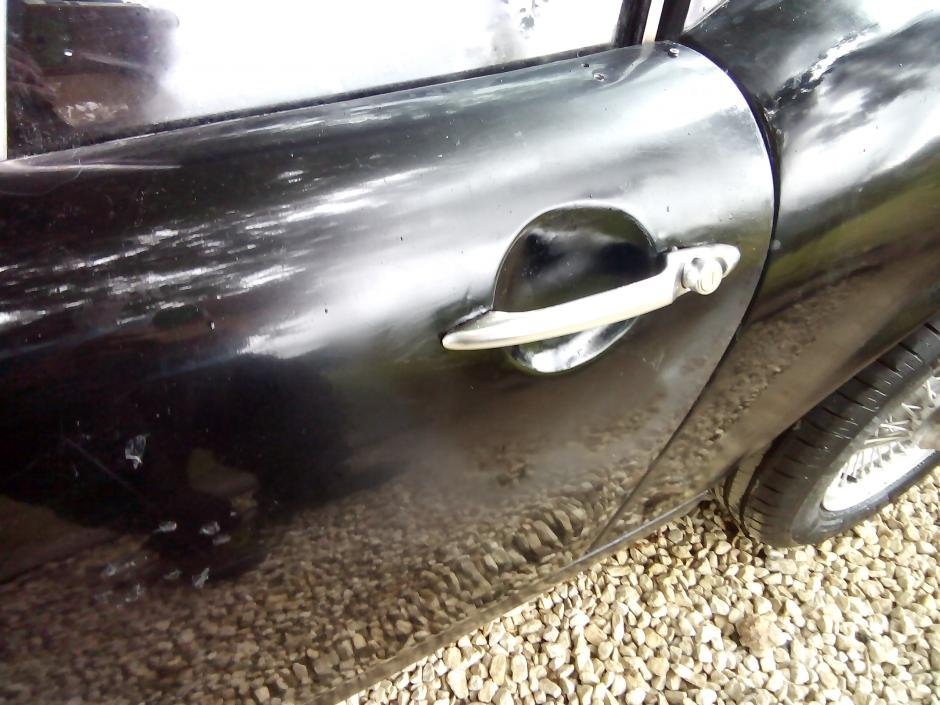

I recessed the rear of the door handles to make them look like they belong on the car.
fitted the side widows door skins are now bonded on and the grill and side repeaters are now on .

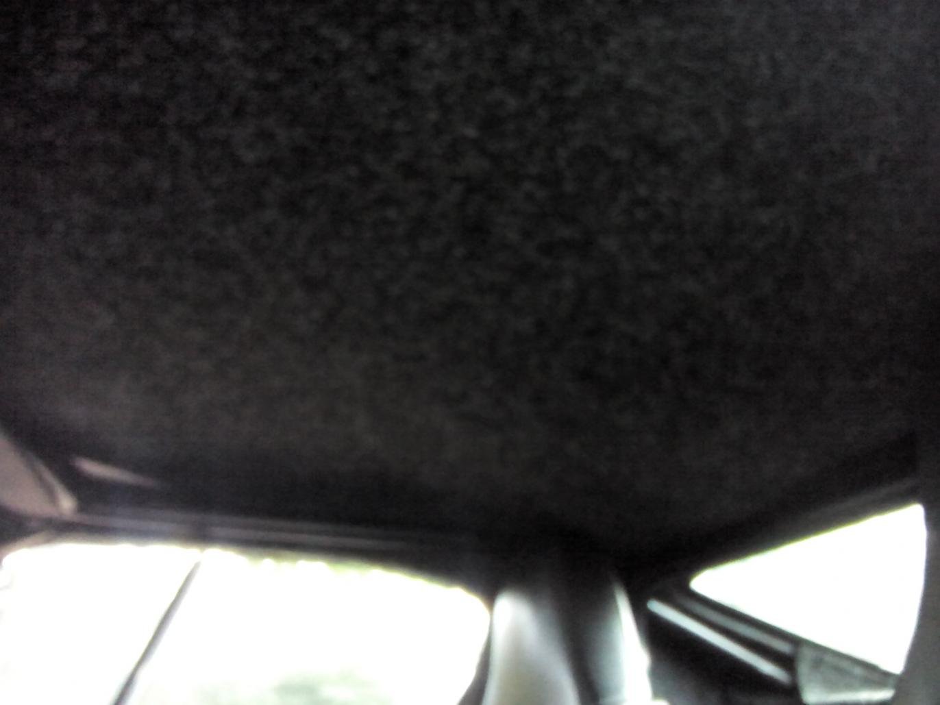

roof lining fitted ive run it all the way down so it matches in the back when you look through the window

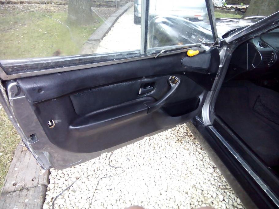

the original internal door panel has been reworked so it will fit with the new lower window frames
