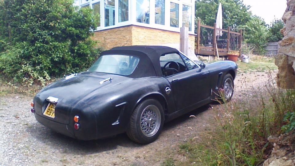

Ok its stopped raining

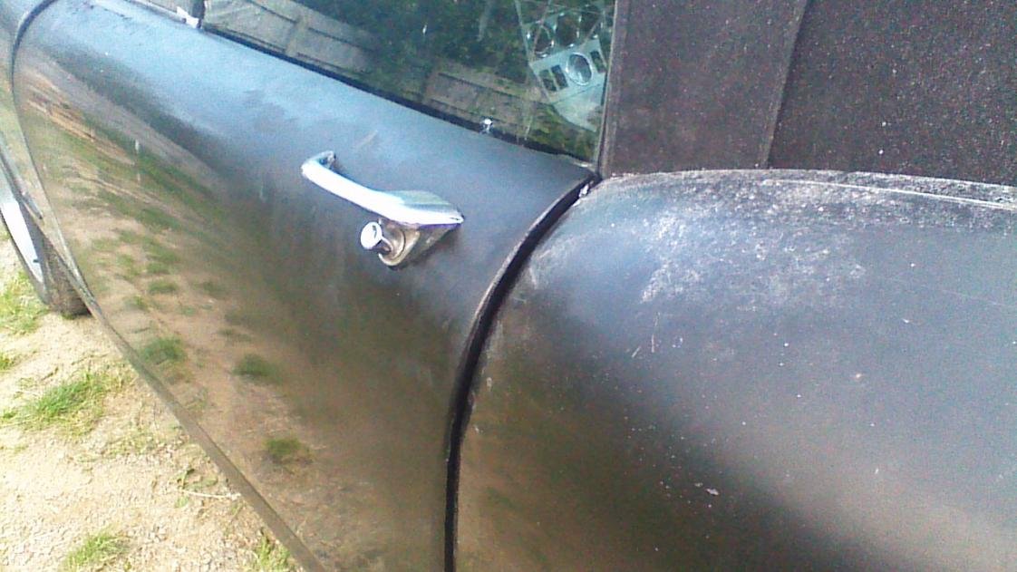

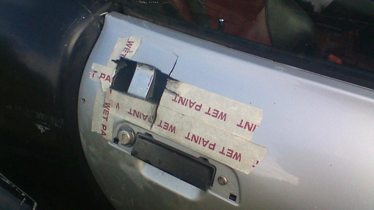

Door cut open triumph 2000 rear door handle - brand new old stock from dimmer bros, just needs longer 10/32 unf bolt as plunger the hole cut in the door skin will have a plate screwed over it using self tappers, even though the BMW handle and extension can be removed from inside I may need to adjust something, the black fiberglass door skin will be bolted and stuck on with stixall silicon stuff

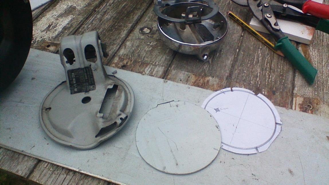

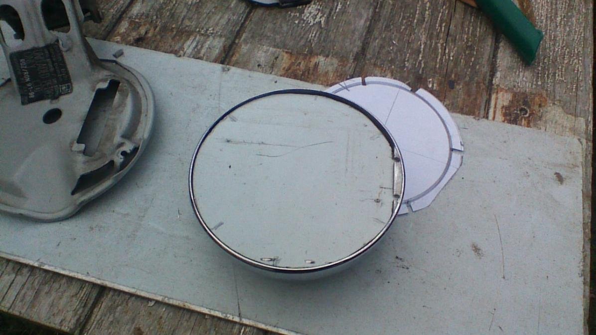

Hi spinners can be bought from Europa spares, chrome abs spinners set of 4 they come with a 2 hole screw cap fitting for attaching to the wheel

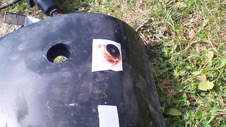

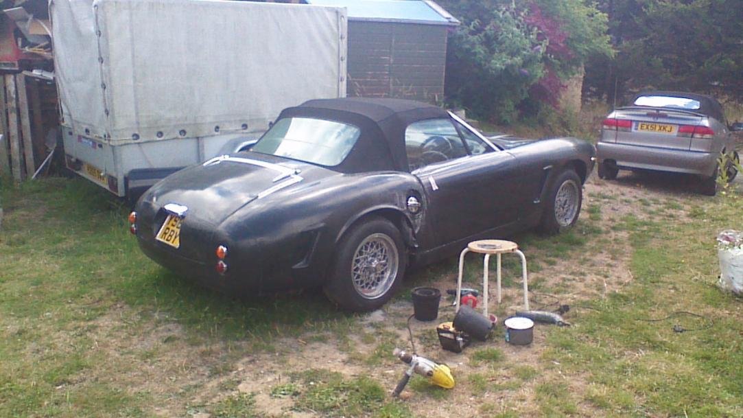

Didn't get much done this week end as I've been chopping the boot lid about, to mount a chrome number plate light plinth

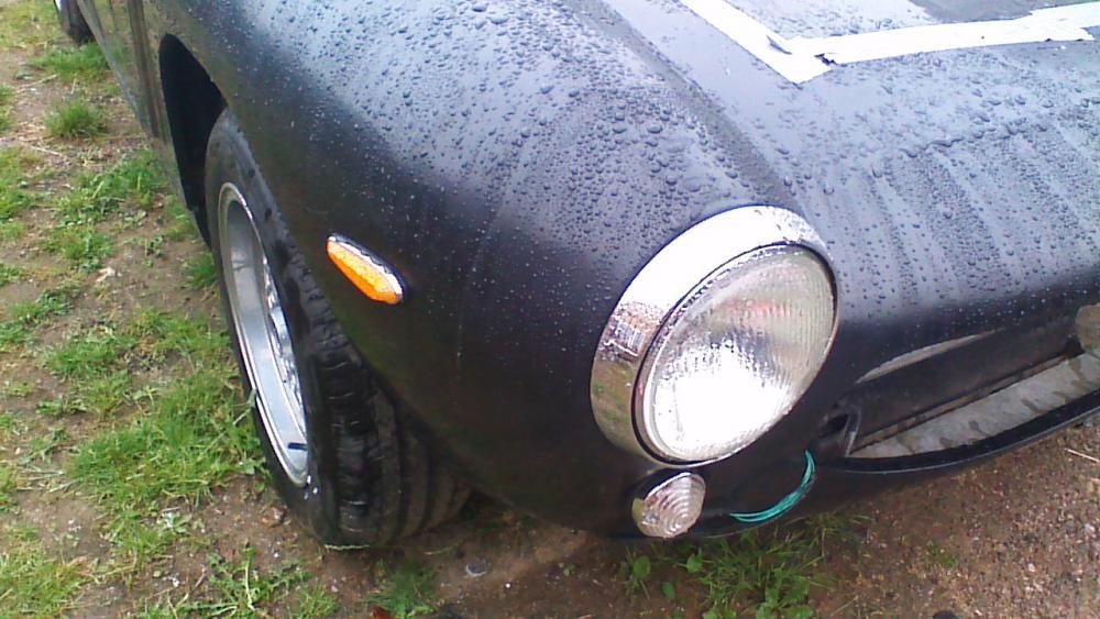

However I did fit one of the side repeaters
centre cap

The repeaters look great I have the same/similar ones from OKP.de? They cost quite a bit but worth it for the look.

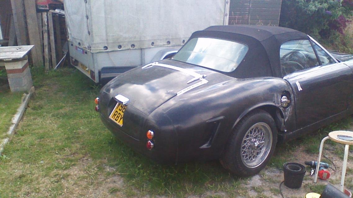

19 Jul 2015, 9:04pm
The hinges are Morris minor boot they need some slight bulges to be put in the boot lid to fit the curve but work well

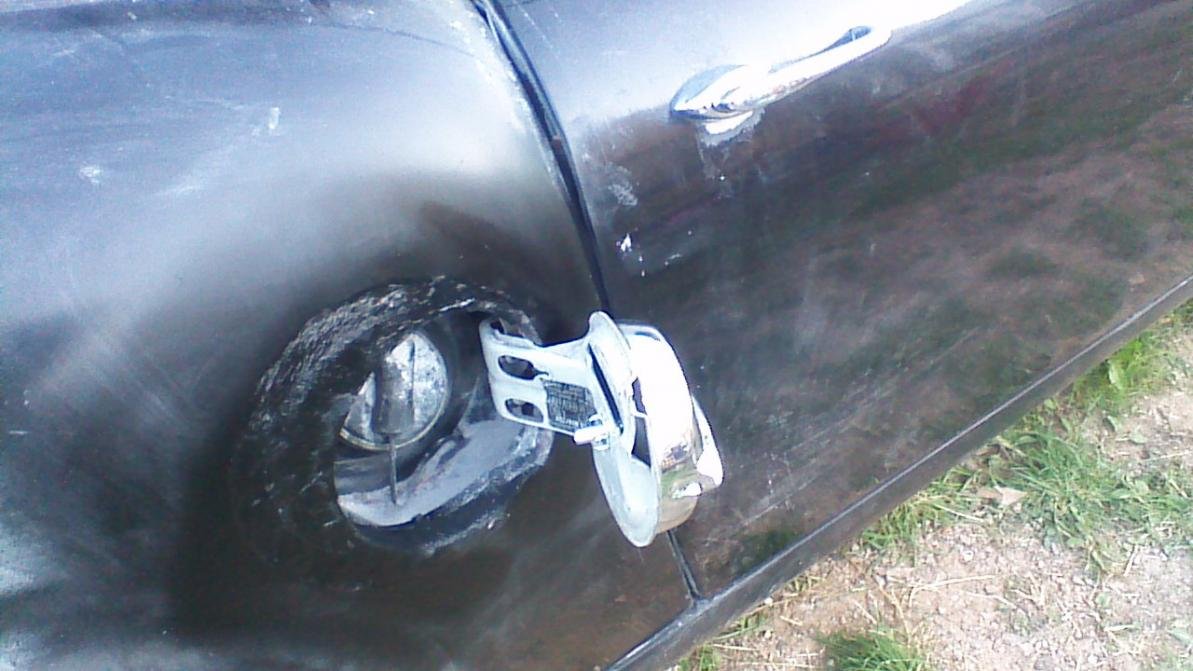

I'm going to try and fit the mini cooper cap over the z3 fuel cap, the mini mechanism doesn't fit very well and if I sacrifice the BMW wing panel around the filler cap and bond it inside the swb body I can keep the remote lock

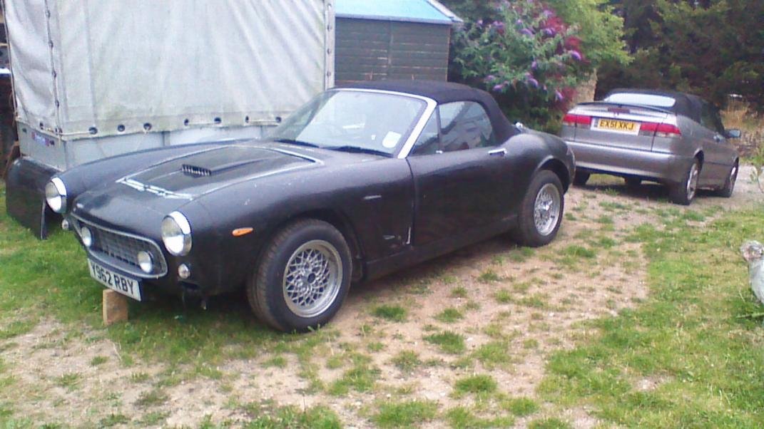

Its starting to come together now
I'm going to lose the rear aluminium bumper strengthening panel and extend the tubes to mount the body at the rear. I should also be able to fit a bumper or quarter bumpers

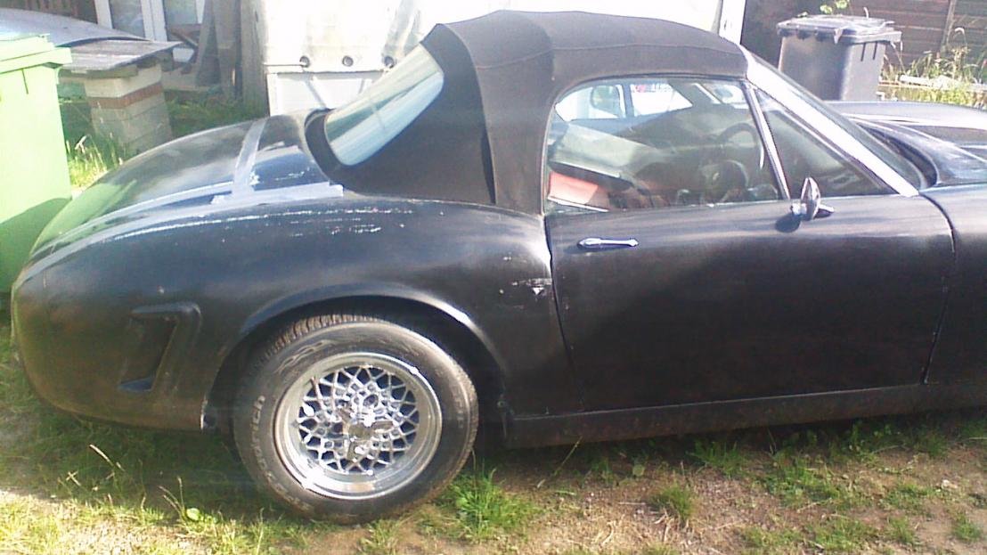

21 Jul 2015, 5:15pm

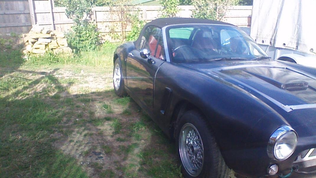

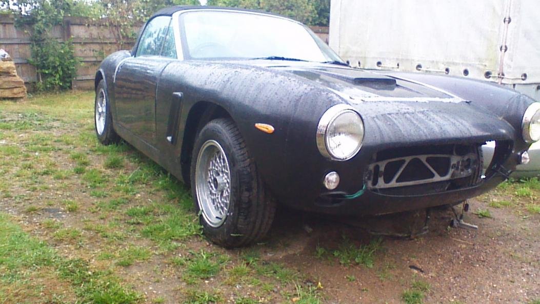

I had to move the car to cut the grass / weeds
Attachment “WIN_20150721_121905.jpg” from the original forum could not be reliably recovered.

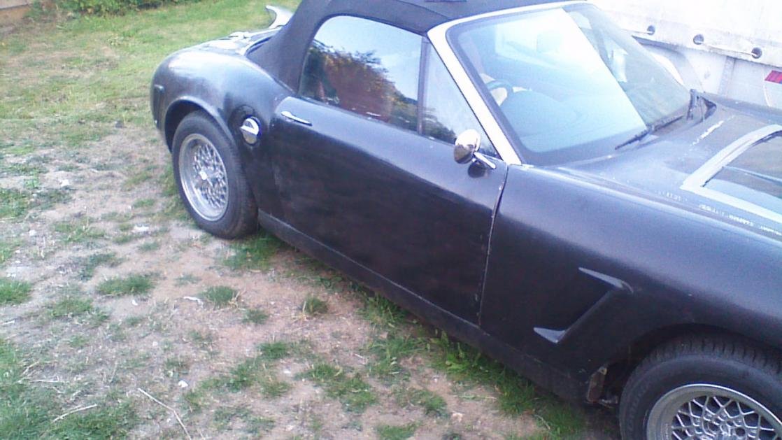

Now to do the passenger door

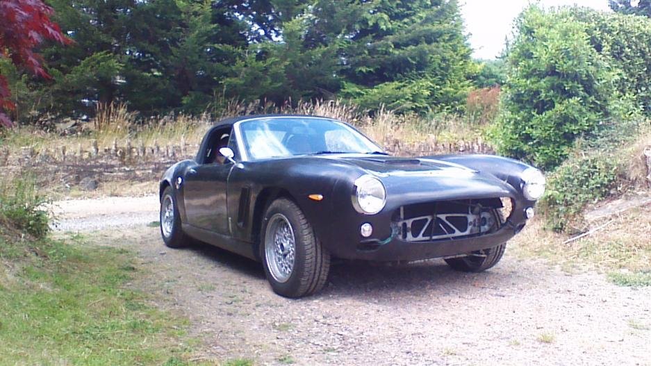

9 Aug 2015, 9:51pm

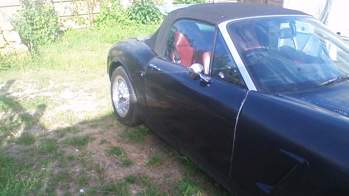

Changed the triumph 2000 door handles to herald / finesse, they are bigger and look more like they belong. Quite a lot of work to recess but I still have the BMW handles and drivers lock

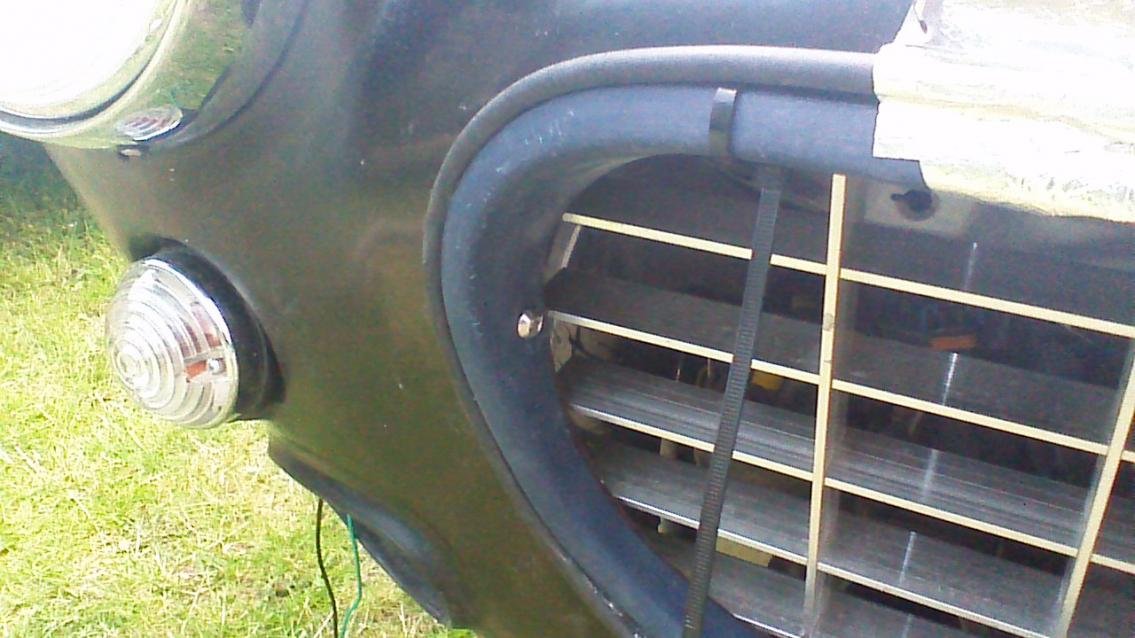

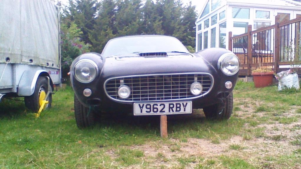

Messing with the grille, its now fitted, air con fan still in place, just the mesh removed, power steering pipes slight mod - will probably re route later

10 Aug 2015, 6:57pm
regarding the grille....
I am pretty sure that it needs to be fitted the other way around....
The upright slats are fitted to the top beam....all is held together by the 2 ali strips, so you will not loose it but still....
10 Aug 2015, 7:33pm
Not sure I understand
Vertical slats can't fall out as they are held against fiberglass surround and would have to come forward
Horizontal slats are held in by two vertical strips
I have fixed the horizontal location bar to the lower edge because I wanted to keep the lower part of the grille surround straight and have some extra strength where the grille is close to the air con fan
