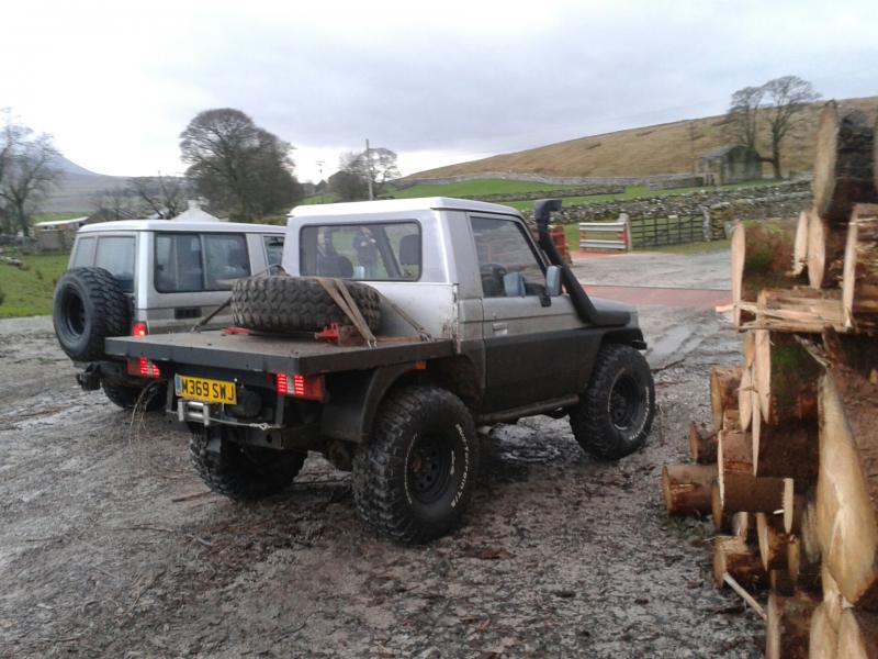

Done some more digging the G Wagen has solid axles whereas the ML has independent suspension all round, this may actually make a replica more straightforward as welding on panhard rod, shock,spring mounts etc is serious geometry not to mention chassis modification plus its very difficult to get them to drive straight and wobble free, I have built 2 serious off roaders that where road legal a couple of dedicated off roaders off Suzuki chassis and helped friends on there off road quarry basher projects and they only ones that work safely on the road are when the suspension was left mainly standard and the body inner metal is chopped to take the big tyres, generally the only reason suspension is lifted is to fit the bigger tyres on as it is only tyres that give you more clearance particularly on a solid axle. Therefore I would suggest sticking standard ish suspension height with wound up front torsion bar or proprietary air ride all round fit the tyre size you want and then chop the g wagen inner body to suit. This way the extra axle can just sit there looking pretty with a simple suspension set up I'd look at a torsion bar set up off a hatch back with ML hubs added as the brakes will have to work, its never going to be a serious off roader but it will look tremendous and should be nice to drive, the picture link is my mates land cruiser we cut the back body off after a tree incident added an alloy truck back body and winch chopped the inner arches and external arches at the front added 35" tyres and then had to ratchet the suspension down 3" and deflate tyres to get it out of the garage, that motor is superb off road and is on completely standard suspension, is my point. Ed let me know if the link works it does on mine.
7 May 2015, 10:13am

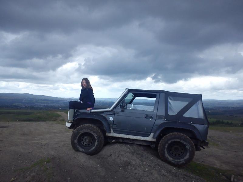

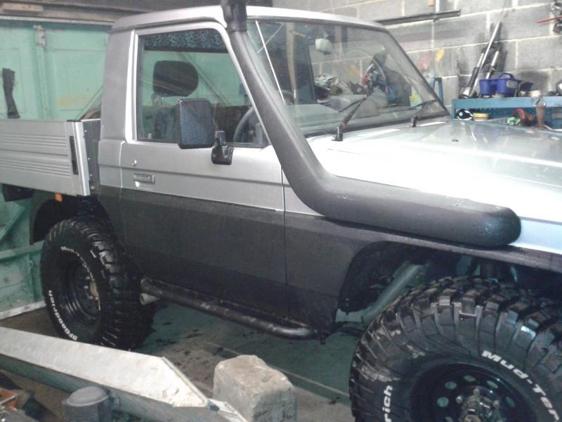

Un finished but next to a standard but over tyred land cruiser both standard suspension.can't find a PIC of bead locker wheels.
Suzuki built for my daughter pretty standard leaf springs sat on 31" tyres with body chopped and plus 2" land rover arches drives bang on, ratios altered to compensate for tyres land cruiser 3.0 deisel will cope with 35's on standard gearing.
Looks like you are lucky the ML has a very popular stud pattern 5x112 so finding steel wheels should be easy there are plenty banded ones off VW's on eBay so once your at rolling chassis stage it should be easy to work out what offset you need, I will check with my friend where he gets his tyres from I think they are in Nottingham and pretty cheap I recon you will get 6 wheels and tyres and bead locks for around £1500 but check on tyre prices before commiting to wheels same size tyres for 15,16,17" rims can vary A LOT. ED
