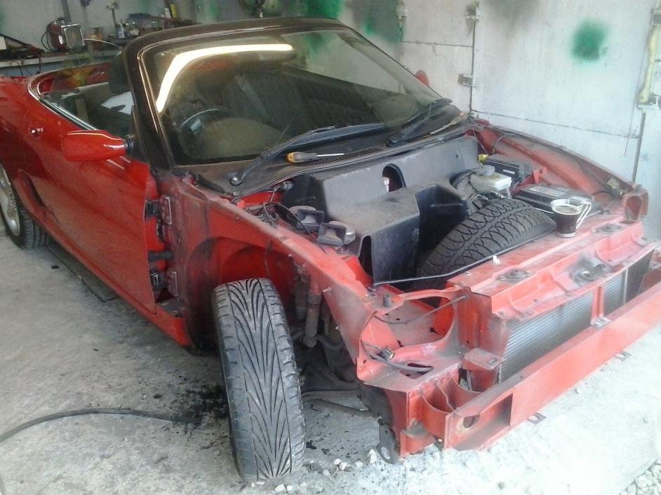

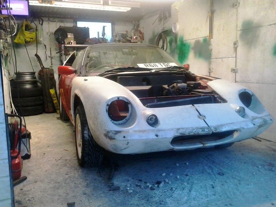

god it been a long week, anyway had a few hours in the garage today and here is ware I got to. mgf stripped and starting to look at how to put it back together. the bonnet is going to need a big bump at the to get over the wiper cowl. just held the back onto look at the lines and it looks like it may just work out.

21 Mar 2015, 9:39pm
That's looking like it's going to work. Good effort!
