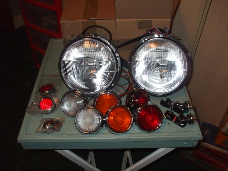

I've bought-
Headlight units,
White front indicators, red and orange rear lights, all Lucas L539.
Round rear reflectors because the rectangular originals always jar with the rest of the lights.
Round side flashers and round number plate light.
I'll buy another pair of clear L539 lights later to be reverse and rear fog (with red bulb), when I've decided where to fit them.
I was going to buy headlight rims but need to know if I need the splayed Morris Minor type of the straight type to fit with the body lines.

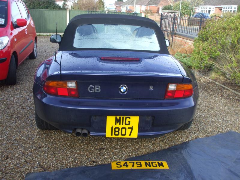

Not much different at this stage obviously, but the number plate change went smoothly.
Sorting out the fuel neck parts next.

The lights were all bought from a stall at Newark Autojumble (Lincolnshire)
I will be going again on March 8th as I need to get a couple more and some Morris 1000 type headlight rims. I think they were £25-£30 pair but I got a bit off as I bought all the lights together.I paid £150 for all the lights in the picture. I can get you his number or get some on your behalf and post them on if you like.

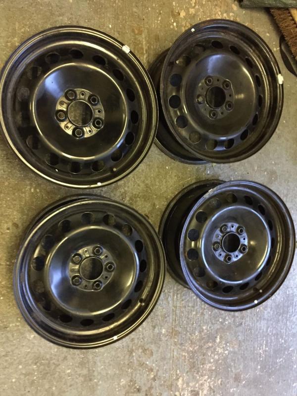

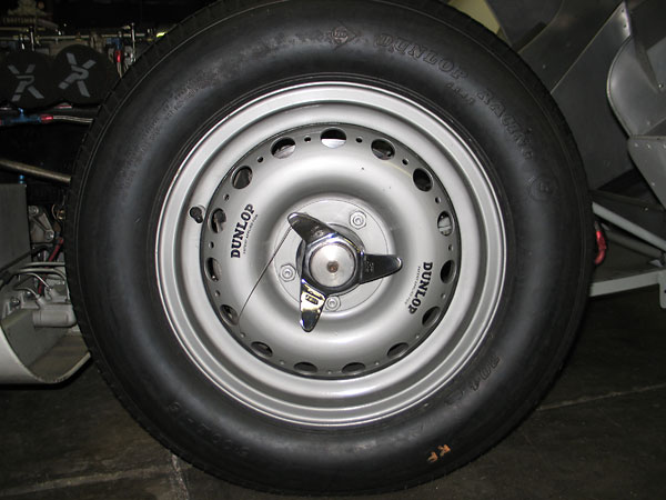

I've gone back to plan A of many when it comes to the wheels.
I've just bought a set of BMW 7.5" x 17" steels which will be finished off in D Type Jaguar racing alloys style but using false knock ons.
If it looks ok it will also mean that I can use the good types I already have and the speedo will read right.
16 Feb 2015, 5:39pm
hurnleft wrote:
...I've just bought a set of BMW 7.5" x 17" steels which will be finished off in D Type Jaguar racing alloys style but using false knock ons...
Well done in finding those- they are usually snapped up for winter tyre use. I didn't even think you could get 17" BMW steelies. With the authentic extra holes- they'll look good.

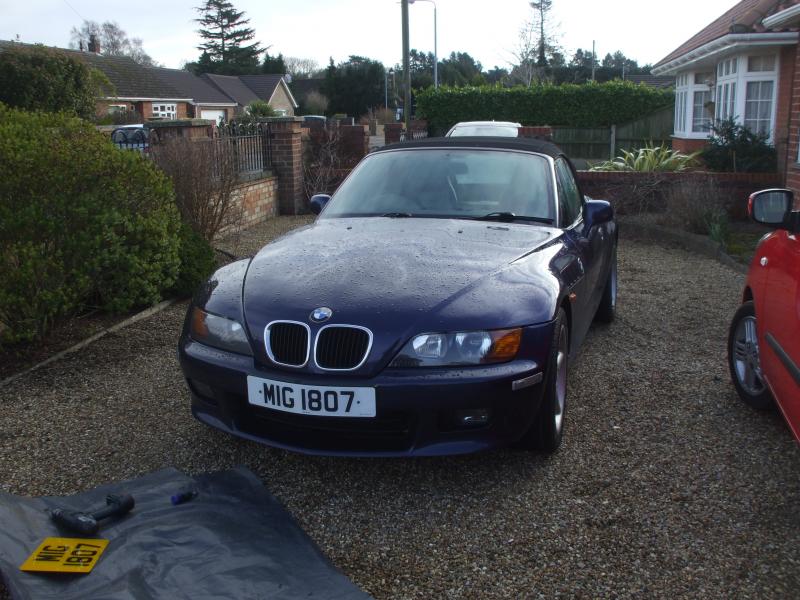

Bob dropped off his Z3 at the worshop today, strip down will start tomorrow:

I didn't think you could get 17" steels either, I'm using the 15" alloys, on my z300s, the ones that look similar to Dunlops until I can afford a set of 16" Billets 46. I do like the Dunlop style, although everyone at work keeps telling me to get wires.
Andy
10 Mar 2015, 5:07pm
Andy...The body is currently resting on one of Chris' cars, mine is the standard one behind it. The wheels are Chris' 15" wires, mine are going to be steels but the standard alloys are still on until the body is done so I can see if there's room under the arches to have the steels banded slightly. If everyone keeps telling you to put wires on, that sounds like the perfect reason to do something else!
