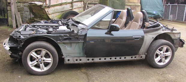

I have managed to strip my Z3 but Haynes manual doesn't tell you "do this first" and misses some vital bolts that you can only find when the panel doesn't move. I have taken pictures of progress and will put some text together to help anyone else in the same boat.
Did someone post a comment about Ferraris having a happy face?

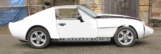

I am now offering up panels to see how they have to be modified to fit. These panels are held in place with sticky tape to give me an idea how it looks.

It is good to see some progress and it is beginning to look in reasonable proportion.
The wheel arches appear to be much as you anticipated, with the forward movement of the front and rear sections: how many inches ?
Tell us more please.
15 Mar 2015, 2:29pm
Wheel arches
No this shows the wheel arches in their proper place on the panels. I made some arches and tried them with the nose section moved forward but it looked wrong. I will post some pics later.

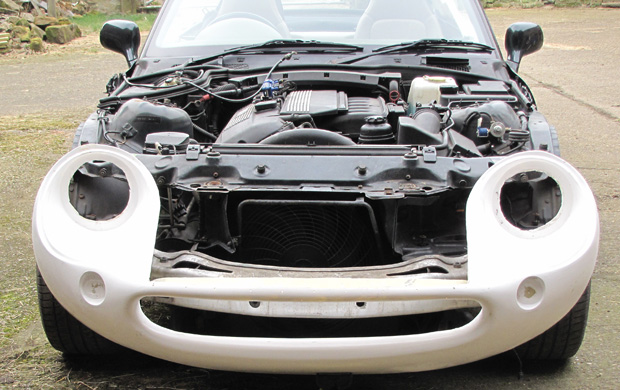

First fit of complete nose section
I'm back in action now and have bonded the panels together and put the whole nose section on to the car to check for clearance and fixing points. These two photos show the decision I made to have the bonnet lifting from the rear in the same way that the Z3 does. So the 275 engine cover will be bonded in place and the wing will be cut in a continuation of the line across the front and round the head light, down to the edge of the wheel arch with the angles all worked out to give clearance for the action of the Z3 hinges. The rear edge of the bonnet needs to be lifted slightly to give the right line and a splash will be taken from the Z3 bonnet to give the correct profile around the windscreen.
8 May 2015, 8:36am
That's a really elegant cut and shut of the kit, the nose looks quite high - will it sit any lower? looking good!
8 May 2015, 6:10pm
275GTB/Z3 nose
It is a problem. The front has to clear the radiator at the top, which on my 2.8 incorporates air conditioning and at the bottom it rests on the standard plastic under tray. My car is also fitted with the smaller option 16" wheels which will make a slight difference if you use 17". Also, the rear edge needs to be set slightly higher to get the line right.
