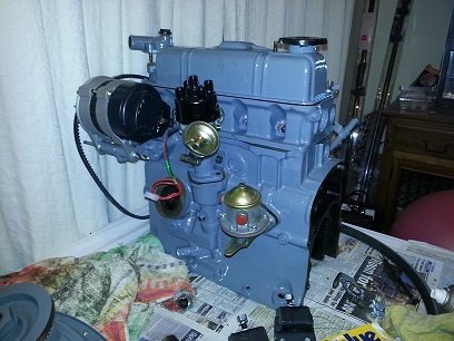

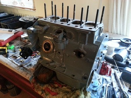

not a lot done this weekend due to Mothers Day duties, but have been collecting everything together for the engine....
new valves will go in the head this week and hopefully I cna get the engine build in the next few days. That will be that job out of the way then. :eusa_dance:
I have cleaned and painted the gearbox in the same blue - it was reconditioned about a year ago so apart from new mounts, that should do it for that.

11 Mar 2013, 7:27pm
Bloody hell , that engine looks the part, better than black well done
11 Mar 2013, 8:41pm
Yep, proper show car shine on that motor, well done.

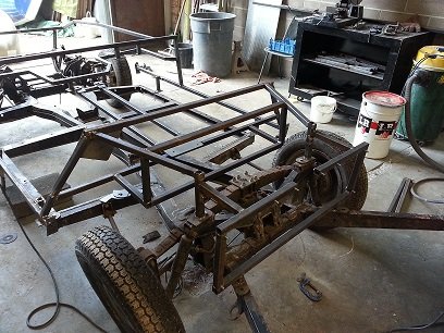

Mr T, funnily enough I went to Mike's on Saturday to pick up my frame, but while I was there, I asked if I could 'borrow' his welder to make some mods to it. If you remember from my Sammio build, my little mig welder kept cutting out and as my mum alwasy said - if you don't ask, you don't get! :eusa_dance:
I wanted to move the tank to the rear and put in a luggage space as that was really useful in the Sammio. The end result was that I left my frame there and Mike said he will use that to be the 'standard build' now :icon_cool:
I quite like the idea of being the guinea pig if I can help influence the design to make it better for others in the longer run!
This is the "modified" frame...

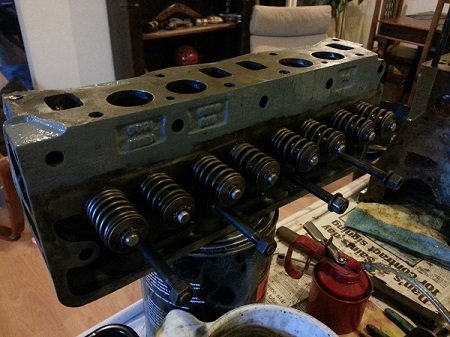

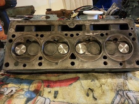

When I got home I started putting the engine together....
New valves ground in....

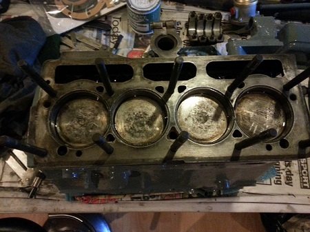

Pistons in with new rings....
I am just waiting on the new thrust washers from Rimmers (i'm tightening up the end float from the standard 8-14 thou to around 3-4 thou) and then the crank can get put in and the engine closed up and built.

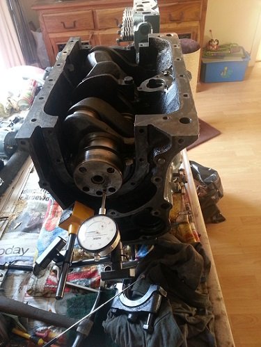

small pictorial update as I built up some of the engine last night...
checked the endfloat and ordered the new thrust washers accordingly.
then the bottom end got fitted up and pistons in...
