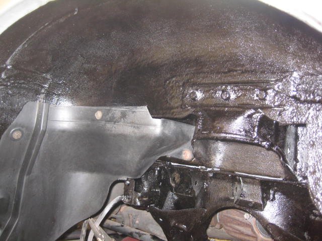

Pre GRP work
Been keeping myself busy in the garage while I wait to go and see Chris on the 23rd to sort out the kit. Decided to strip down the rear suspension, deal with any worn parts, Brake disc's Pads etc :eyebrows: . Glad I did in the end as the rear hub to wishbone bolt was bent and now awaiting new coilovers and discs & Pads. So now coating the suspension arms and decided to treat any surface rust and cold galvanize everything, followed by a good dosage of underseal. Result below

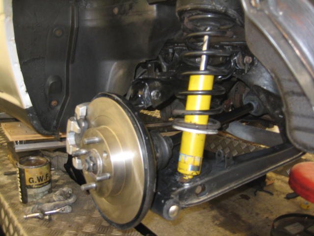

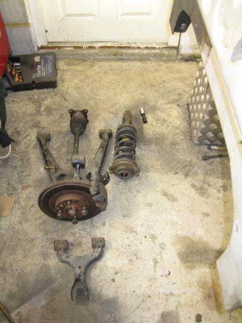

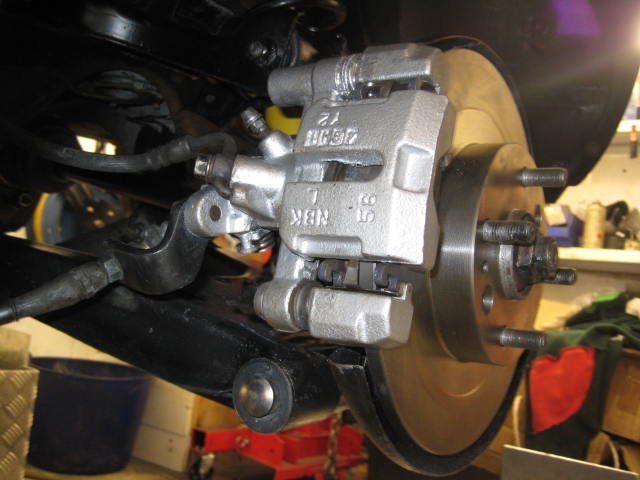

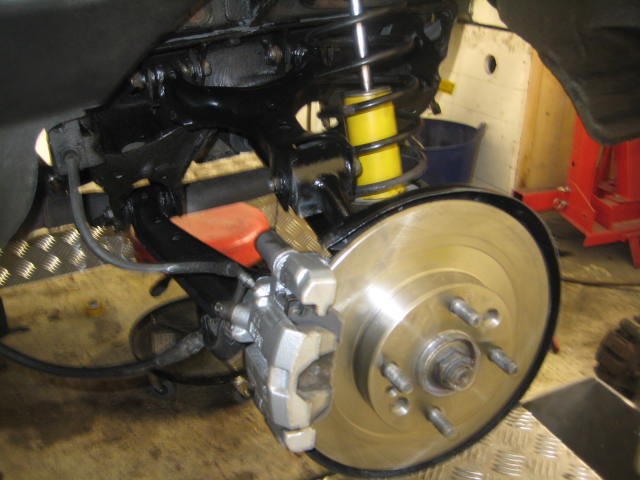

suspension
Continuing work in the garage with getting rear suspension sorted out.
Stripped off car, in a slightly sorry state
Coated and refurbished with brakes overhauled
17 Nov 2012, 9:58pm

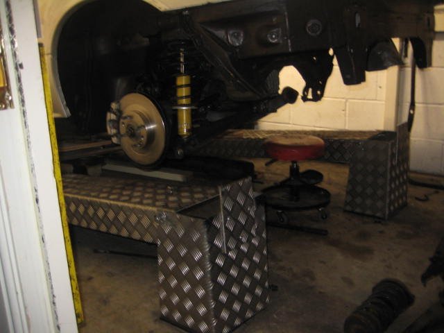

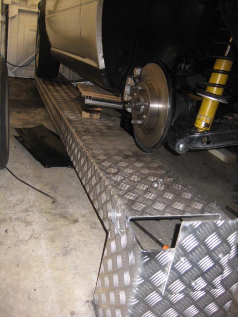

That looks really good. Are they standard shocks/springs?
You also seem to have a nice working height. Whats the car up on??
17 Nov 2012, 10:13pm
Ramps
Seanick,
The car is on drive on ramps that can be elavated once the car is on.
Here
At the moment have refitted the Bilsteins and standard springs, but ordering some coil overs to give the option of altering the ride height for the flexability once i have the new wheels and the body on.
Ramps were from a company called Levo Artis

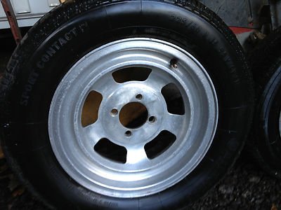

Slot Mags
Snipped up for a 100 notes, wondered if they would look too hot rod if powder coated in anthralite. Might suit Chis's pick up though...... mind you adaptors will cost 3 time what the wheels did.....:dizzy: :dizzy:
