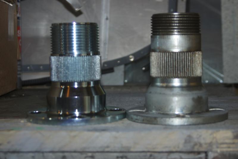

Hi all I am back well ish the house repairs are coming along slowly but being held up by social distancing which is giving me a chance to do a little bit on the car the new wire wheel adapters arrived and are a perfect fit Look at the difference between the old and new ones.
I can only assume the old ones are for 5 x 15 wires mine are 4 1\2 x 15 there is a difference apparently. so if anyone wants a set of wire wheel adapters for triumph spitfire / herald or gt6 5 x 15" cheap let me know.

Hi Deggsy, sorry to be the bearer of potentially bad news, but I suspect that your new adaptors are for Spitfire 13" wheels only.
The splines on 14" and 15" wires are the same regardless of the rim width as the centres are interchangeable (some have more/less spokes but the hub is the same width), but the Dunlop 13" wheels fitted to the Spit/Herald/Vitesse/GT6 have a narrower central hub. If you trial fit a larger wheel to your new adaptor I believe you'll find that the threaded portion won't extend out of the wheel centre so you can't fit the spinner.
The 13" adaptors do tend to be cheaper at about 2/3rds the price of the larger ones, and that almost caught me out when I built my Spyder.
I'm struggling to find an article that details the difference, but read the info on this ebay listing -
https://www.ebay.co.uk/itm/Triumph-Spitfire-Herald-Vitesse-wire-wheel-hub-adaptors-knock-on-spinners-set-/383101263911
Hope you're able to sort it and fit the wheels you want.
2 May 2020, 8:32am
I have fitted them the new shorter adapters are the correct size for the triumph 4 1/2 x 15" wheels (bought them on ebay and checked with the vendor first) so I believe the the longer ones are for the 5 x 15". Moss sell adapters which fit both sizes I don't know how that works?
Thanks for all the advice.
Cheers Deggsy

Yes to both questions they came as a complete set with the wheels I only discovered the problem when I had the car jacked up to bleed the brakes?
19 May 2020, 1:53pm
I think they must be earlier ones off the 15"x 5 wheels? £50 plus p&p if anyone wants them.

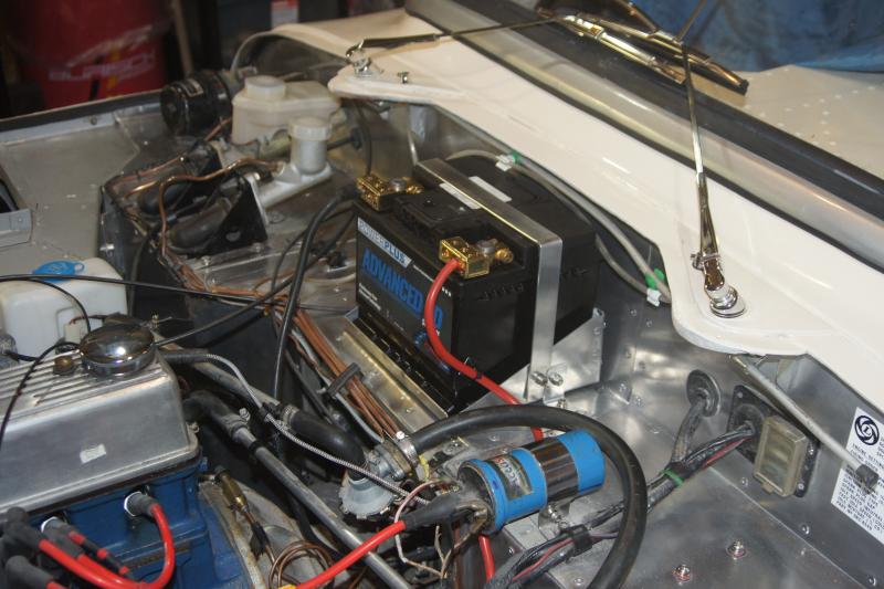

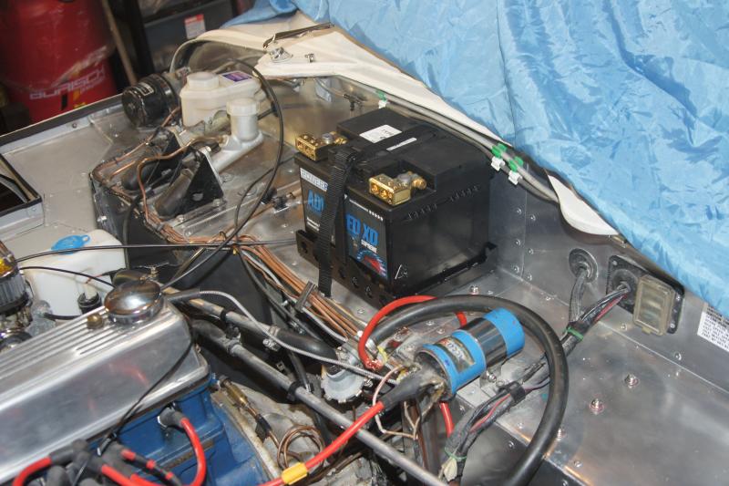

I managed to get a few jobs done lately I bought a new battery as the small racing one wasn't suitable for this I had to re-locate the battery and make a new tray.
But it didn't work out the way I wanted it as I had used the last of my alloy sheet and couldn't get any more I bit the bullet and bought one.
I have made a alloy clamp just to be safe.
As you can see in the photos I also had to re-locate the washer bottle.
That's it for now keep safe everyone.

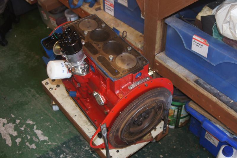

Paul um no and yes the brakes need bleeding, not to bad. But just did a compression test yesterday after putting the engine back together and it is horrible 175. 135. 95. 90psi not good, it's running but will have to come back out at some stage. after I get everything sorted with the DVLA.

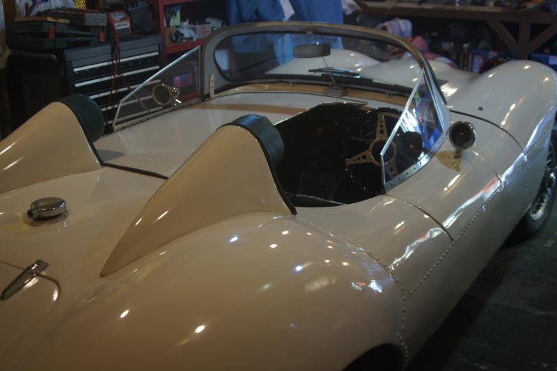

28 Feb 2021, 12:16pm

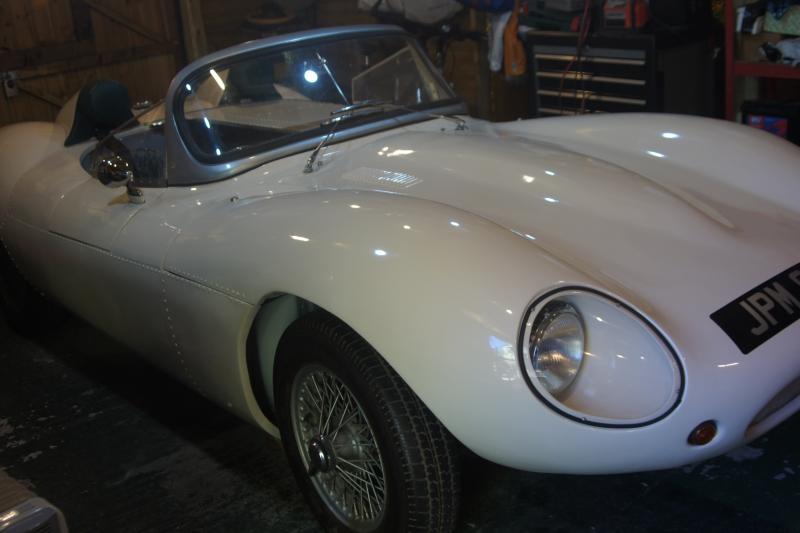

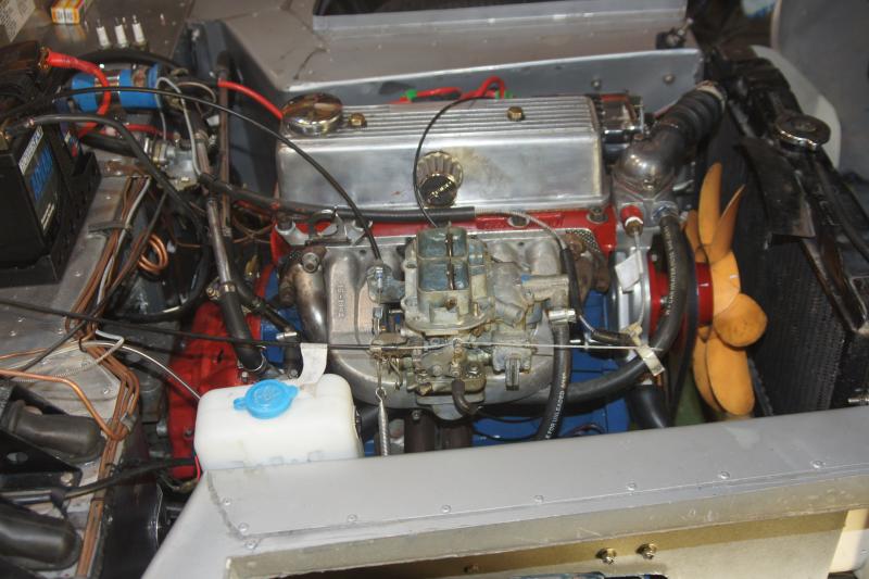

progress so far
This is the progress so far
Not very good photos sorry.
and this is the offending engine.
I had my suspicions about the engine so last year i bought a short block from Chris in Honiton it had been re bored and I had the crank reground.
at this stage now the unleaded hed will come off the other engin as will the flywheel with it's pre-engaged starter. I will get that done after i sort out the changes with the DVLA :amen:
