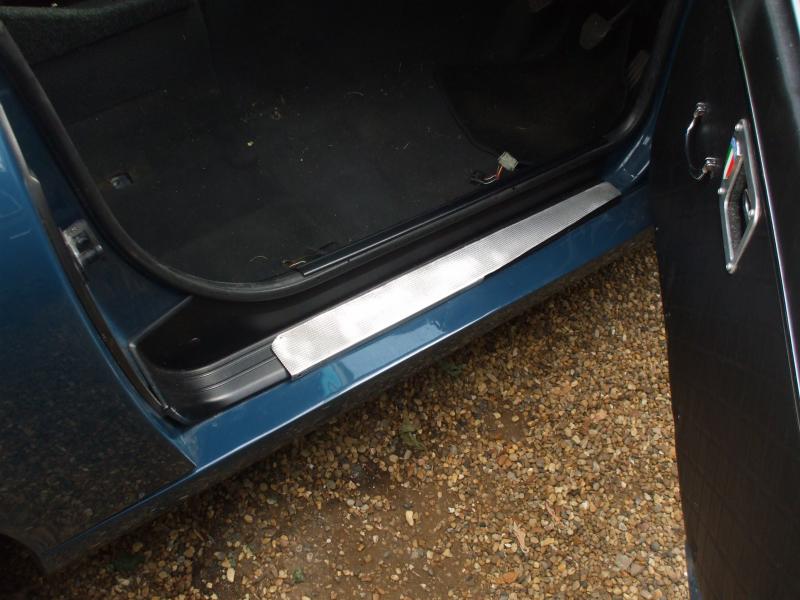

So in the last week I've sorted the wiring that had been cut through when the car was painted, refitted some of the plastic trims inside by the doors and rear of the seats and finished off the rear parcel shelf area although I still have one more waffle alloy tops to make where the seatbelt comes through
It all looks a bit bare at the minute but most won't be seen anyway when the seats go back in.
I made the alloy sill kick trims from scrap MGB ones which I cut down. They loose a little of the plastic look of that area.

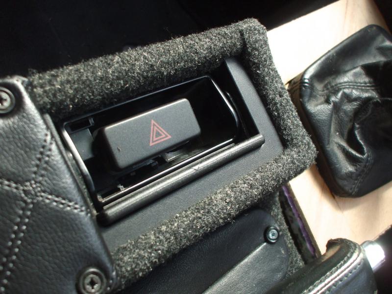

Bob doesn't the hazard switch have to be visible for the MOT? If not great idea!
30 Sep 2016, 6:40pm
Fair point but if the ashtray's open, then it is visible so hopefully that will be good enough.

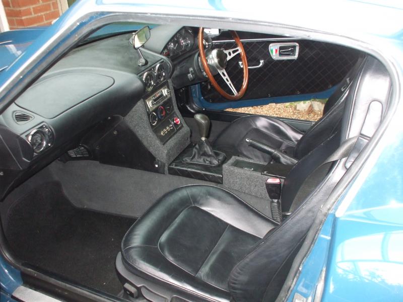

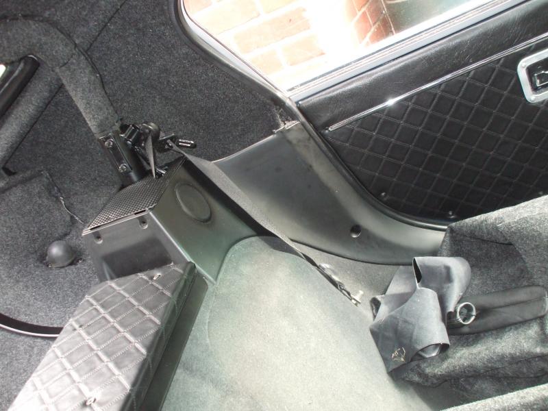

OK, interior details.
First problem is I'm making it up as I go along so some bits appear and then get changed.

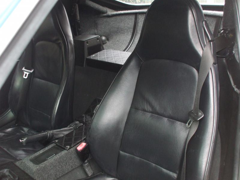

The door trims and dash/console, I've shown the making/altering of earlier. Front kick panels and the side trims around the doors are stock BMW (apart from the XJS chrome grilles over the BMW kick panel speakers.

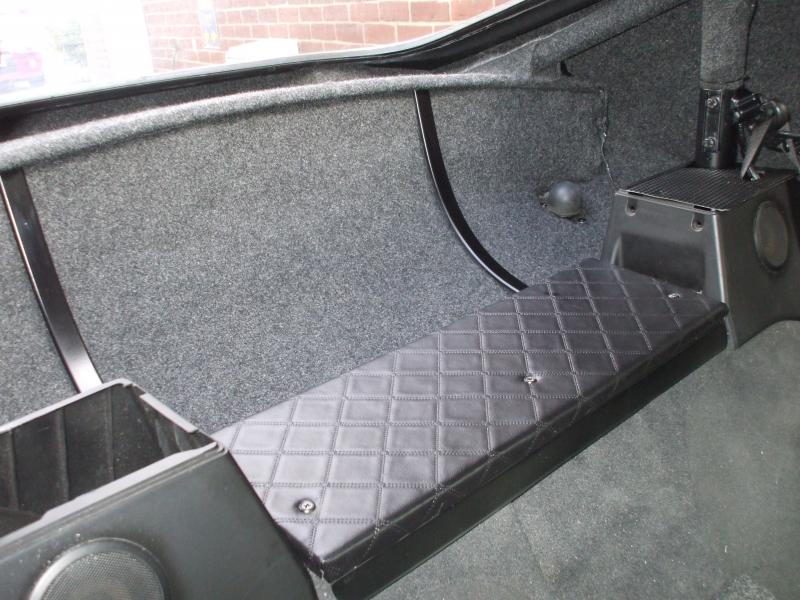

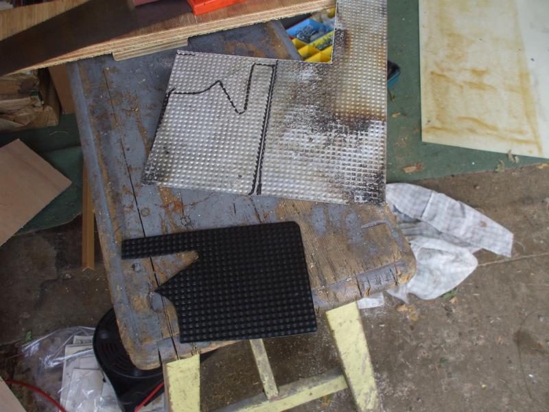

On top of the rear speaker housings would have been a lot of BMW plastic but this was all beige so was sold a long while ago. I've now made caps on them from some pressed aluminium scrap that I found in the shed.

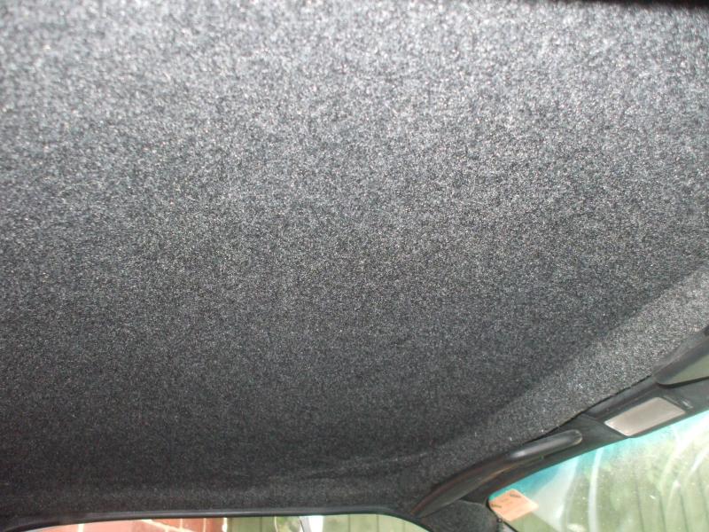

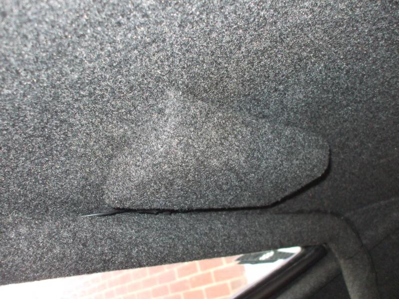

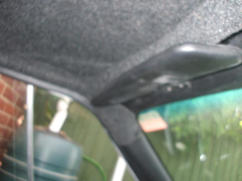

The headlining, roll cage and rear shelf are all covered in van lining type carpet. There's a cover in the headlining over the high level brake light which is from a Citroen Saxo (possibly) and is also covered in the carpet.
the 2 black strips on the parcel shelf are black painted UPVC house window trim used to cover the carpet joins.
The gap between the rear speaker pods is a piece of wood covered with the patterned vinyl I used on the doors. Along the front of it to cover the edge of the carpet is a piece of angle alloy from a suspended ceiling, painted black.

Have you got a pic of the headlining please ? and was it a pig to work around the roll bar assembly ?

I'll take a couple of photos for you.
Fitting is wasn't too bad once I'd fitted the parcel shelf and rear window surround covering with the rear window in place. Now that was a bugger.
The roll bar actually made it easier to fit as it divided the area into sections.
My main mistake was using spray glue. It made fitting it much easier but when the weather got hot it sagged down so it rested on my head. If just added a load more spray glue but know I'll eventually have to do it again properly.

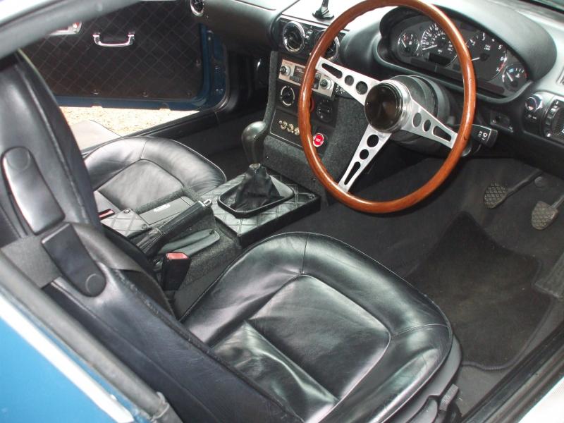

Here's a few pictures.
The tops to the speaker pods I'm making from a piece of alloy.

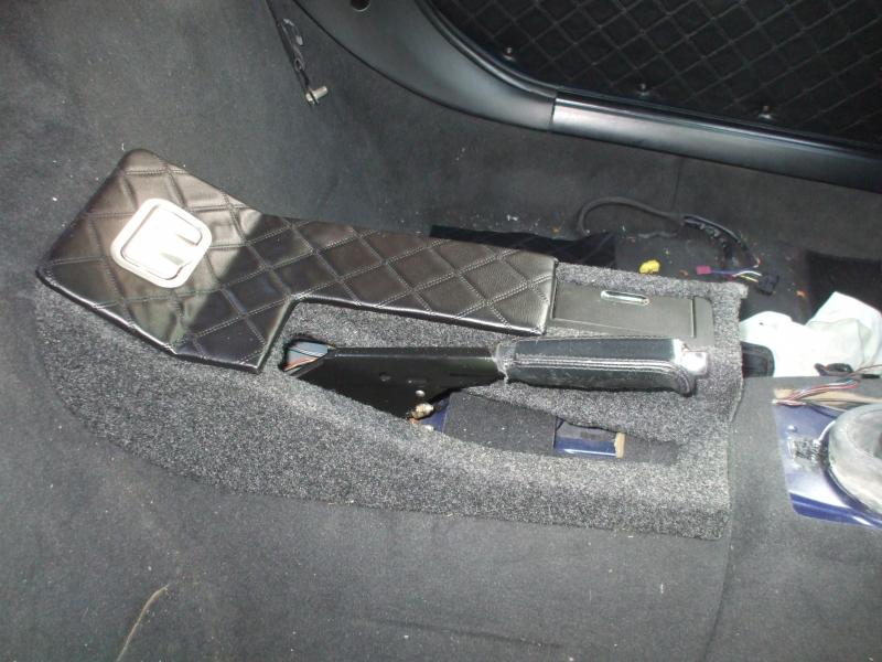

The centre console I've covered this morning
The headlining…
I'm sure a professional trimmer would have made a lovely cloth headliner for it, but I enjoy the fiddling about with interior stuff using what I have lying around or can blag from friends.

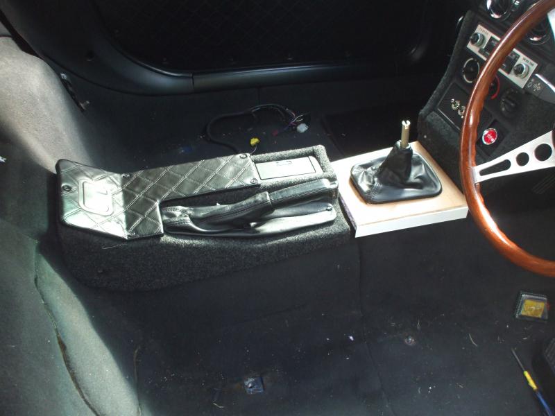

Centre console fitted now. The hazard switch works well in the ashtray with holes cut for wires and depth.

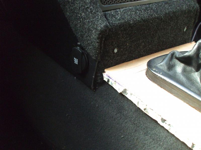

Plug for sat nav etc fitted on the side of the front console. It should be ok as it's not in the way of the gear lever or my legs when anything is plugged in.

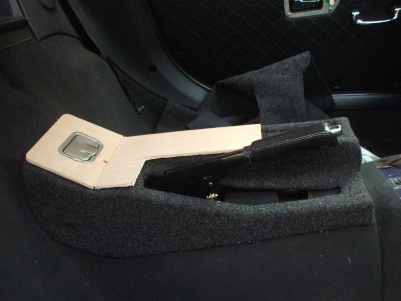

Making the gear lever surround now. A piece of carpet underlay first to build it up, then a plywood plate.
This will have a bit more suspended ceiling angle bonded to the sides. Will finish this tomorrow if time.
I wish the 'designers' of our Fiat Grande Punto has paid attention to such detail - the aux socket is just behind the gear lever gaiter so any time we use the sat nav the wire is constantly it the way :frusty:
