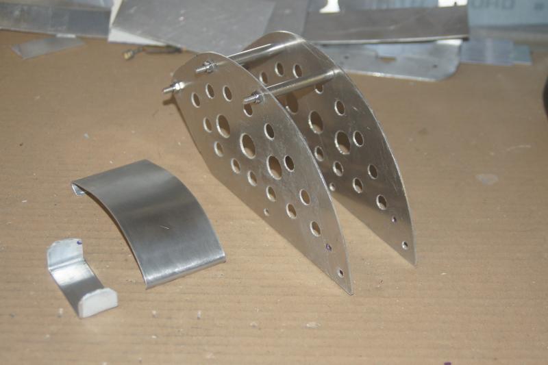

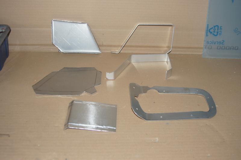

Plan A I failed miserably to make a leather handbrake gaiter it could be something to do with the fact that i am useless on a sewing machine so I decided to try to make one from alloy. Plan B made some templates and cut the alloy.
But I don't like it too big and bulky The whilst reading the thread by Lancelot on vintage handbrakes i thought that looks a lot better I'll see if I can make something similar.
https://www.facebook.com/midcenturye..._post_reaction
Plan C It won't be the who handbrake assembly just a similar looking cover.
So far so good a lot simpler with only two alloy sides and some spacers polish it up and drill some holes for effect :party: hoping to finish it next week end watch this space

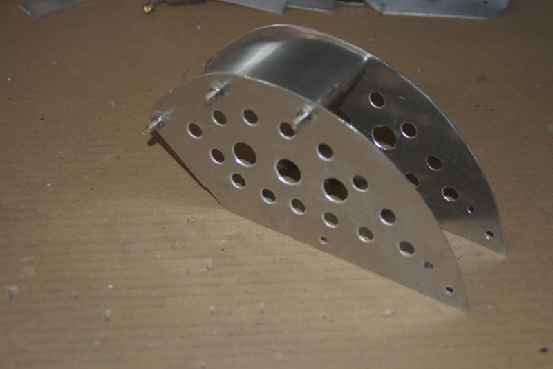

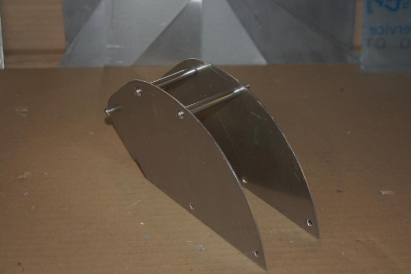

I almost finished the hand brake cover this weekend I clamped the two half's together then marked out and drilled the holes.
I also made a aluminium cover for the top and some brackets.
The cover just clips on I have to decide whether to just leave it polished, drilled and polished or covered with vinyl
I just need to polish it and decide which root to take with the cover?

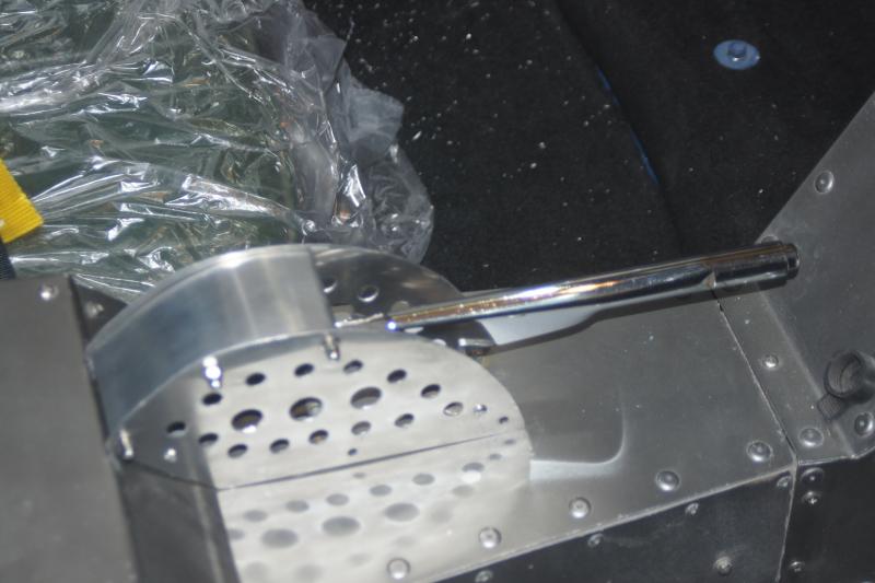

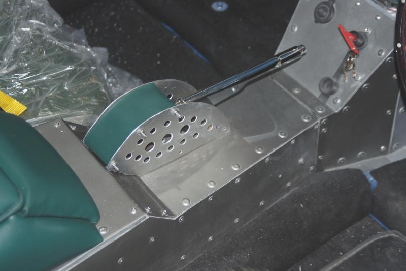

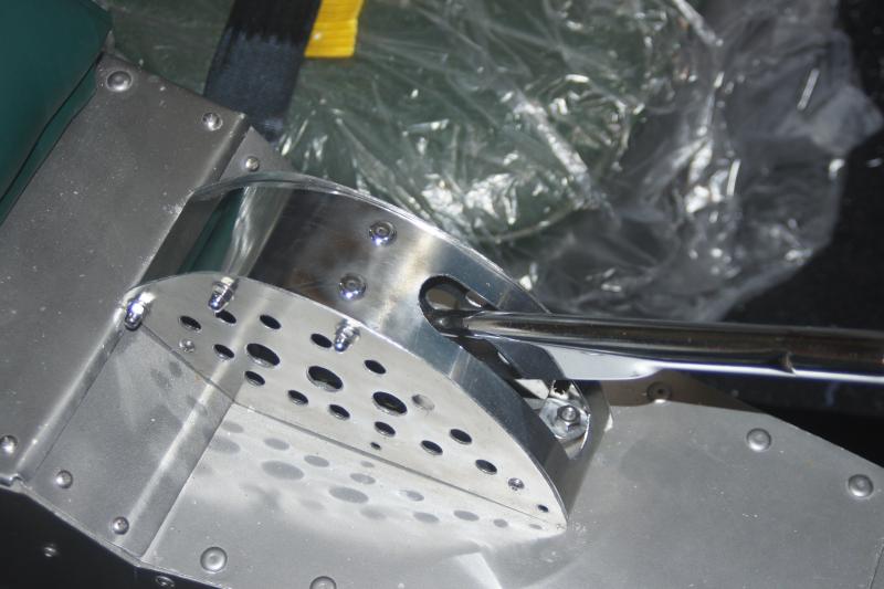

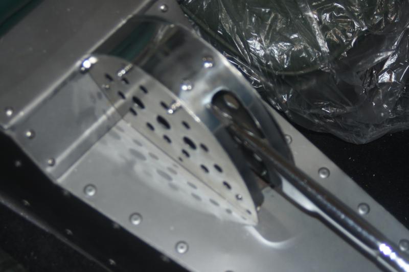

It looks like this polished
Now with or without holes? Hmmmm :drama:
3 Nov 2019, 5:00pm
No holes in the cover for me
4 Nov 2019, 9:17am
Ok gents you persuaded me polished no holed it is.

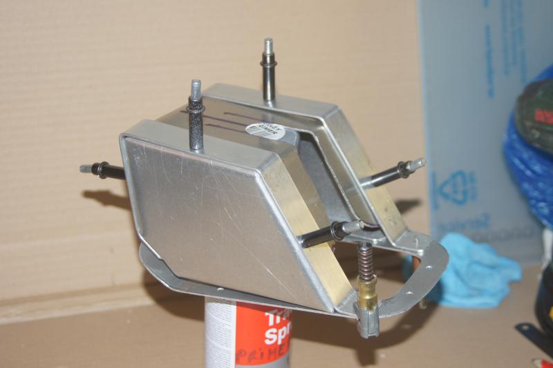

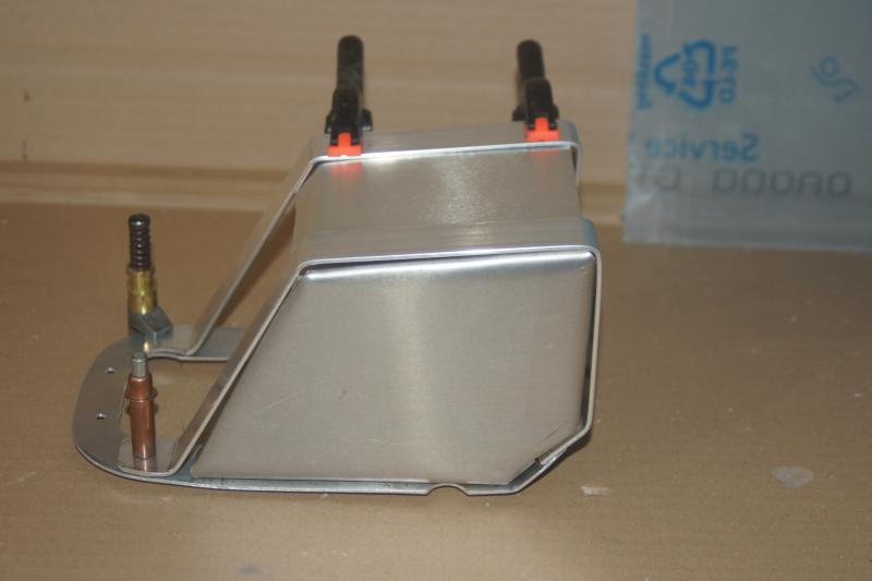

I decided to make a mk2 version of the top cover which looks a little better.
but then decided the open ends at the bottom may vibrate or rattle so I made a mk3 veraion.
so what do u think mk1 or mk3 ???
5 Nov 2019, 9:22pm
Love mk3! A well finished product
6 Nov 2019, 12:10am
MK3 looks super!
6 Nov 2019, 10:23am
tough call.. the mk2 seems a more even fit against the top edge, but the mk3 looks more complete.
do you think it might look good if you added a brush strip (letter-box draught excluder) to the insides, to stop dirt, coins, etc falling into the mech? could be a nice alternative to a gaitor.
6 Nov 2019, 4:56pm
Yep was thinking of that or some edging trim perhaps?
6 Nov 2019, 8:45pm
Mk3 for me too! Looks great a nice touch.
7 Nov 2019, 6:08pm
mk3 it is then, I totally agree good choice.

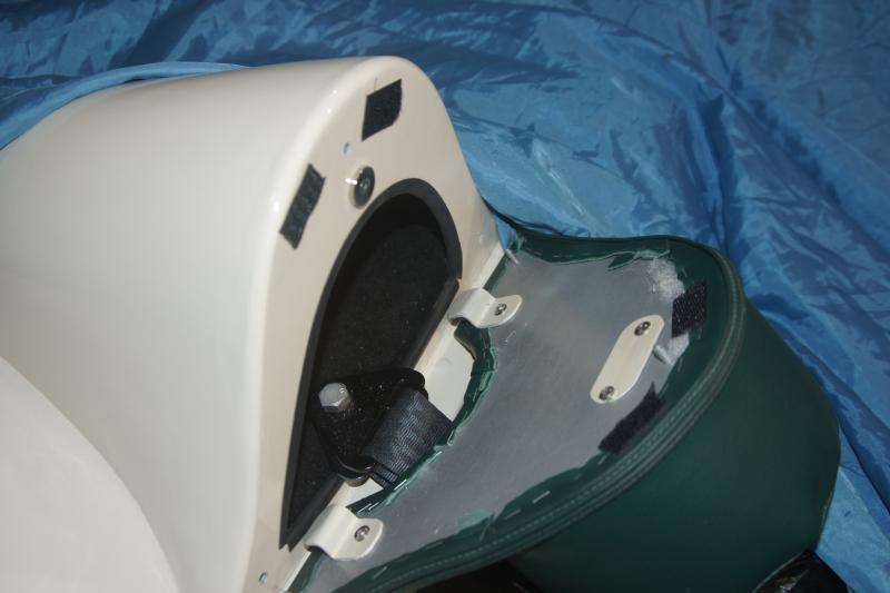

I didn't get much done this weekend I only sorted out the head restraints the Velcro wasn't working very well so I fitted a neodymium magnet which seems to work very well.

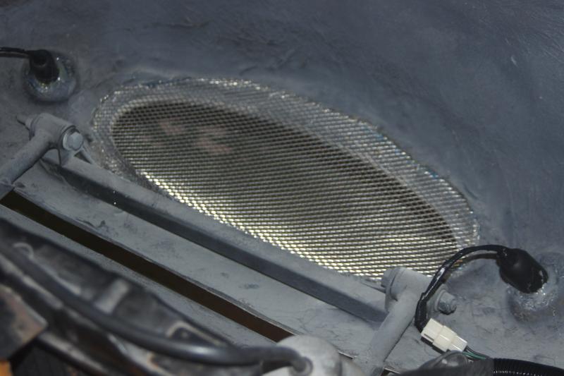

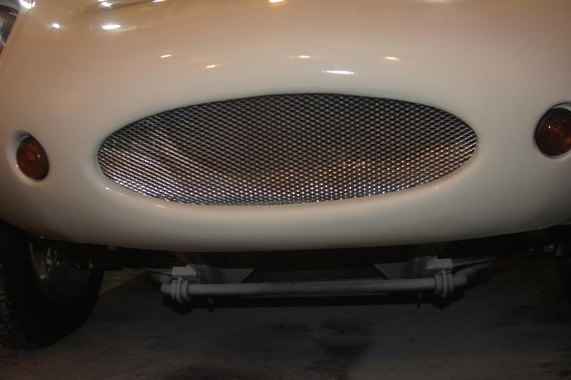

I finally got around to doing a bit more on the car I fitted a mesh grill just cut to shape and glued in with a hot glue gun.

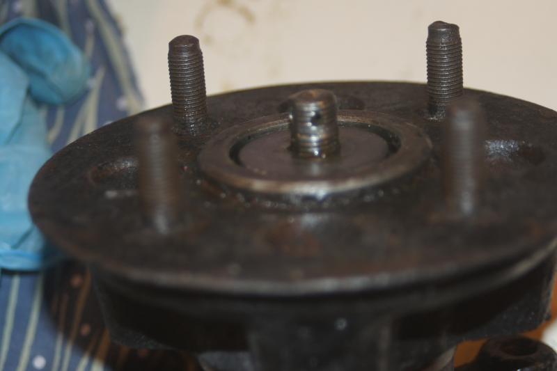

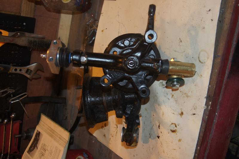

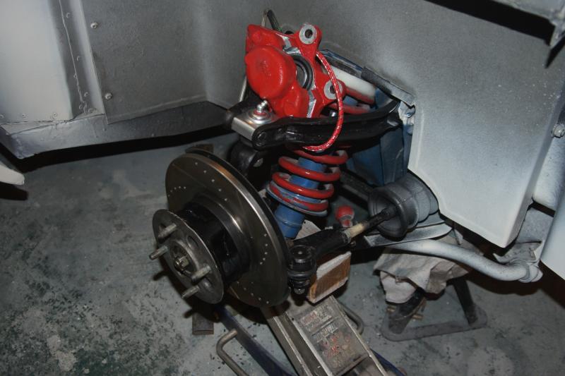

But as usual it was one step forward and three back. whilst trying to bleed the brakes again I noticed that a wheel was loose so I had to check them all the two offside wheels are not tightening up out with the vernier the wire wheel adapters are 2mm longer and the threads are 2mm sorter than the n/s ones s##t i could turn them down a bit but there is no way I could cut the thread (8 tpi left hand thread) so I bit the bullet and sent for a set of new ones $$$$$
then I discovered this.
the threads on the stub axle are shot I don't have accesses to a press so I bought a pair of rebuilt ones.
Almost fully fitted. when the new wire wheel adapters arrive I will have to fit decent wheel spacers instead of the universal ones I have at the moment, lots more $$$ doh.
