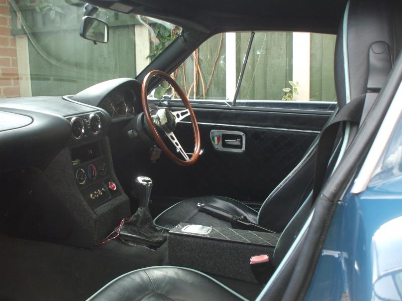

Today I tidied up the front corners of the screen where the cage bolts in.
Fitted the under dash parts.
Moved the air (outside/recirculating) switches to the vacant headlight adjustor space.
Nearly finished the downwards part of the centre console.
As I refit parts they are all given a good clean and polish up. When the console was back in I thought I'd better make sure things worked. The heater fan certainly does as I dumped a tin full of filler dust through the vents and all over everything I'd cleaned. Oh well, better down than on the way out somewhere.

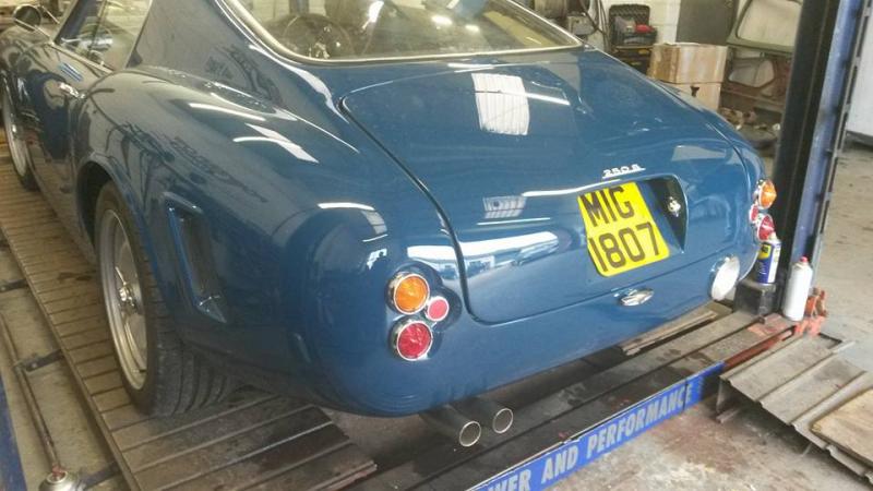

This afternoon I collected the car from good friend Mark at Power and Performance.

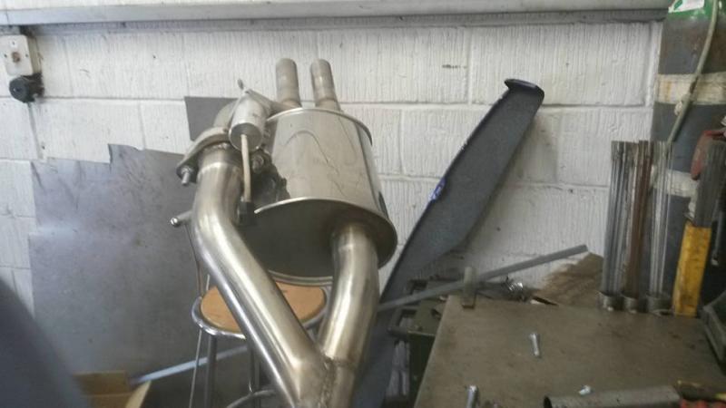

The standard (and very nice) choice for a 250swb exhaust is 2 twin tailpipes but I'm a hot rodder so had to do something different. Mine has stainless twin pipes down one side as the standard Z3 does, but with a difference. Mark fitted a remote control cut out flap so that although the gases exit through the pipe ends, the silencer can be bypassed. I've had some fun with that already.

This afternoon's plans were cancelled so I finished the left door panel and made the right one. The car looks better now they're on.
Tomorrow will be a good clean of the car all round. Especially inside as the filler dust kept blowing through the vents. I'd better put the passenger seat in as well as a mate is coming with me to Stoneleigh.
Any spare time and I'll start on the centre tunnel. Not sure what to do yet but I may adapt the original console where it's between the seats and use some diamond vinyl around the gear lever, with an MGB surround I have. Or not.

Bob - Your exhaust's silencer "bypass" looks like a very trick piece of kit. :cool:
I think your rear set up looks good, with the twin pipes on one side and the big reversing light on the other.
Enjoy the show, your car is a great example of how many improvements can be made in the space of 12 months.
Take care, Paul. :)

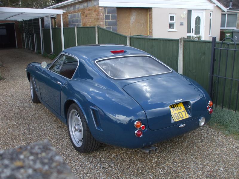

30 Apr 2016, 7:05pm
This is where the car is up to. Lots more bits to do but I'm out of time for a while now.
30 Apr 2016, 7:13pm
Looking great! Really like your choice of wheels.
30 Apr 2016, 7:26pm
Bob - thanks for pm
30 Apr 2016, 7:51pm
Very nice :thumb: love the colour and wheel combination and the interior is looking good too.
30 Apr 2016, 8:06pm
I've got to echo JG, above. This looks spot-on! Will have to keep it in mind when I have the drophead.

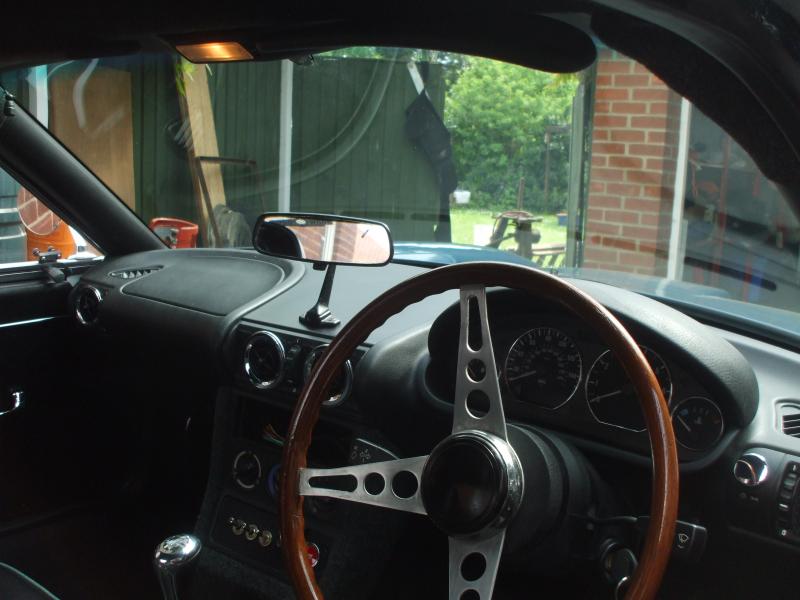

Hi guys, Last week I thought I'd fit a dash mounted interior mirror. All went well and a roof one I had, turned round, did the job fine and kept the dipping facility.
When it came to removing the old one it didn't go so well. I didn't know it twisted off the base so I ended up with a mirror in my hand with the inside of the screen fixed to it!
I'd been wondering what to do about the screen earlier as it had some scratches from a sander on it. This made my mind up.
I've just had a new top tint screen fitted. It comes with the mirror based already bonded on but I can get round that.
Next on the list is a rubber and trim stuck on to add some age and silver paint on the wipers.

Morning Bob i was looking at the same interior position for the rear view mirror (it does give a better view out of the rear window) but that dash position meant i could no longer see out of my wing mounted nearside mirror! Geoff .

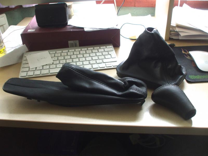

Hope to get a few bits done on the car next week. Picked up these from my fairly local Z3 breaker. My original interior was beige with a horrid M type gear knob. These will be much better.
If you need any Z3 parts Les is in North Norfolk and can be reached on [email]yamsel1@aol.com[/email] It's not his main business so give him time to get back to you.
