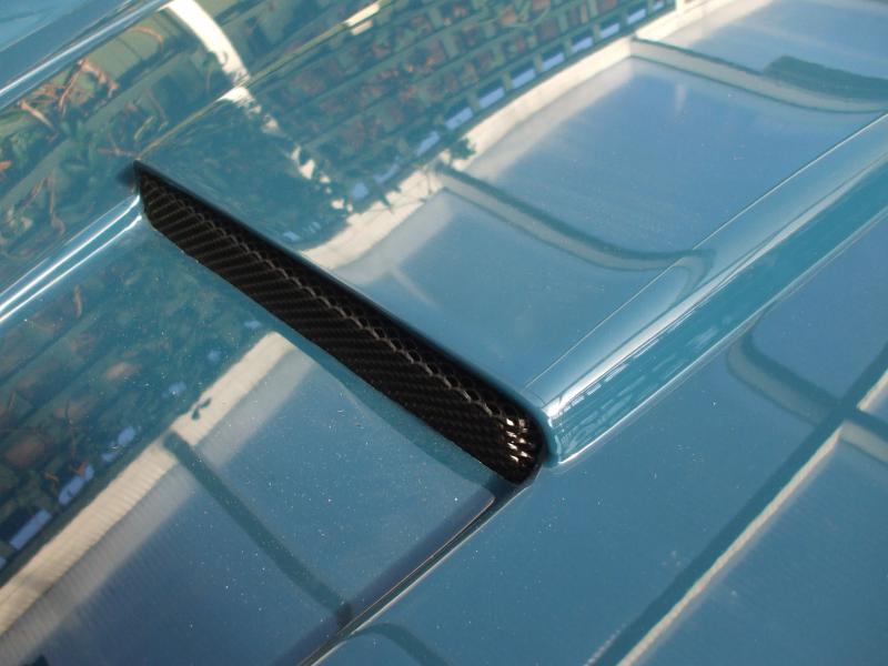

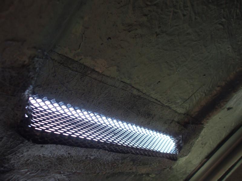

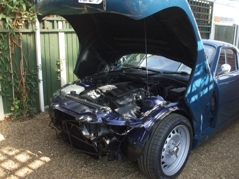

Here's a couple of pictures of the bonnet mesh for you. Also one with the bonnet up to show that I'm not much into fancy paint and chrome under there as I tend to leave it closed at events.

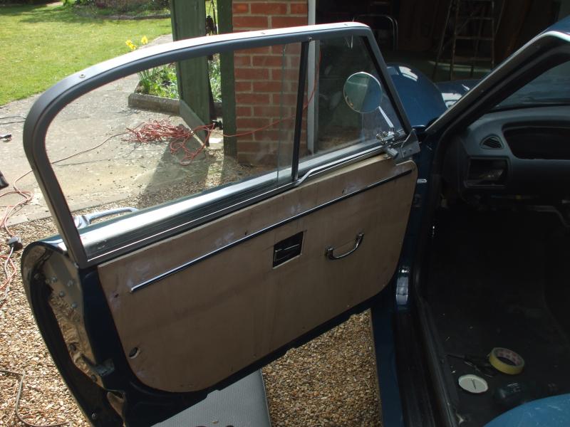

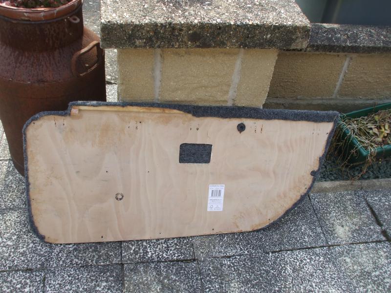

Made the wooden bases for the door panels. The top doesn't line up from the door to the window frame as it got nearer the front so I made a wooden spacer which is fitted to the back.
The van lining material is just the padding as I had plenty but didn't have any foam. Diamond pattern vinyl I bought a while ago will go on later. The handles are auto jumble stock and the chrome strip is from a scrap XJS Jaguar door trim.

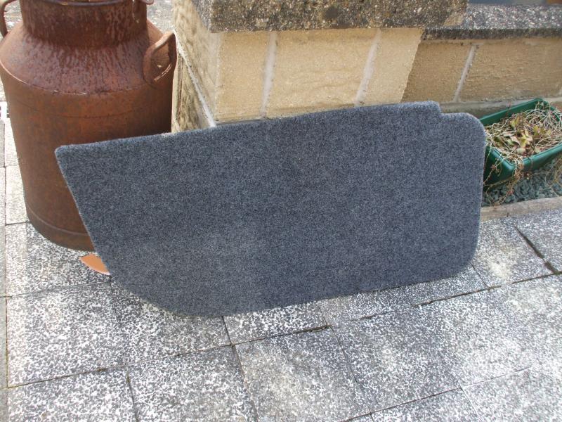

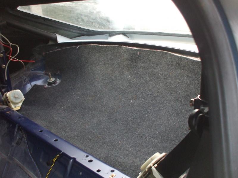

I've also started on the rear parcel shelf. It's a boot carpet from something or other. It's thick so is being used a a base to cover the many lumps and bumps in a Z3.
As usual, lots of started jobs. If they go well and I reach a good point to stop, I do something else. That way I always look forward to getting back out there again. Odd way of doing things perhaps, but it works for me.

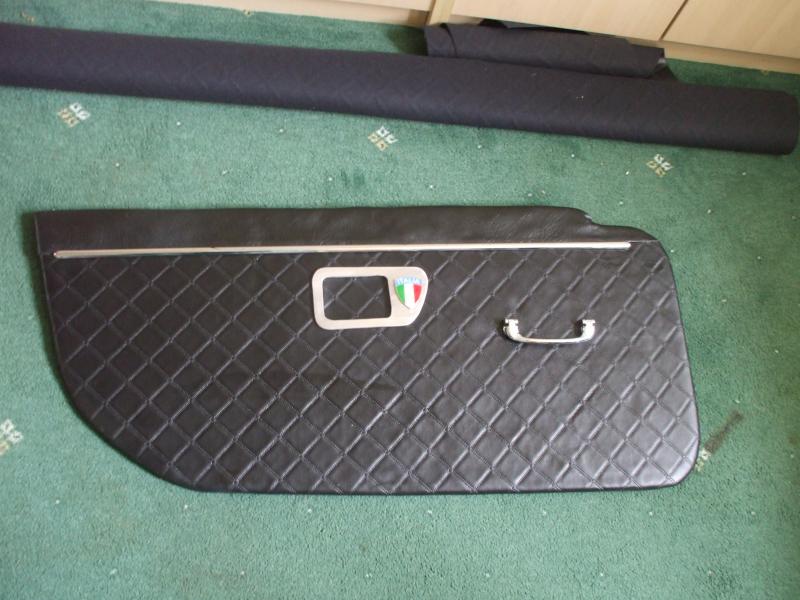

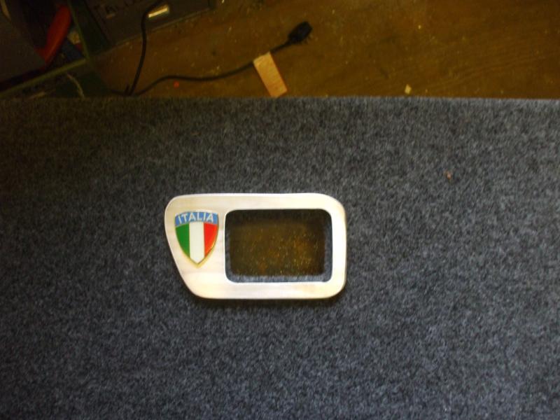

I had a little time today so decided to make surrounds for the inner door handles. A cut out some scrap alloy plate and thought I'd add the badges as there's only one Italia badge on the grille, so not too much to spoil the simple appearance.
Just need to drill some mounting holes for the plate and vinyl the door trims and it's another job ticked off.

I spent some time on the first door trim. It's not far off finished now.
Very impressed with that paint close up
7 Apr 2016, 5:11pm
Thanks Smash, I'm very pleased.
