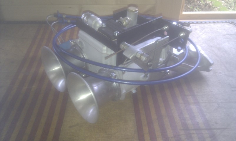

3 Jul 2014, 3:57pm
I love it when the postman makes today Christmas Day.
3 Jul 2014, 4:20pm
Nice trumpets.
3 Jul 2014, 5:01pm
Wow! That looks awesome Ox!
I bet it will sound great too.
Reference your rad being low (like mine), you will either have to do something like I did, (cheap simple route) or go for it, if you have the room, and fit a header tank.
If you look on my thread, you will see Dave put a really good picture of what is probably the best idea for a Triumph.
I'm sure, like me, you have so much to do, but it will have to be addressed sooner or later!
3 Jul 2014, 5:24pm
They will look and sound fantastic on the car, i wish i could stretch to the cost for my straight six but for now i will have to do with the strombergs.
