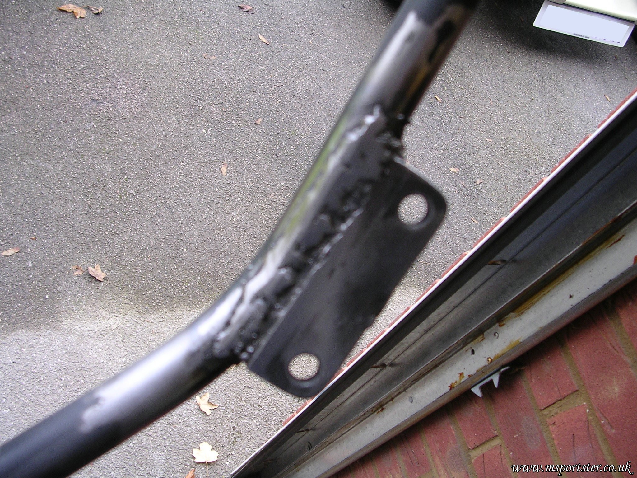

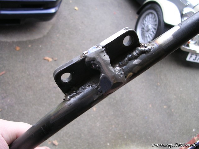

It would be good to get some pictures posted up of the old and new style brackets and whatever folk have done to beef them up.
Robin
18 Nov 2007, 8:49pm
Robin
I collected mine in March this year.
Picture here............
http://www.flickr.com/photo_zoom.gne?id=432631171&context=set-72157600024149736&size=o
I'm pretty sure they are made from solid bar.
http://www.flickr.com/photo_zoom.gne?id=1347352365&context=set-72157601913959964&size=o
I'd be interested to see where they fracture as I don't fancy the thing comming off at the SVA!

19 Nov 2007, 12:48pm
I've not gotten around to photographing it yet, but will post all the pics as soon as I've done that.
19 Nov 2007, 1:12pm
Suspect I have the hollow tube version - I will take a look tonight and post some pictures. i think I will drop a "fishing" email to Marlin and see what they say....
Robin

19 Nov 2007, 9:39pm
Mine look exactly the same but they seem to be to light to be made of solid bar.
One difference is that the welds have all been neatly ground down on mine - which could make them weaker. It would be good to see a picture of where Patrick's failed....

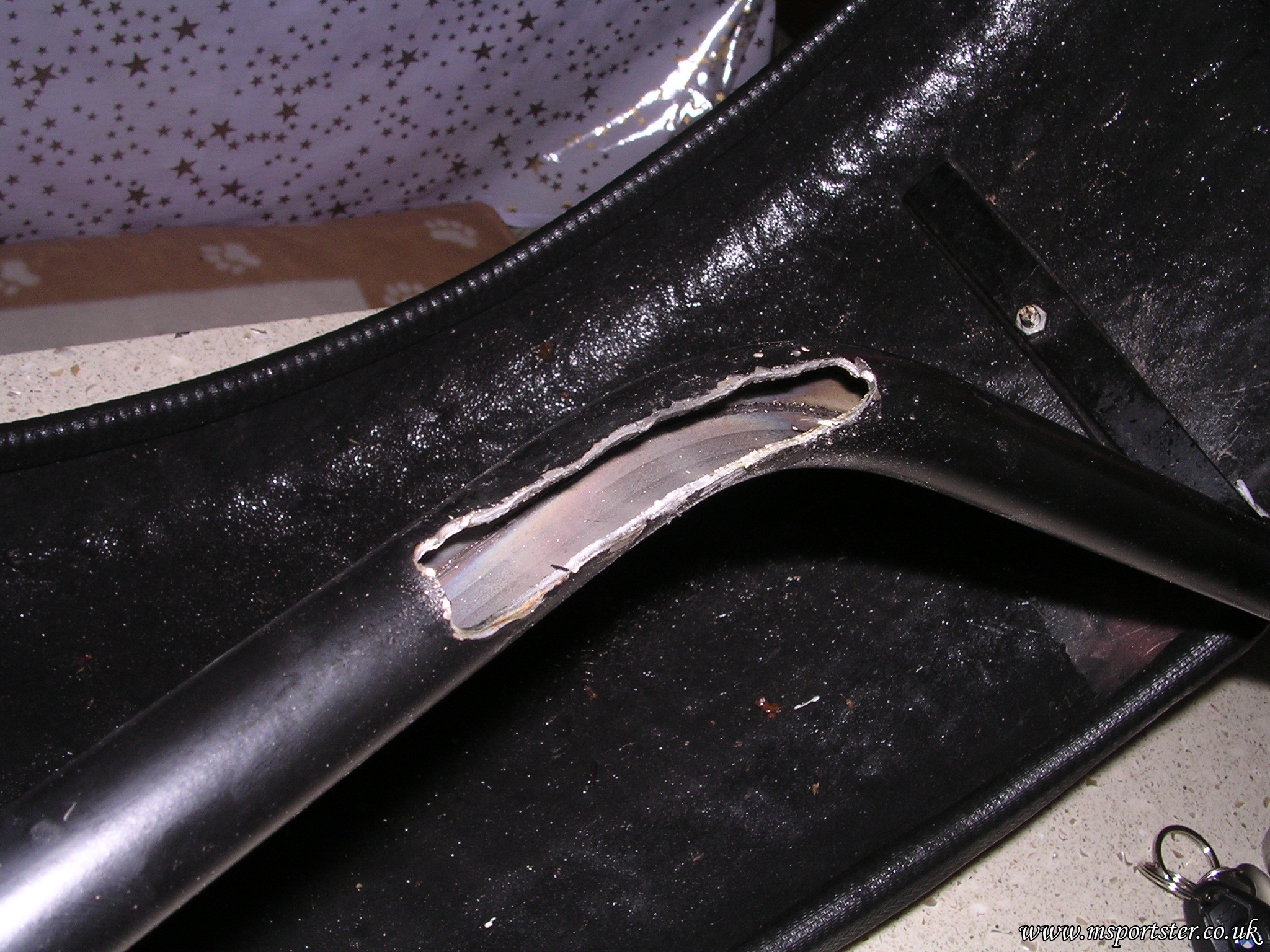

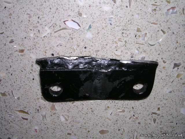

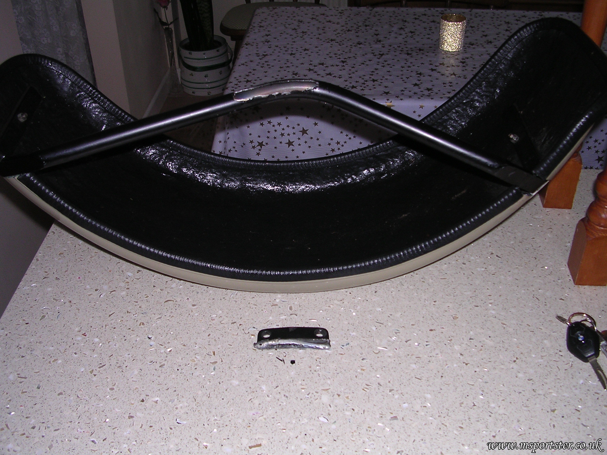

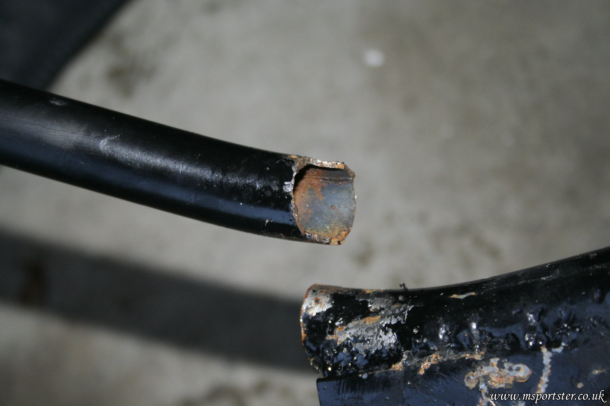

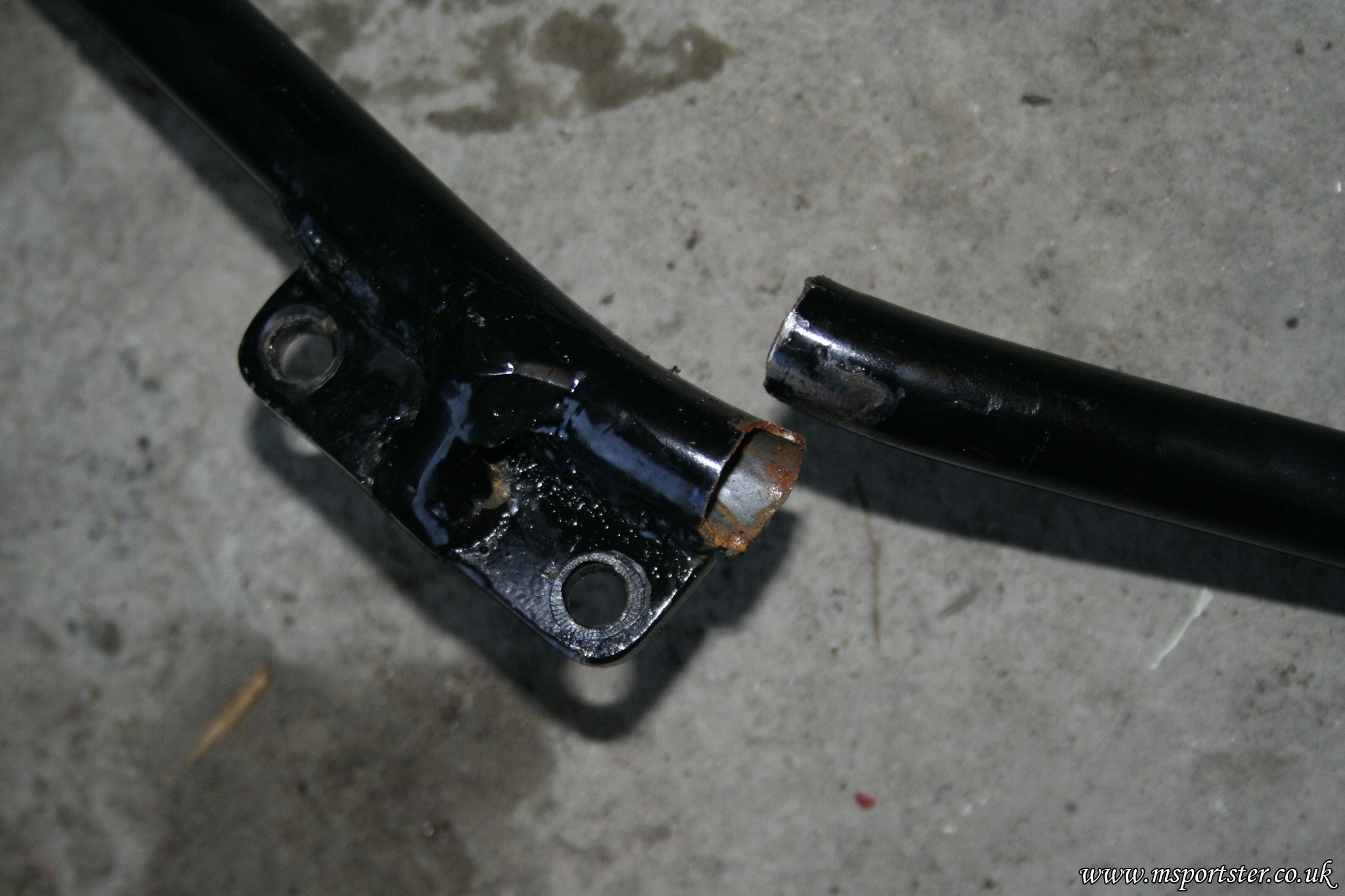

20 Nov 2007, 7:19pm

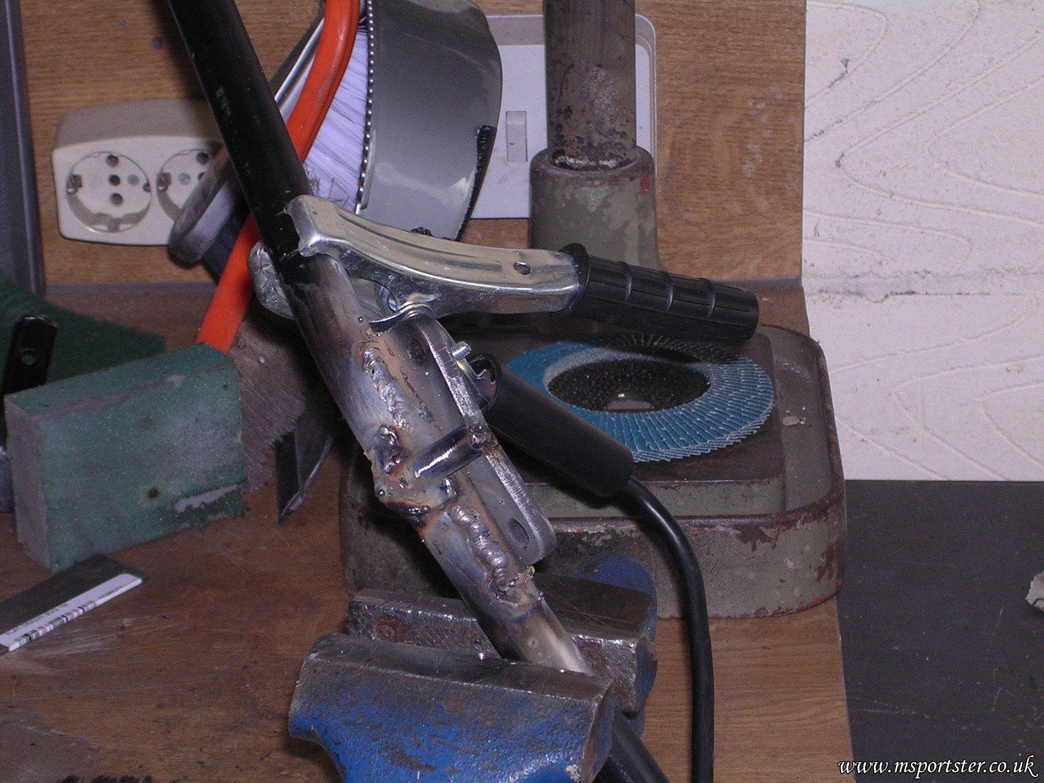

Sorry for the delay here are the pictures:
20 Nov 2007, 9:28pm
Wow, that's a dramatic clean break!
You were lucky you didn't loose it at speed.
I think a call to the West Country is in order. Shouldn't be any debate with a photo like that!

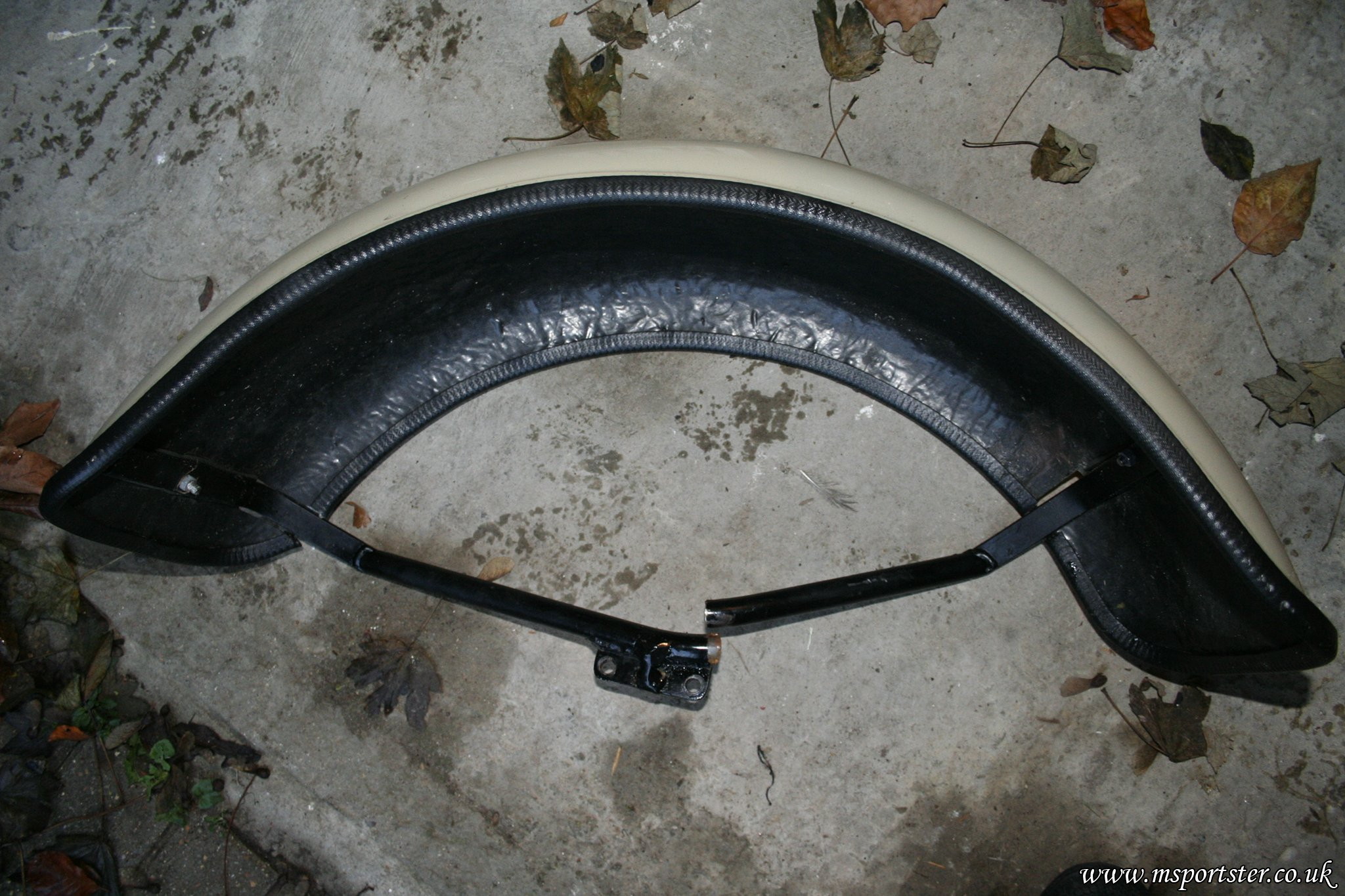

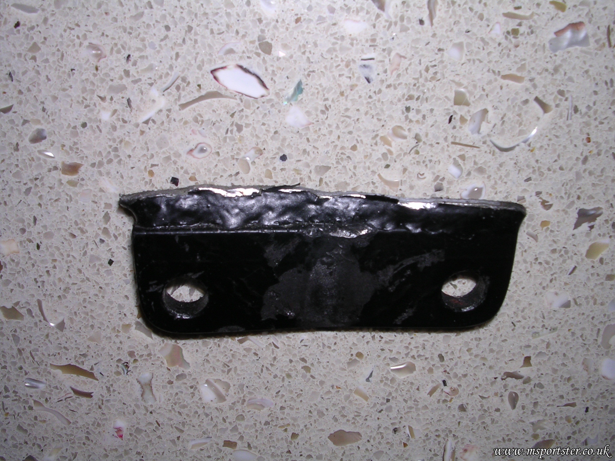

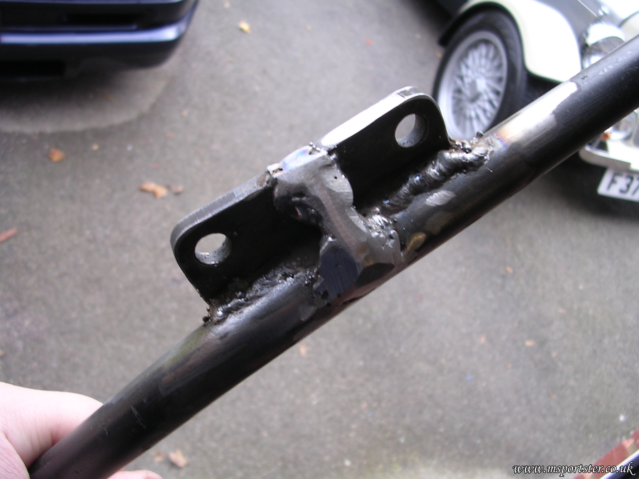

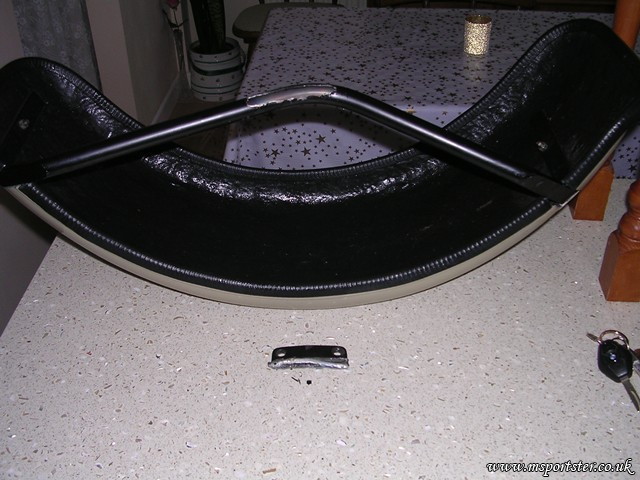

Here's the rest of the pictures form the second time it broke:
21 Nov 2007, 8:39am
Thanks Patrick. When I looked at the design I thought that the failure might occur at that point. Have you asked Marlin for replacements yet? It will be interesting to see what they say...

Patched it up again, welded some of that steel you can get at B&Q all the way along the pipe. It's thicker than than the metal of the pipe. Its now very heavy but will do until I get the new ones.

The driver side wing bracket is start to show signs of failing as well now. There was a stream of rusty water flowing out of it the other day while I was out. A nice big crack forming at the front top. Welded that for now so hopefully that will hold until Marlin send me the new ones.

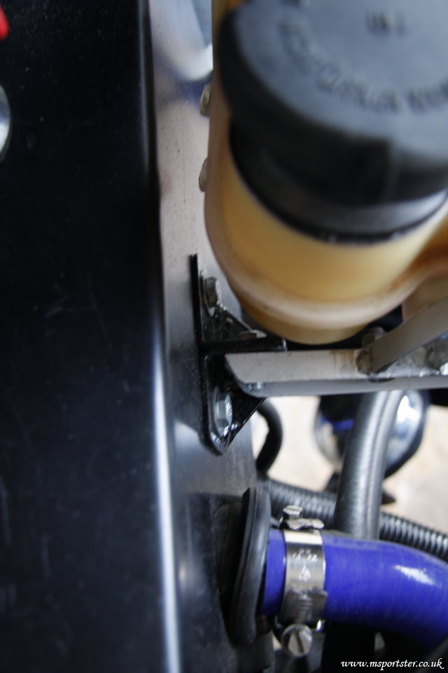

21 Mar 2008, 8:38pm
Finally bit of construction. The original bracket that held the header tank was a bit floppy so Richard welded up a new one - nice and solid now!
