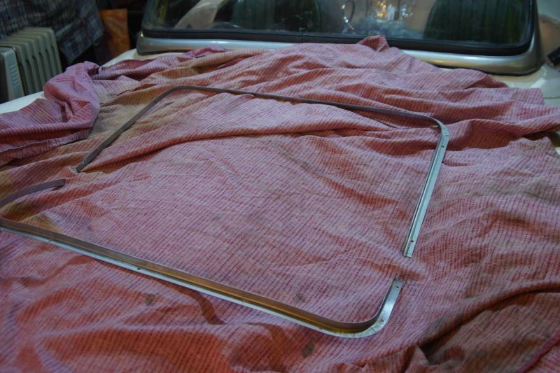

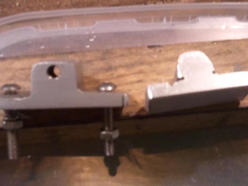

Unfortunately standing in a damp garage for the last 10 months hasn't helped things. The brakes are binding badly and some of the electrics have stopped working so i decided as I will have to strip the front suspension down again I will upgrade at the same time to that end I have bought drilled and grooved front disks and EBC pads also bought a pair of nice shiny s/s top suspension mounts. I also want to change the wheel spacers as the ones I have are 30mm universal ones so I;m looking for a set of dedicated ones. on the up side I finally managed to get the correct rubber for the windscreen (only took me a year to find it) so I've started work on the screen frame again, and i have made the upper mount for the rear view mirror first attempt failed as you can see second attempt not so bad but there may be a third?

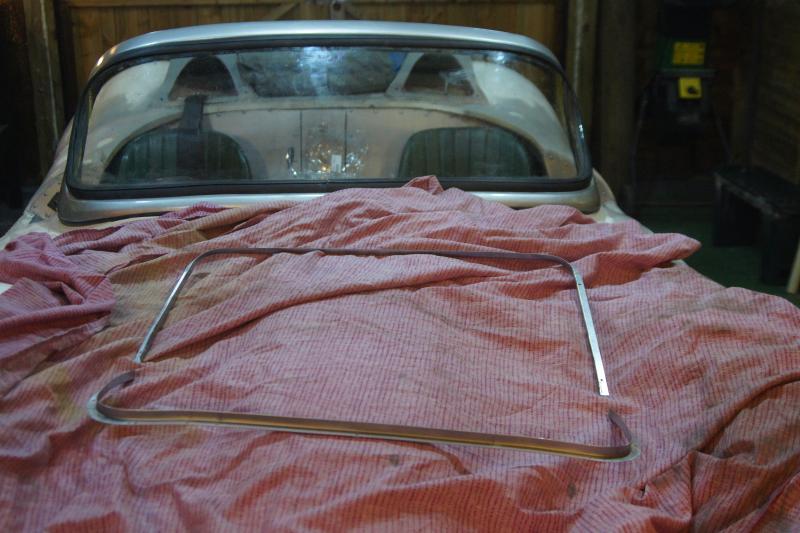

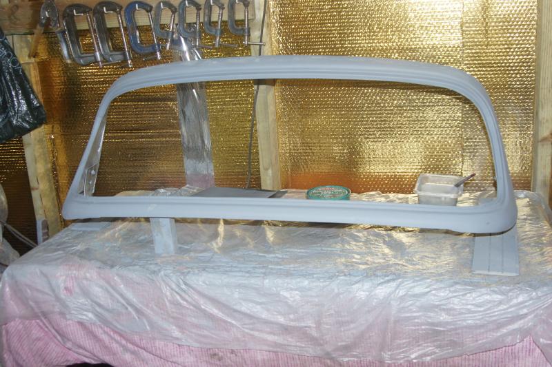

Re started work on the screen frame the chrome paint I used reacted with the primer and went soft I had to use paint stripper to get it of it's now back in etch primer.

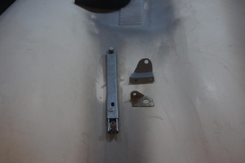

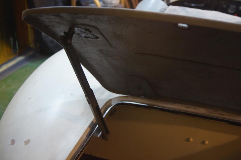

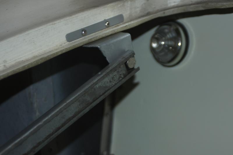

I'v also made some brackets for the boot stay.

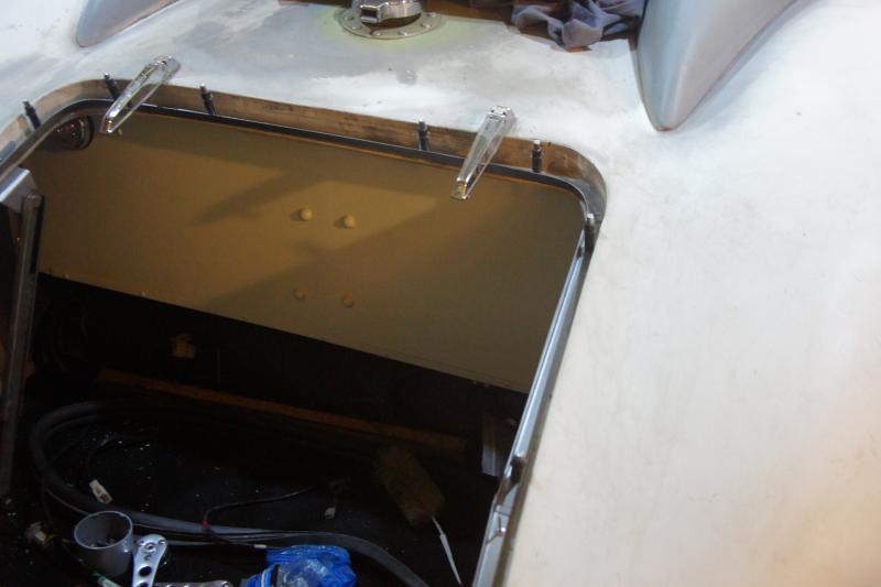

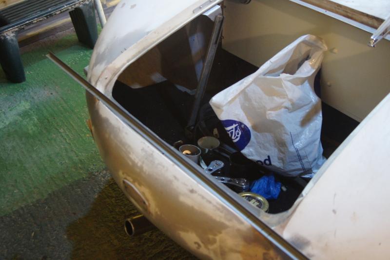

Yesterday I borrowed my friends metal shrinking/stretching machine to make a lip for the boot aperture.
before.
After
Not too bad its now ready to be bonded and riveted when my new riveter arrives my old air one died a few weeks ago so iv'e sent for a standard hand one.
I also sprayed the screen frame and fitted the screen it was a very right fit due to some distortion during welding as usual I messed up and managed to mark the frame so it will need some flatting back and spraying again :mmph:

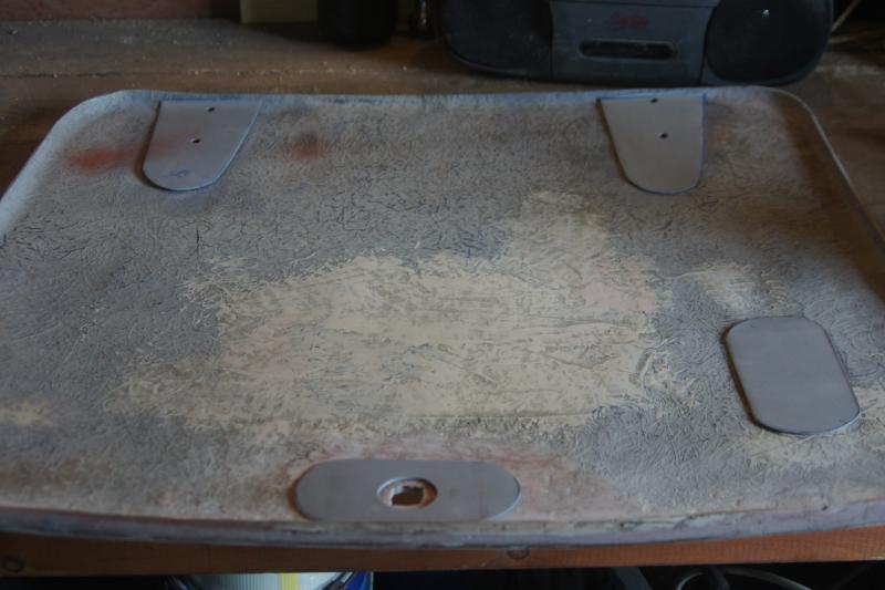

I finished the boot stay this week the load spreading plates and the bracket are simply bonded on with Tiger seal.

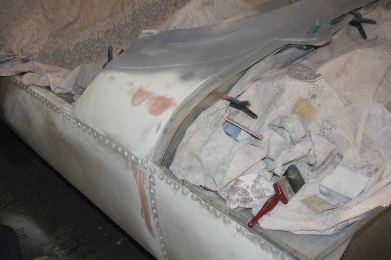

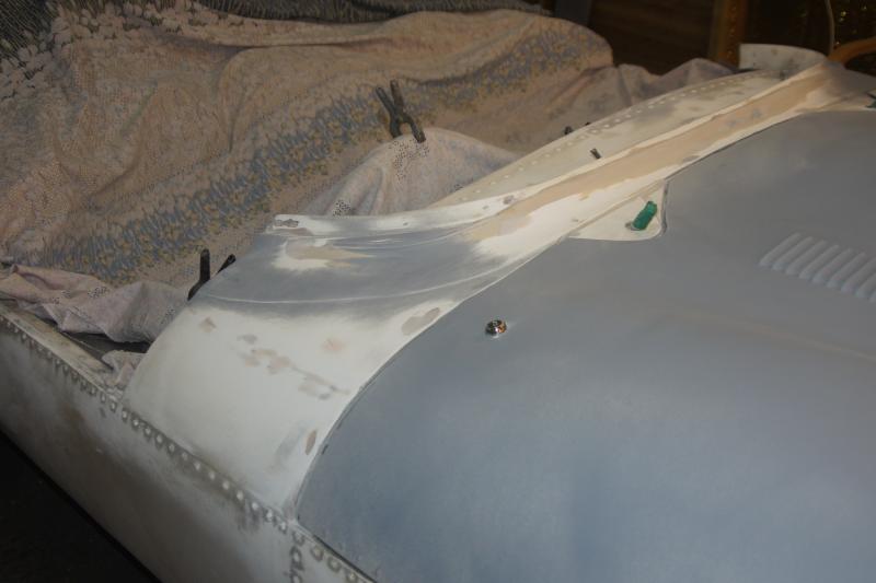

The one inside the boot is bolted. It all seems to work OK I wanted a nice smooth boot lid of course I'v taken it all apart again now to flat it down and etch prime it also working on the doors which are a bit of a pig I keep finding voids on the edges :icon_frown:

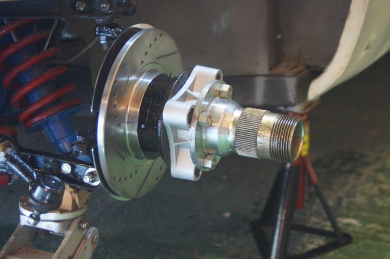

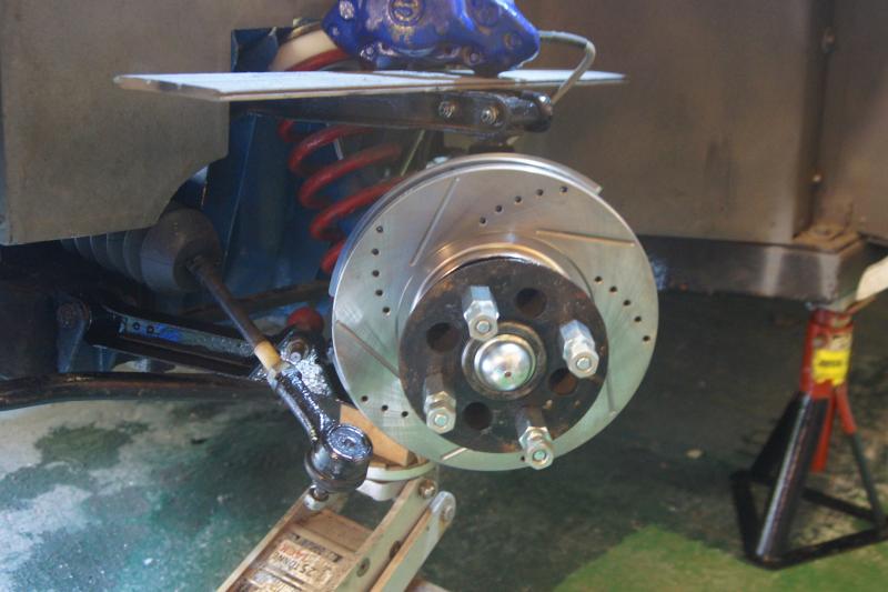

well yet again I got fed up with filling in and flatting back so i decided to have a go at the seized brakes:juggle: after trying for a whole day to free up the calipers i gave in and ordered some new ones. I fitted the nice new disks crass drilled and vented, I didn't realize until I fitted the first one to the hub that these things are handed.
The outward side of the grove points towards the rear of the car.

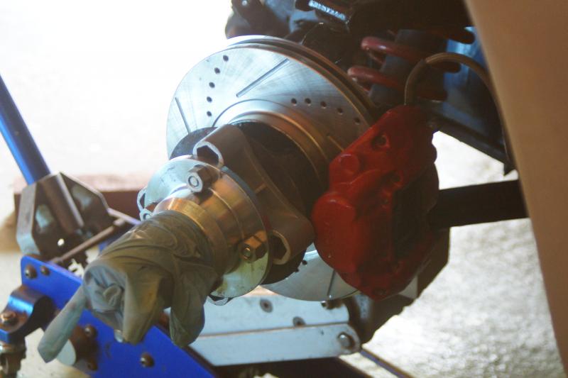

I have fitted the new calipers and ETB brake pads but haven't bled them yet (I need to rope in the wife for that)

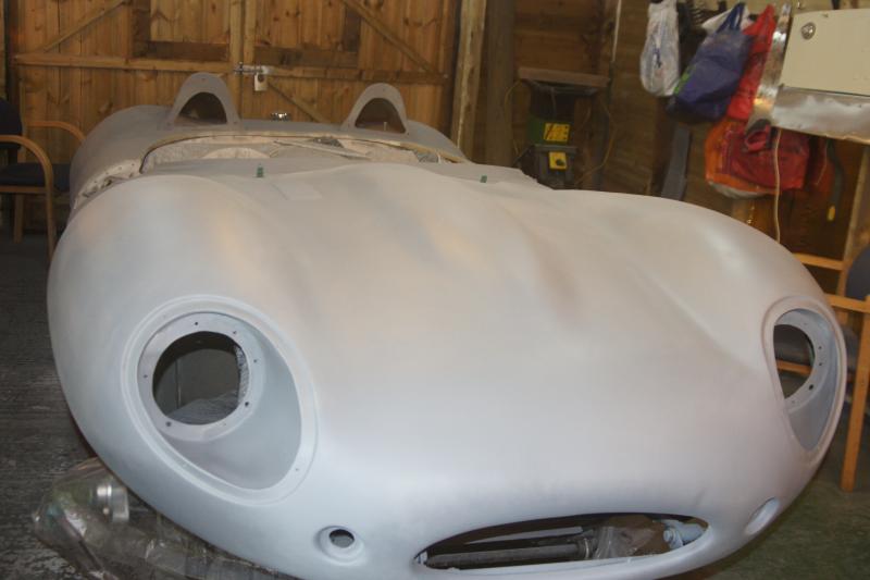

And managed to do some more flatting down:target: and managed to get some etch primer on the bonnet.
Though knowing this car I'll probably have to rub it all down again:pray2:

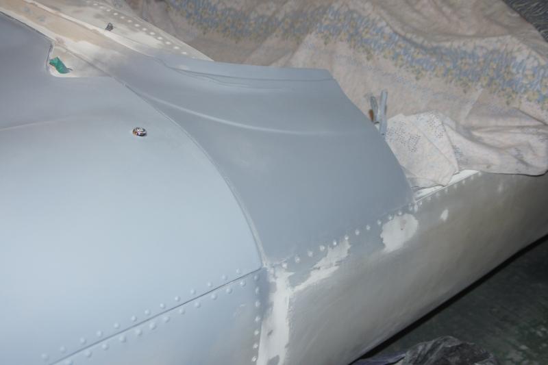

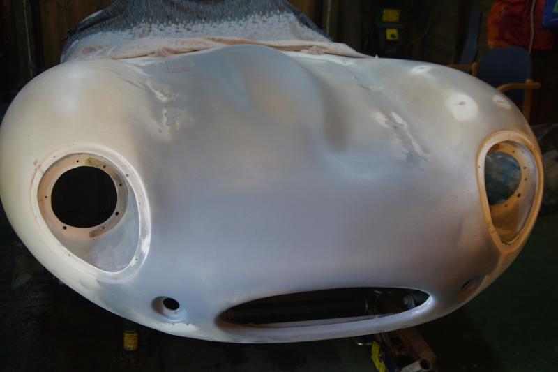

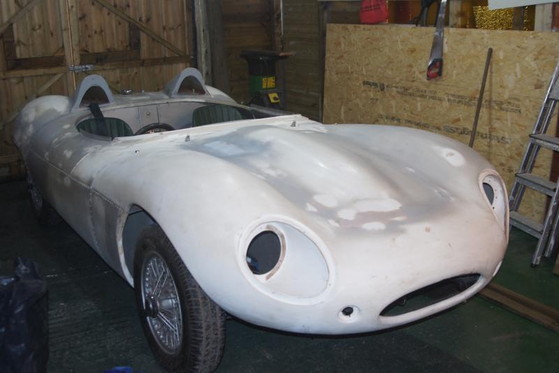

As fast as I flat one bit of bodywork I find another that needs filling and flatting I think they are breeding :preggers:

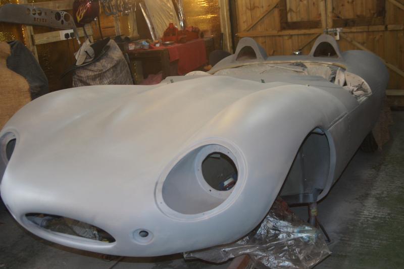

It took me a week to finally get the whole car covered in a coat of etch paint from rattle cans
Unfortunately a friend who was going to spray the car for me may now not be able to so I now have to chose, find another (cheap) sprayer or invest the money I was going to spend on a decent compressor and spray gun and spray it myself something I have never done before Hmmmm :help:

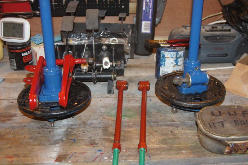

rear driveshafts

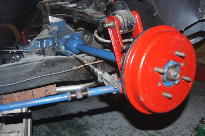

I am back on the mechanical bits this week I am fitting the longer driveshafts from a spitfire 1500 they are about 20 mm longer than than the herald ones I replaced the wheel bearings and trunnion bushes I also had to fit the smaller driveshaft flanges for the herald diff new universal joints were fitted at the same time.
I had one small hiccup I bought a pair of adjustable radius arms off a Vitesse as the herald ones were now too short only when I went to fit them did I realize the bushes are larger :faint: so dismantle it all and start again I had to spread the brackets wider to accept the wider bush and then drill through to accept the larger bolt. If you do it the other way around the bolt holes wont line up :icon_redface:
All done now but i will have to get the rear wheels tracking sorted when it's on the road and the front ass well of course. Ho I have to make some extension plates for the handbrake cables as they are now too short.
Until next time cheers

Paul Yes it most certainly is I Fitted the hand brake extension plates today and bled the brakes again the car is back down on it's wheels now and the longer drive shafts make the wheels fill the rear arches a lot better.

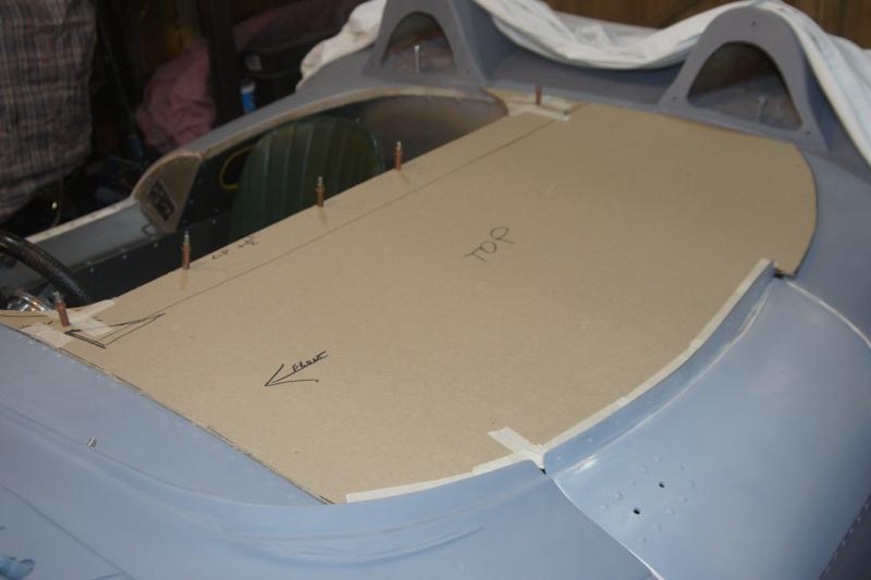

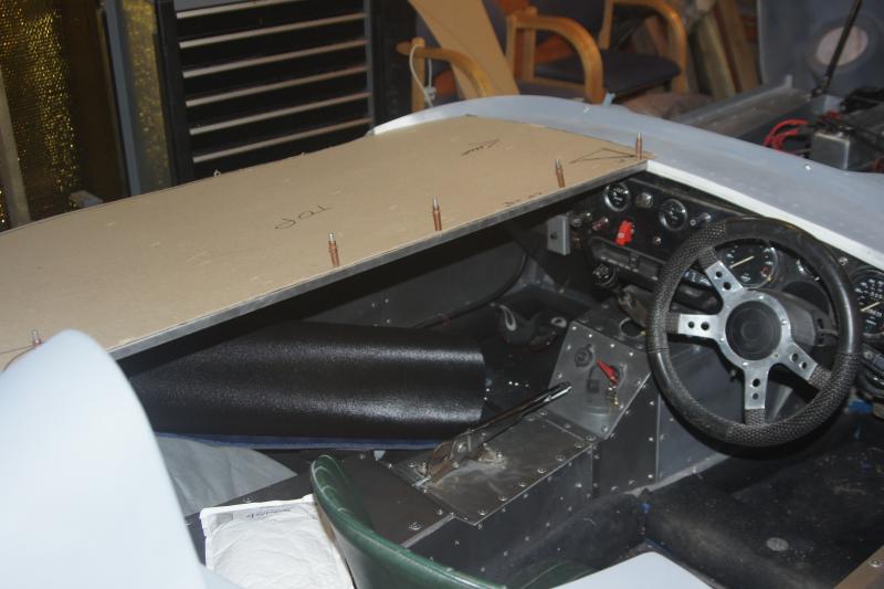

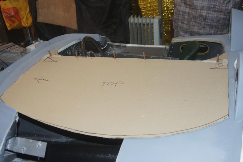

Hi All whilst waiting for the paint job I decided to follow Paul's lead and do some paneling namely a hard half tonneau cover if that's what its called?
I started off with a very thick piece of cardboard.
cut it to approximately the shape I wanted then fixed a piece of 15mm x 15mm mild steel folded angle as the center support
and I must admit it looks ok so far? now I have to get some more angle for the curved supports for which I will need to borrow the metal shrink / stretchy thingy again and I'll pick up a sheet of aluminium some time next week :dizzy:
Then I can look forward to installing hundreds of pop rivets :yuck:
