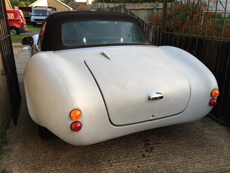

It's not too bad but of course there's no manual so I rang Dave and got sent a picture of the rear light board minus the lens with labels of what each bulb is.
If you plug in the rear lights again you'll soon work out which bulb does what and then just snip that cable close to the bulb, join it with some more cable and run it to the new position. You'll need a ground wire to patch into each light too but you can run one ground cable to the light cluster and then run multiple joins off it to each individual light.

Have a look at this which should help. Every light will have its own colour plus a ground (usually brown but it's black in the z3 lighting pod). You must extend each cable to the new lights plus a ground cable but as long as the black ground is run to each light (in series) it'll make it work.
You must have both rear sockets plugged in as there's a loop in the right hand which feeds the brake light on the left.
There are only side light and brake light at the rear. I'm adding low under mounted fog light and no reversing light. Fitting reversing sensors instead! :)

Thanks again!! So it's as simple as chopping wires adding extentions to new and adding an additional ground ���� So am I not right in thinking that on most cobras there is and indicator light top, underneath that is dual side and brake light ?? then the dredded must have of a fog like like u say should be hiden away at the bottem��
30 Aug 2014, 10:25pm
That sounds right. Indicator, side/brake light and then separate fog and that's you sorted.

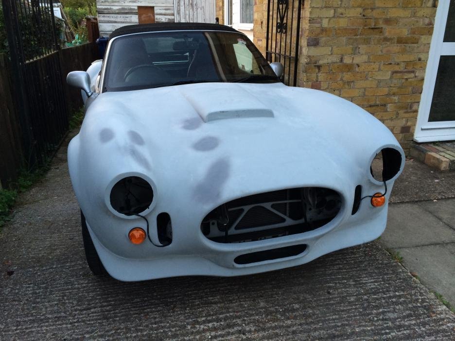

Front is more of the same. Plug in the bulbs again. Work out which is dip and full beam and then extend to new lights (which is a bit more awkward as you have to go back to the bonnet hinge and forwards again up the bonnet to the new lights. I patched into the main loom just back from the left hand lights to save running cable from the right hand and across the front before running backwards. If I recall correctly the right hand fronts were blue/white and blue/yellow.

Sorry for all the the questions but is there a way to incorporate the brake and side lights into the one light I bought land rover lights which has the one bulb... Is it a case of wiring the to wore to the same bulb? :-s
31 Aug 2014, 1:32pm
Your brake/side light - the bulb should be a double filament bulb so you'll have two wires plus a ground connection to make to it. There should be separate connectors on the bulb for all three wires.
And wire it so that the brighter filament (usually 21w) is the brake light. The dimmer filament (usually 5 or 6w) is the side light.

how are you guys getting on?? id love to see some pictures?
15 Sep 2014, 7:49pm
Very Impressive !! What did you use for your side vents?? And ne idea if it's legal to not have the side indicator??
15 Sep 2014, 8:21pm
Side vents came from an eBay seller of Dax cobra parts. Search for cobra side vents and it should turn up something hopefully. Not cheap though at about 90 quid.
I have a side indicator there. I think it is a requirement but not 100% sure.
