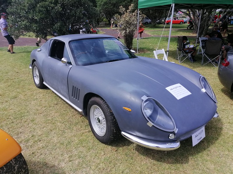

1 Mar 2020, 3:14am
Auckland Brit and Euro Car Show
Well guys I have completed my first car show. Had to trailer the car there and mock up some of the ideas for the finished article but had a great day.
Plenty of positive enthusiasm, comments and admiring thoughts from the the throng of people piling past. Spent all day talking about the project so didn't get much time to check out the other cars really, but there were 1100 there.... Was placed in between Aston Martin and Lotus. Highlight for me was the Chairman of the Ferrari Owners Club NZ coming over for a 10 min chat and how cool he thought the project was!
My favourite the Alpine rally spec original, (well after mine of course!)
Here's some pics.

1 Mar 2020, 10:07am
Well done getting the car to the show !
Looks great and not too far from completion.
1 Mar 2020, 7:46pm
Looking very good. I bet there were a few like that guy in the last picture scratching their chins wondering what it is!

Thanks LLM, certainly was some “tonic for the soul” seeing others reactions etc. Gave me a shot in the arm that I am heading in the right direction, no matter how long it takes!
Also got a contact with someone who has a set of Borrani wheels in his garage so he is sending me some info etc. Good show and good talking about it.....cheers.
2 Mar 2020, 3:33am
Thanks fella, yeh a few foxed people as per the underpinnings....funnily enough it was the younger crowd who spotted BMW gauges the quickest!
The good thing was a lot commented that the proportions just looked right, which is testament to Chris and Dan back in the shop....Cheers.
2 Mar 2020, 7:09am
Looking very classy and really fits in with the big-buck Astons. The 'Italia 275 GTB Prototypo' plates are a nice touch.
Is there a rear screen rubber with a chrome trim available? If so, to my eye it might be more in keeping with the rest of the car.
Keep up the good work!

Thanks a lot Mr T, really appreciated. The screen if you zoom in on the photos is actually sitting on top of the opening. The fibreglass needs thinning to get the seal to fit properly, so i’ll do that fit once the interior is finished and tidy.
I have the chrome trim sat in the garage ready to go so hopefully will be the end visuals that work....Yeh I liked that plate and I think it helped me with the fezza enthusiasts as well. Might keep some of that for the final badging. Cheers.
2 Mar 2020, 11:15am
Good to see your continued progress.
The photos look better out in the open.
We are envious of your parched grass !
