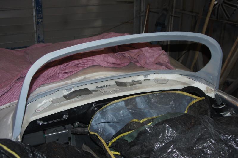

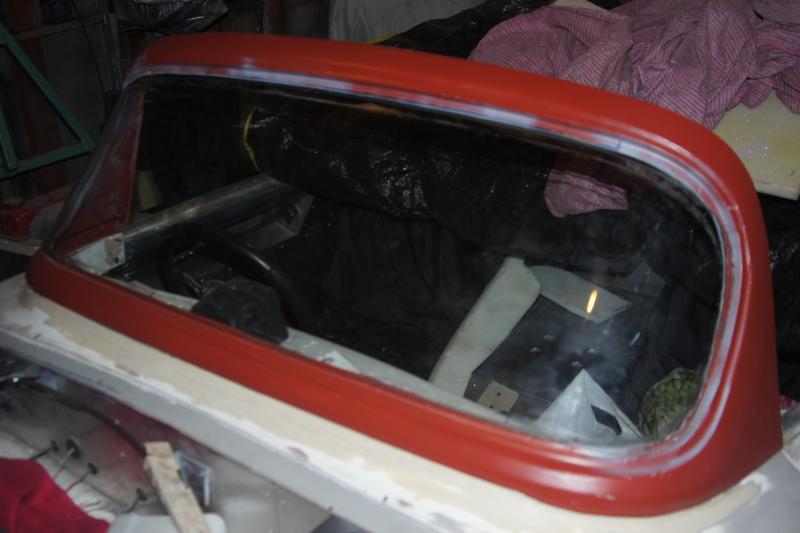

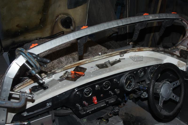

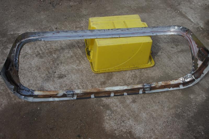

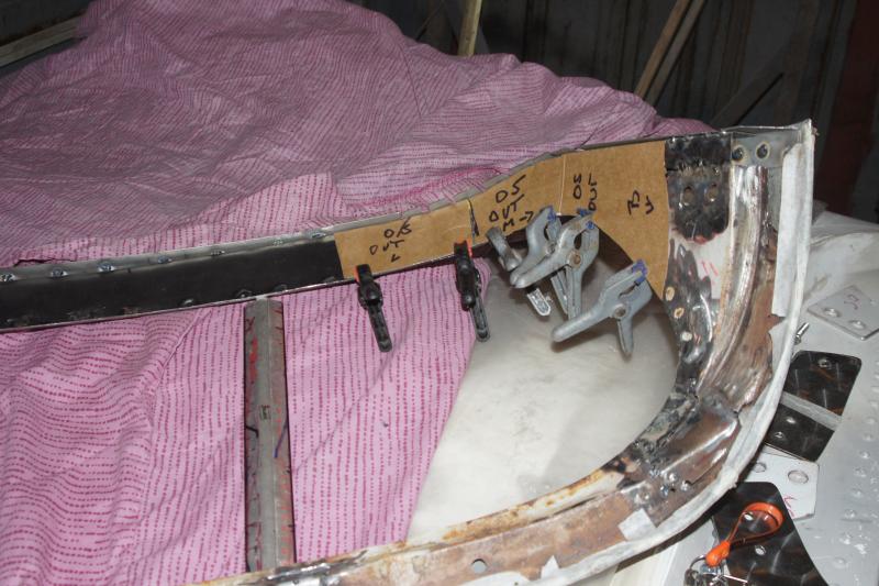

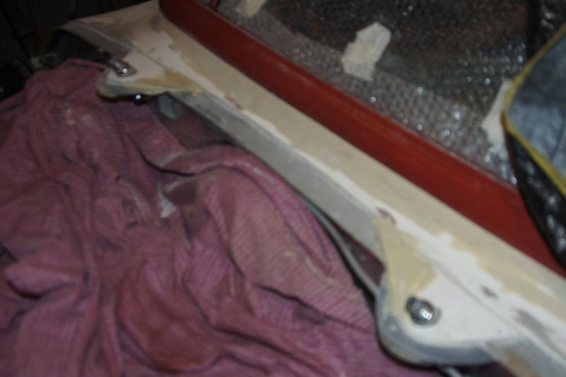

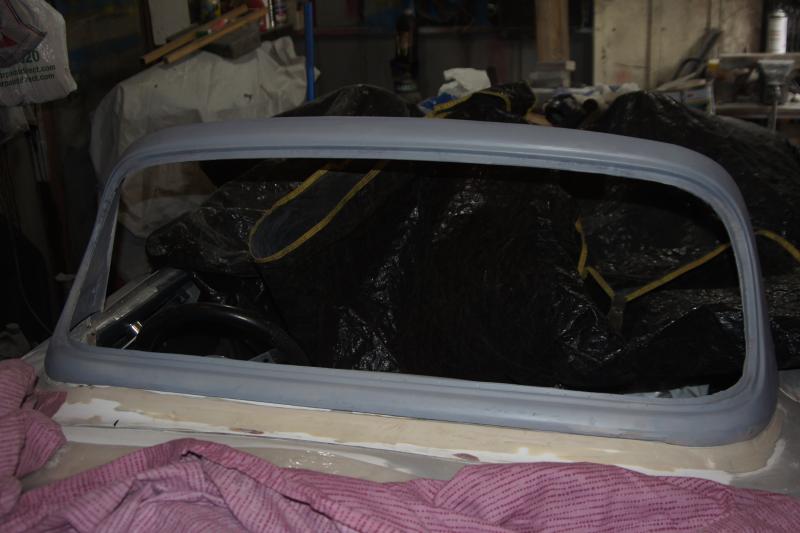

The windscreen frame is coming along slowly finished making the lip and then had to box the frame in to make it rigid.
making the card templates to box the frame.
Now I am on the worst bit filling and sanding because of the amount of welding there is lots of it to be done sanding filling,sanding filling,sanding filling,sanding filling, just thinking about it is driving me towards the TV doh!:sad:
6 Sep 2017, 3:17pm
Looking good!

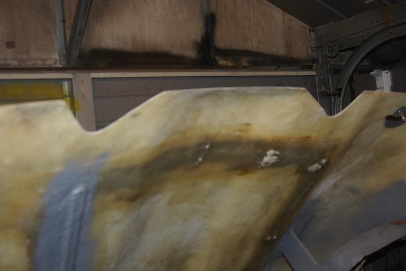

11 Sep 2017, 3:46pm

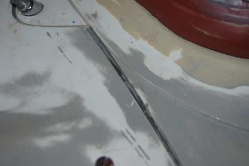

Getting there four days ish of filling and flatting back has got me to this stage
there are still lots and lots of small imperfections so I've just been out to get some stopper filler to try and sort them out more filling/sanding doh:doubt:

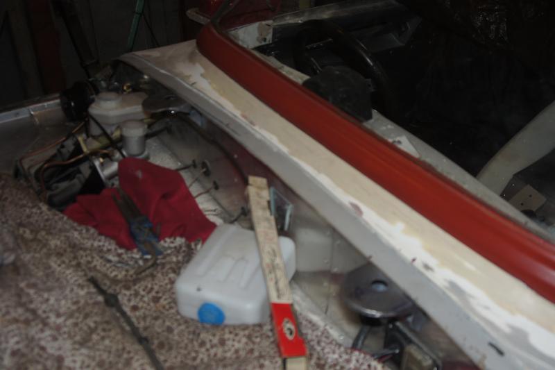

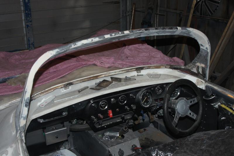

Paul work has stopped on the screen frame as the screen doesn't quite fit correctly there may have been some distortion during the welding ? I did check honest guv. Or it may be the screen rubber which seems to be a special profile but I can't get one I will have to wait for a triumph specialist to get some in stock.

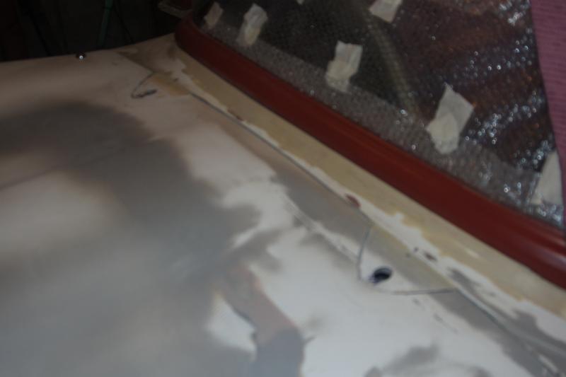

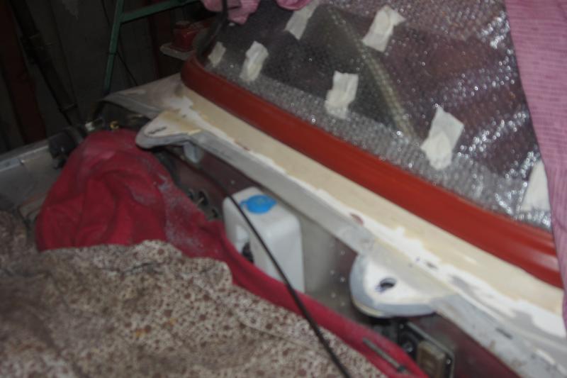

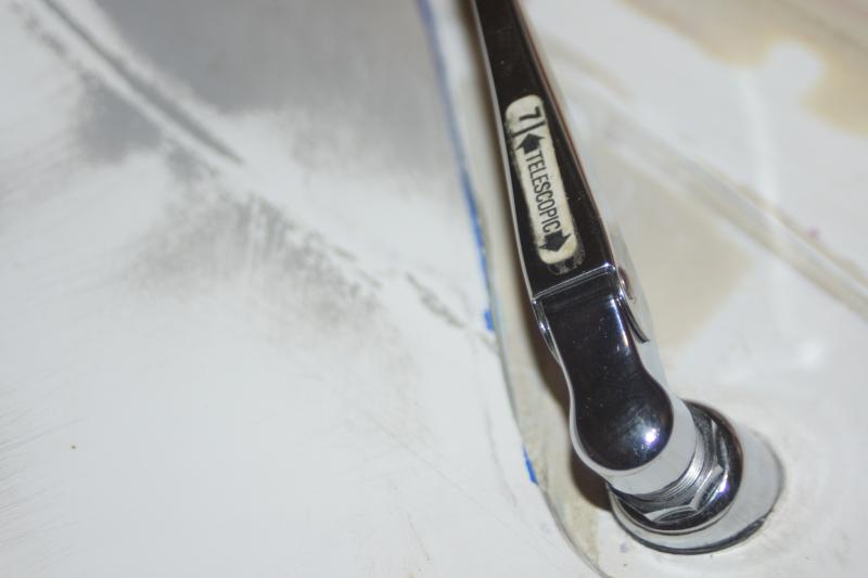

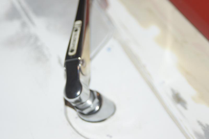

In the mean time I've started on the wiper box mounts you can just about see them in the photo

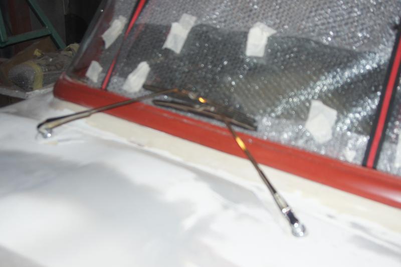

Due to the bonnet bulge I am fitting one at each corner and they should park in the middle one above the other, which threw up another problem the park switch has on the motor has packed up so I've sent for a new one today doh

Not much happening lately I am still waiting for a rear screen rubber. The wiper motor park switch is fitted and a new 90 degree gear drive was also fitted the wheel box mounts are finished and fitted.
And will look like this with the bonnet down.
And up.

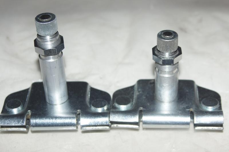

Unfortunately my nice new wheel boxes are too short so I'll have to get some 64mm ones, if anyone needs a set of standard mini wheel boxes (50mm shaft) let me know they cost me £44 for the pair I'll sell them for half that.:violin:

The new wheel box's are 14mm size matters it seems hmmm

Will look like this when finished I will have to set up the wipers so they don't meet in the middle in use (should be fun sorting that out)

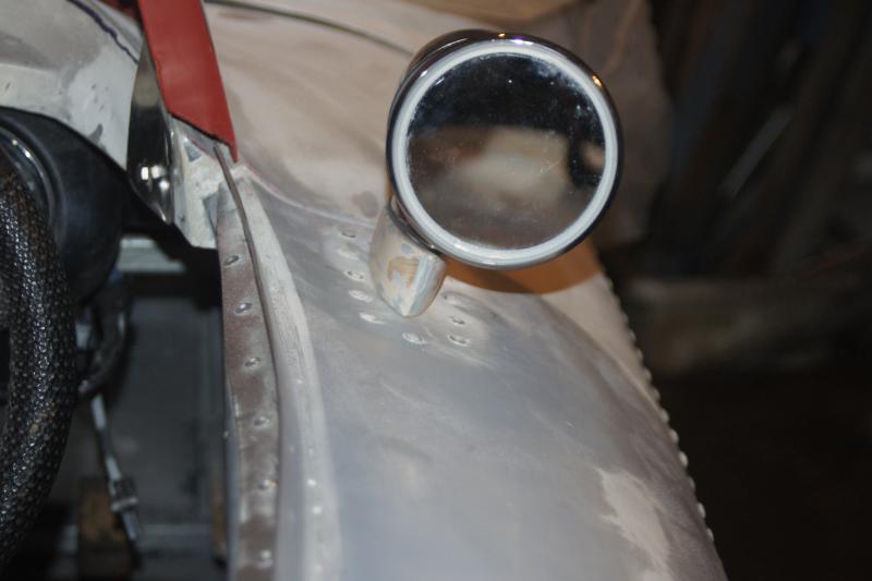

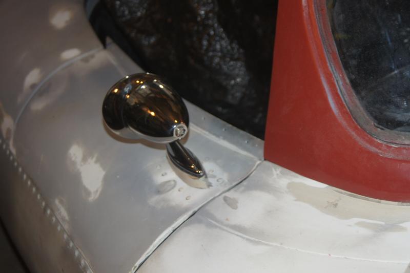

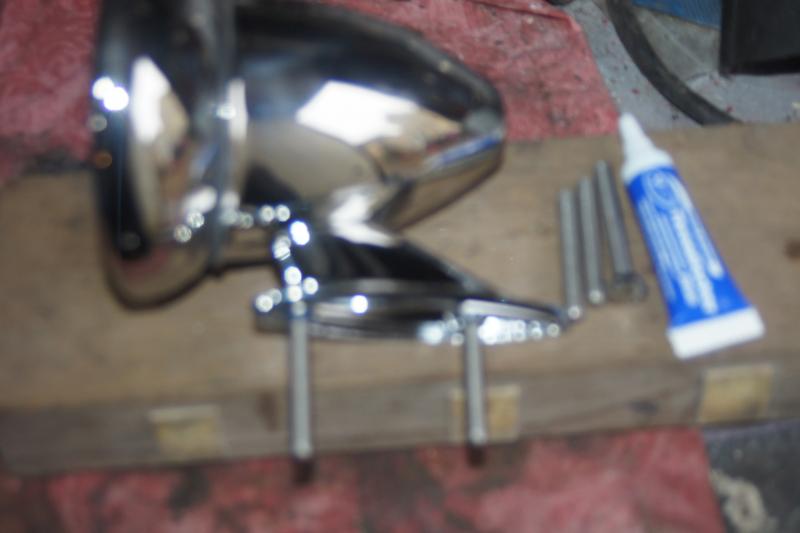

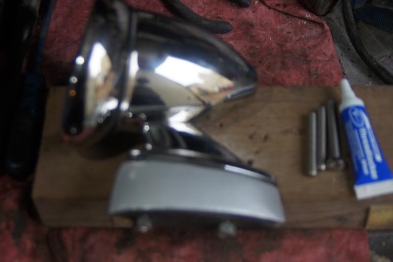

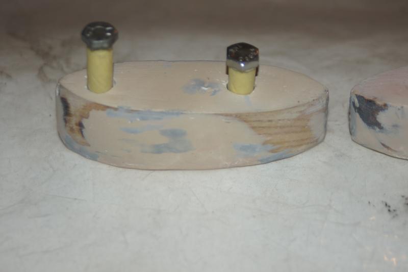

So in the mean time I have started work on the door mirrors they are the stainless bullet type when I tried them out I couldn't see a thing, so I made a plinth out of hard wood to raise them up a bit.
I fibre glassed them but it was so cold they didn't go off :doubt: cleaned it all off and started again.
That's better I also made some backing plates and riveted them in.
It should go well with the rest of the car:first:

Paul They will look like this not finished yet but you get the idea.

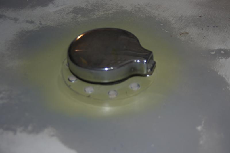

I have also added some trim around the fuel filler.

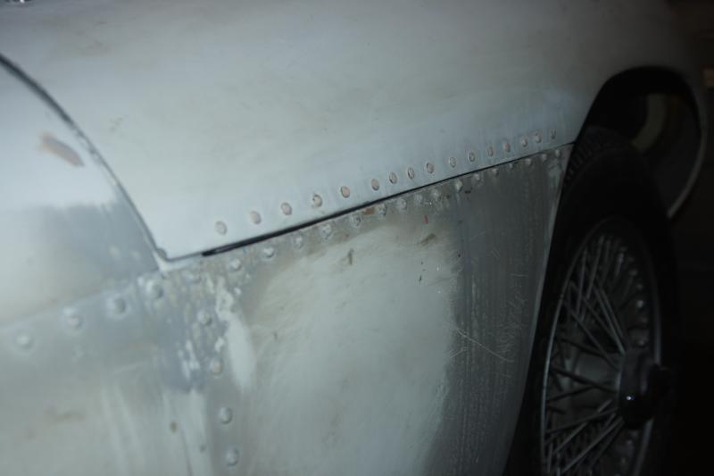

I also riveted the bottom of the bonnet where it closes on the wing, I then had fun filling them in and sanding back too a roundish shape:whoo:
5 Nov 2017, 7:15am
Deggsy – Those mirror plinths are a great solution and I also like all your rivet details. :cool:

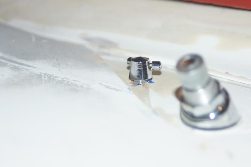

I still can't get a screen rubber so am continuing with other jobs, I cut down some stainless bolts and lock tilted on to the mirrors to make fitting easier.

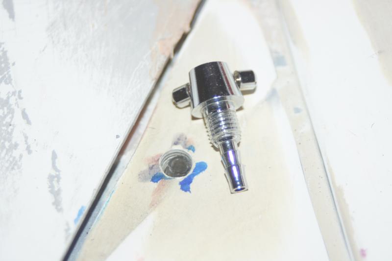

I also sorted out the screen washers the fibreglass was too thick to bolt them in as normal so I drilled and tapped the fibreglass and hey presto it worked a treat they will be lock tilted in place after painting,
that's all for now see you soon.

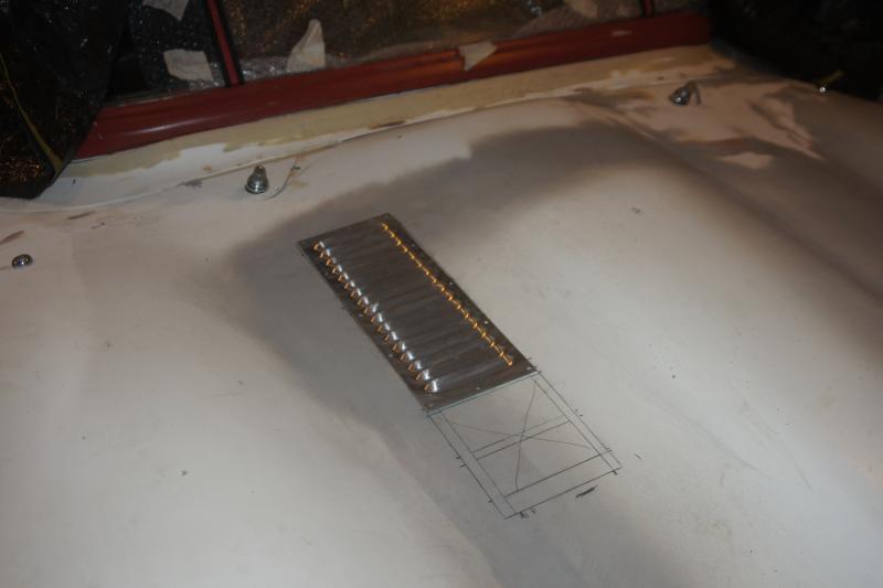

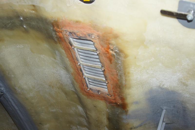

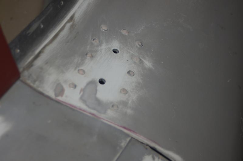

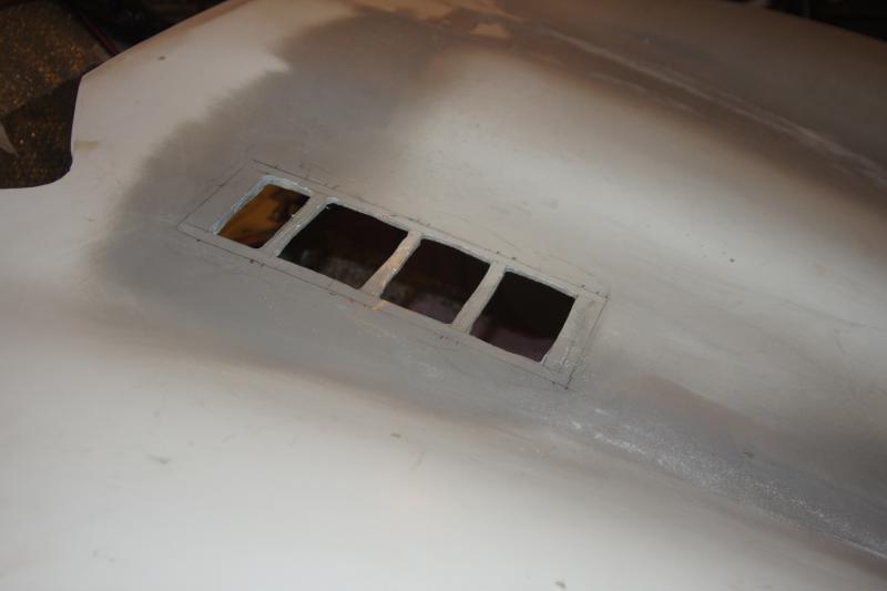

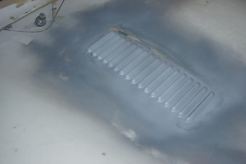

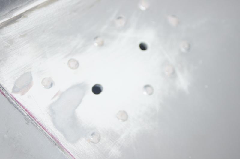

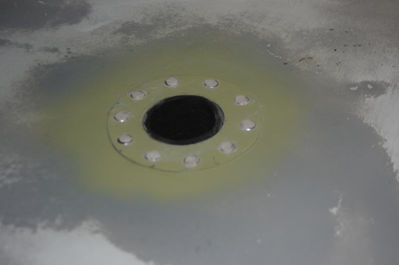

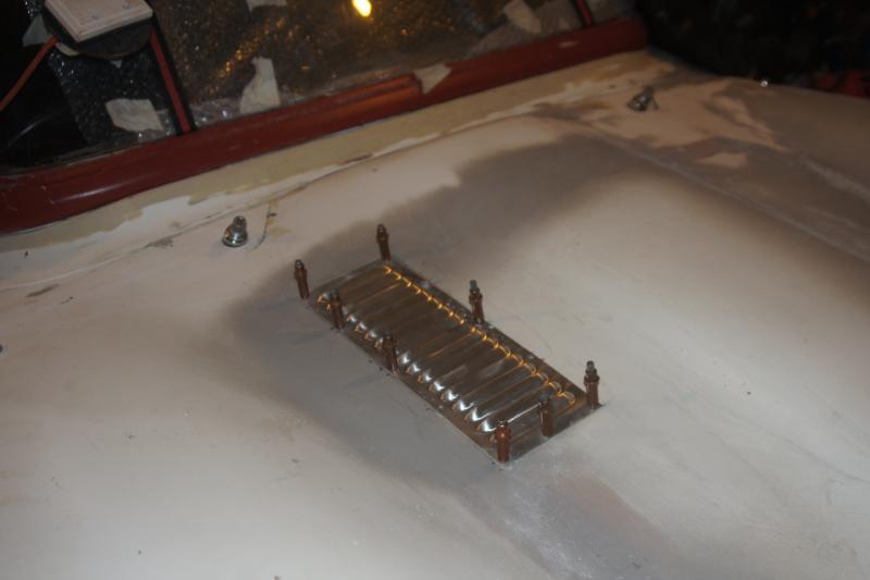

One of the last jobs on the body before paint prep Is the bonnet vent marked up where it was to go several times.
then cut the hole leaving strengthening ribs (just in case)
The hardest part was flatting back the gel cote to a depth of 1 mm to hide the join line:fencing:
then bonded in place.

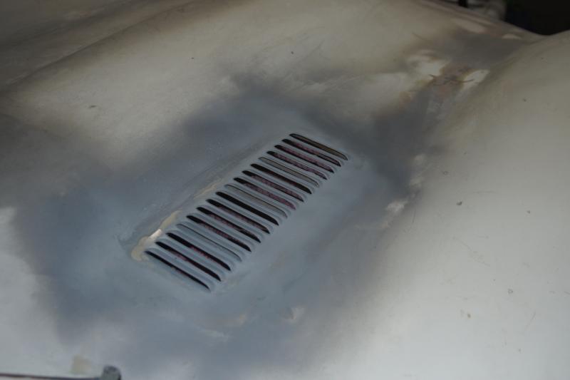

next time it will be back to filling and sanding doh!

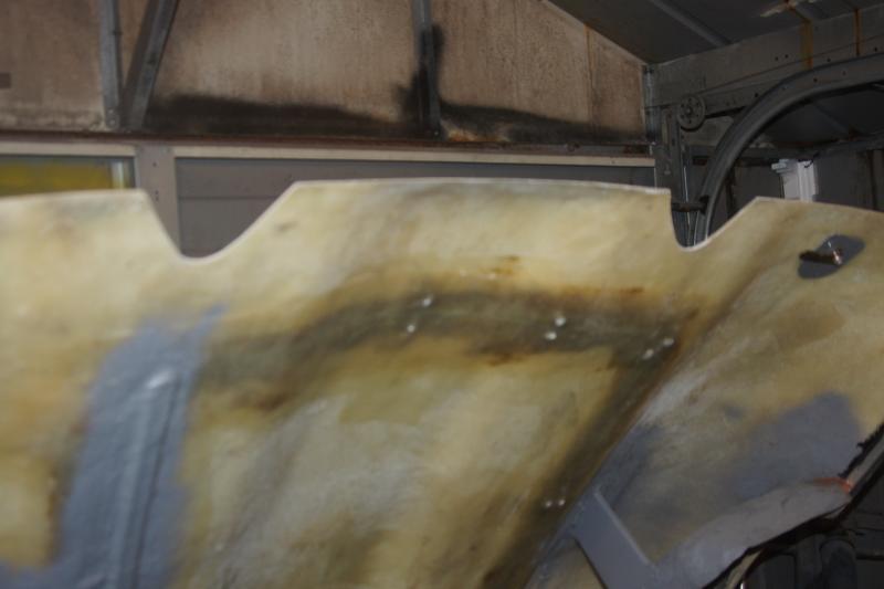

I filled and flatted back the louvers and re enforced the underneath.

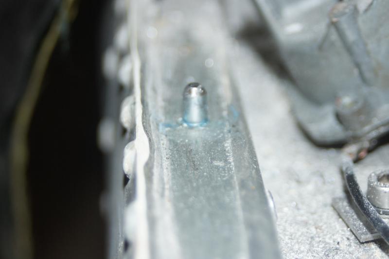

I also made some bonnet locating pins for this I simply drilled and tapped the space frame cut down some 6 mm bolts and locked them in place.

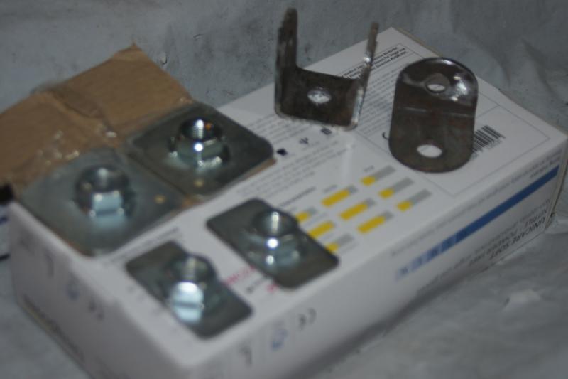

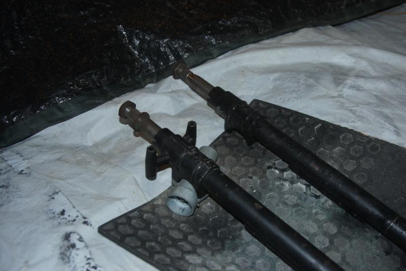

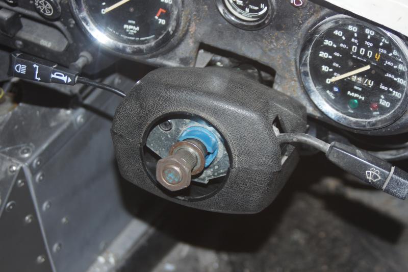

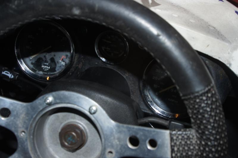

Managed to do a bit this week end for some reason my steering column has no mounting lugs for the cowl I did make an alloy one but wasn't happy with it so I bit the bullet and sent for a replacement I fitted new bushes and installed it but I will have to make a small blanking plate for the dash.
I also have to get 13mm machined off the boss as its fouling the cowl waiting for a friend with a lath to sort that for me.

Well the boss has finally been turned down for me and fits perfectly no photo it didn't turn out doh!
I made and fitted an alloy plate for the steering column.
and it looks OK.

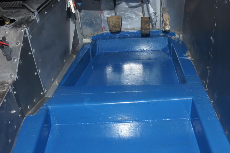

I also re painted the floors ready to make and fit the carpets .
They will be made from a roll I bought at Stoneleigh last year for a tenner I was hoping to have edging put on them but I couldn't find anyone too do them for next to nothing so i will cut them to shape and fix them in with carpet tape and hope for the best :eusa_boohoo:

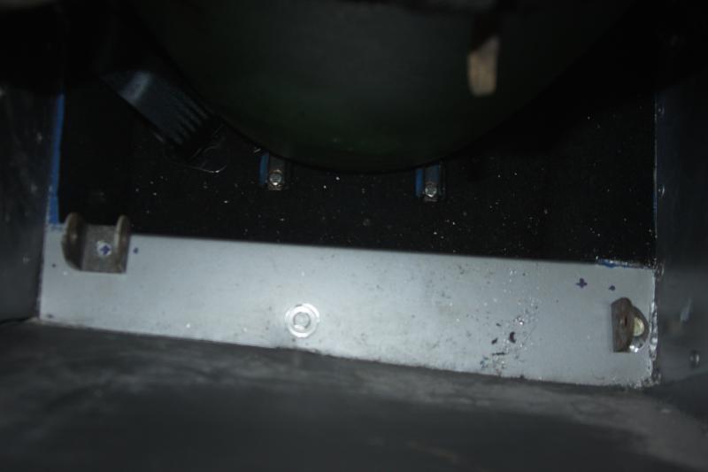

Not much been happening on the car at the moment as most of my time is being spent on the house move but i have managed a few small jobs I had to move the seat-belt mounting points as the original ones are too far forward. New brackets were made and fitted behind the seat (only one done so far)
and they go about here.

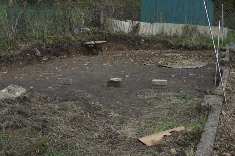

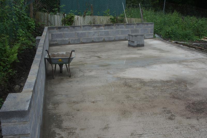

On the up side I now have a nice big concrete slab for the new garage.
Though its not quite level which I hope will be rectified this week the new garage is arriving in the beginning of next month?

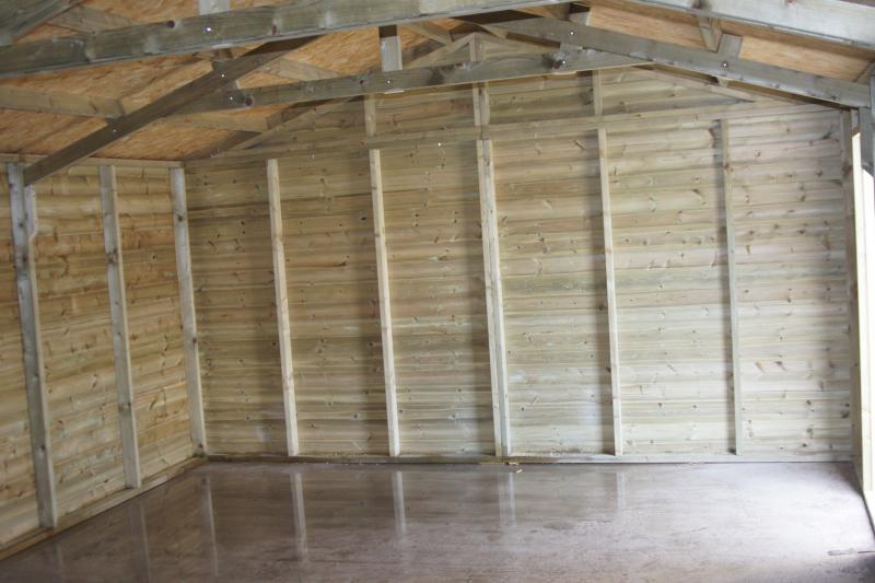

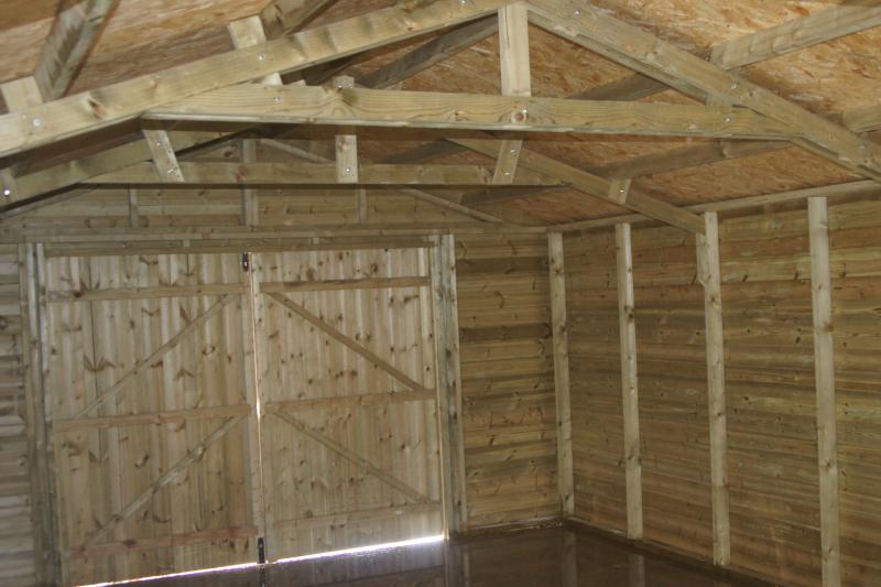

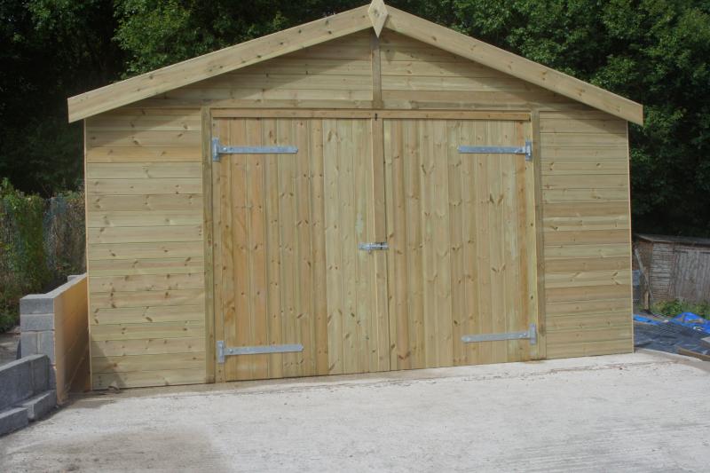

Still no progress on the car but my nice new garage has now been built.
Now all I have to do is seal it. Insulate it. wire it out fit benches and move all my tools and equipment from the old tin shed then bring the car up to re-start working on it.:eusa_boohoo: I am shattered just thinking about it.:noidea:
