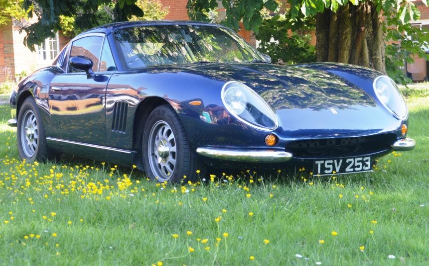

Nearly there . . . . .

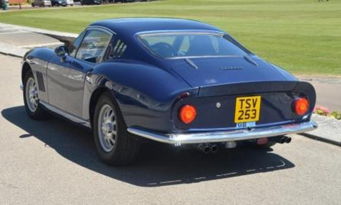

][SIZE="5"][SIZE="5"]GRP work done; painting done; epoxy & waxing done; a few little jobs still to do, but a good bright day and we got the camera out:
[/SIZE][/SIZE]

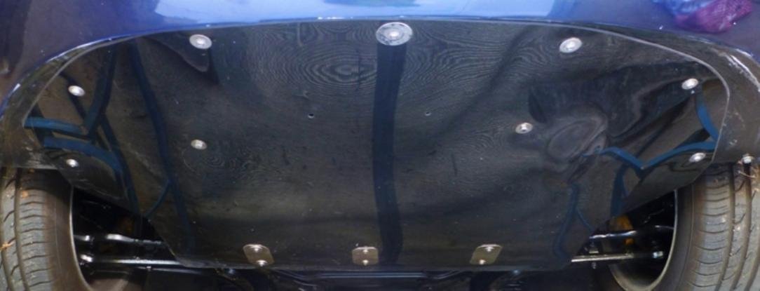

[SIZE="4"]The undertray is made out of 3mm abs type plastic. It is hung from the arb and the valance. There is a small lip on the trailing edge and a bulge to accommodate the steering pipes on the left side. The aim is to smooth the airflow under the car, keep some of the water and road dirt away and so protect components a little. Nice shiny surface for a day or two.[/SIZE]
[SIZE="4"]The headlight cover rims are made from a 3mm brass sheet, which has now been chromed. These seem to really make the front aspect of this curvy car look great. The badge is 33 x 60mm and needs replacing, because the enamel is cracked and lost in places.[/SIZE]
Hope to complete in a couple of weeks and find a good location, here or in France perhaps, for more photos and a running report.

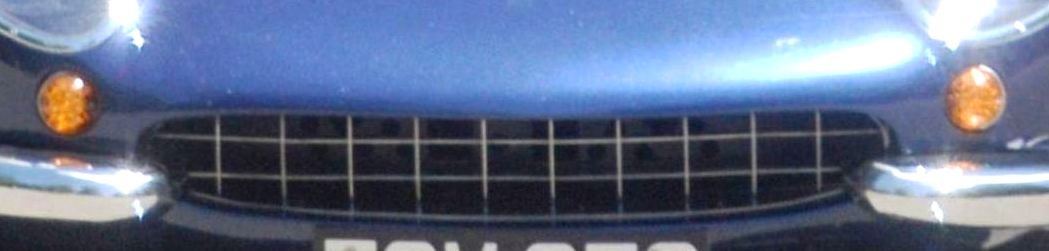

[SIZE="4"]Here is the radiator grill. The stainless vanes were cut to size, shape and curvature by Lasermaster in Cornwall. Then I formed the outside frame [stainless] to shape and to fit the aperture. The vertical and horizontal vanes trimmed and fitted. Then all welded in place.[/SIZE]

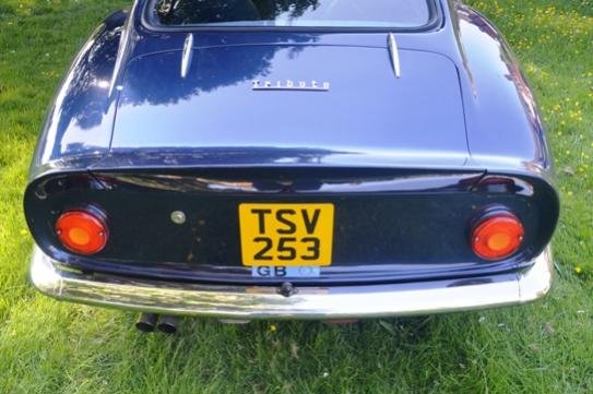

Next came the right side [B]exhaust[/B]. I cut down a spare box and fitted a couple of brackets. We welded on the 50mm stainless tailpipes and cut to length.
To give a realistic look, I burnt some oil & petrol mix to give the 'straw' pipe colour and 'blacked' the insides of the pipes.

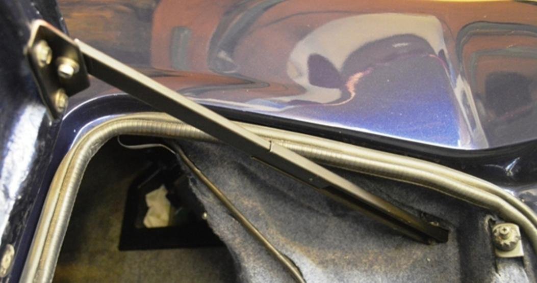

Finally we dealt with the boor lid, by adapting a strut to a shorter length, painting it black and bolting it in place [only one strut needed] from CBS 'BNSTY'. Action is: lift to latch and lift to release.
To ease the opening we used a couple of oem' sprung openers'.

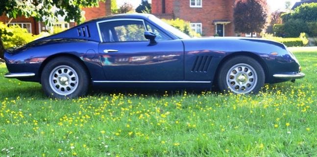

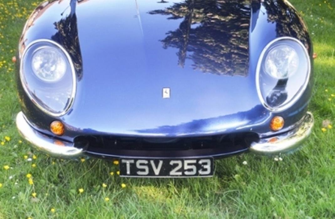

new photos
[SIZE="4"]a bit more access to an unusual location near Hertford.[/SIZE]
Attachment “4 ke gtb 1.jpg” from the original forum could not be reliably recovered.
