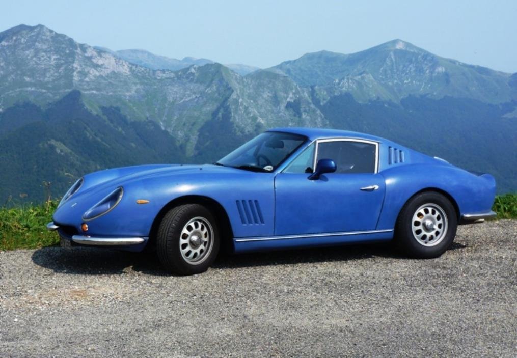

Updates and travel
Once the schools were back Carol & I set off on a trip down through France via Le Mans, the Dordogne and the Pyrenees to Sos del Rey Catolico in Spain. Returning via the Isle d'Oleron and the Eurotunnel.
A tyre change has made the car steer slightly better, by fitting a 215/70 R15 [Vredestein] to the rear - raises it an inch - and a 215/60 R15 [Continental] on the front - about standard ride height. Pressures R:34 & F:30. The rear arch is better filled and more 'period'. Here we are at Guzet near Aulus les Bains in the Pyrenees.
The fog & reversing lights have been moved back under the bumper by a couple of inches, as you can see, though the sheep are totally disinterested. In an attempt at discretion the GB plate was printed off and laminated - euro stars included . . . plus an aluminium front plate.

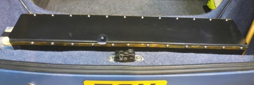

In the boot is a 'baguette box' made of spare pieces of plastic and a piano hinge. The bread fits in quite well, but we used it for a large array of tools, which were not required.

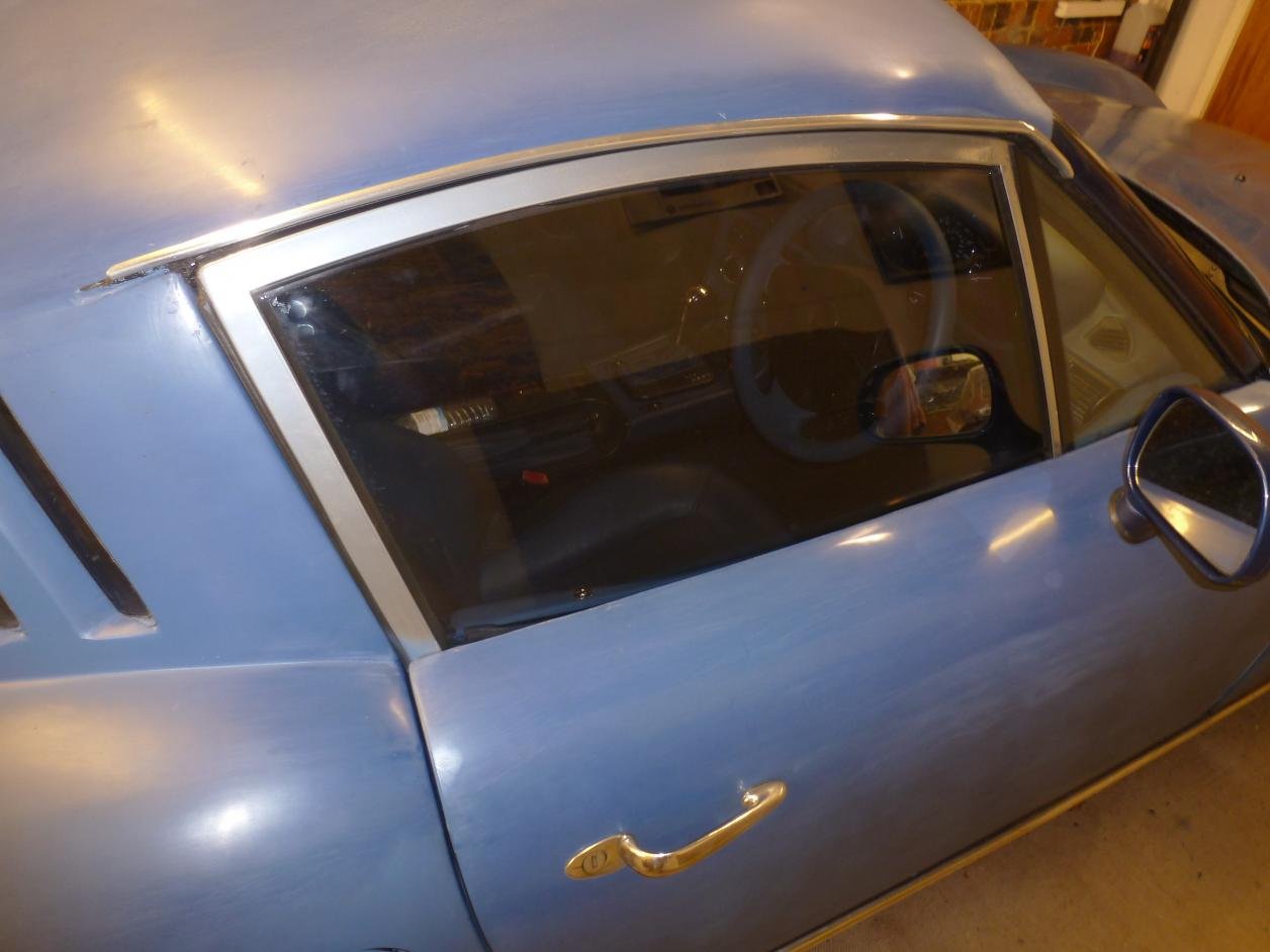

We have tried to fit some guttering over the door tops, with limited success. The basic form comes from a Lotus derivative, which we have bent in various directions to fit / bolted through the door 'return' and sealed with Butyl. Room for improvement. How wide can the gutter gap be ?

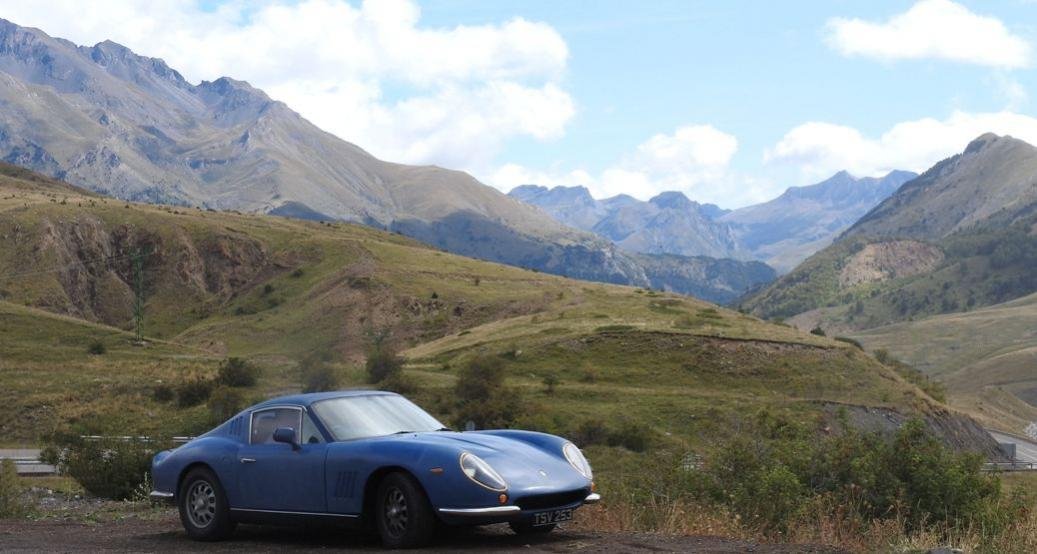

Finally here is a photo from the top of the Puerto Sos pass with Sos del Rey Catolico in the middle distance. The Parador here is a very good one, on the hilltop of the old town. The man who unified Spain was Ferdinand the Catholic born here in 1452.

How did you do they gutters, I like them a lot.
17 Sep 2017, 3:58pm
gutters
The gutters were purchased as a long strip of aluminium with a curved bend along the full length for the gutter. I then cut then down and bent them to fit. Probably they are too tight against the roof edge and I'll have another go at pulling the gutter edge out 2 - 3mm.
