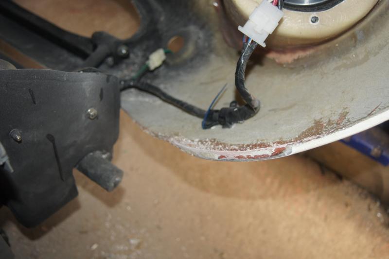

After weeks of sanding the headlamp mounts well ok it was days or hours over lots of days I finally got them fitted, you can't see it in the photos but they look a bit squint I'm not cutting them back off after all my hard work so a bit of packing out will be required to align the headlamps.
It wont be seen so will be ok.

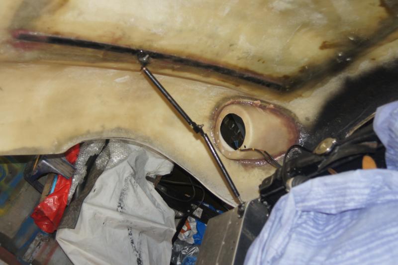

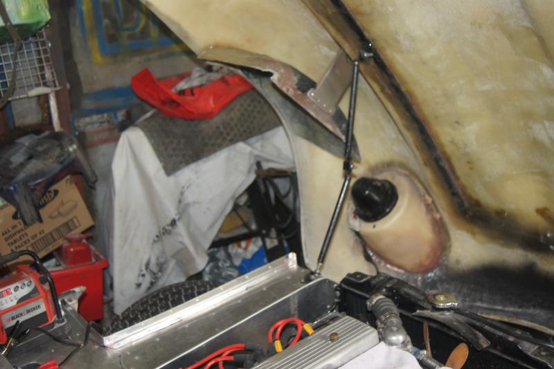

I have just finished making the bonnet prop it is made up of nine pieces not counting the bolts & nuts I could have made it simpler but this one has quite a bit of adjustment if required.
The reinforcing bar is 1m x25mm x4mm which is bonded in with glass paste then three layers of woven glass tape I might add more glass matting later (I ran out) for extra strength. :rockon:

Looks good Degsy, as long as it works that's okay!
Don't leave the bonnet up for long periods in the wind though!!!
I wouldn't do that myself even with my piddly little bonnet. :-)
18 Mar 2017, 8:16pm
Yep it works fine it even locks in place, but leaving it up in the wind could be a disaster. :-)

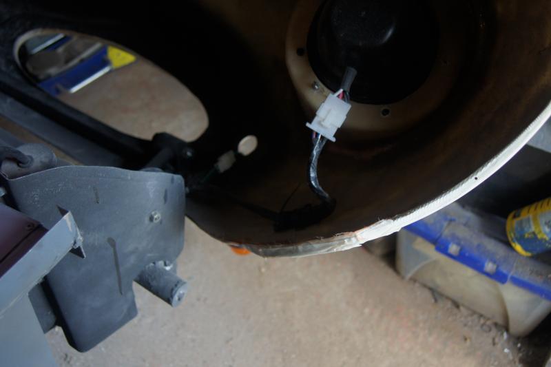

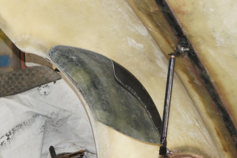

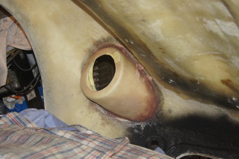

Today I started on the inner front wings the first part (fibre glass trailer wing) this is bonded in place and will be built up to the correct profile I hope:eusa_pray:

The inner wheel arches are pretty much done now since this photo was taken I have reinforced the supports with glass matting and there will be removable mud guard type thingy's to protect the inner headlamps unfortunately work will slowdown a bit more over the next few weeks cos I've got get my seven ready for summer! this happens every April as she's only on the road for 6 months a year.:hand:

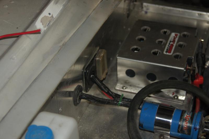

I have managed to get some time in on the A352 I tidied up the wiring in the boot and now have the option of reversing, rear and front fog lights I don't know if I'll fit them yet as not required by law and may not look authentic.

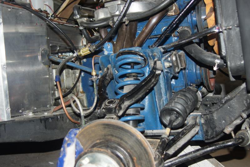

I have also taken off the engine bay panels to get at the suspension to lower the front springs, a bit fiddly as it is trial and error to get it right,
cut out 1 coil flatten it down grind a flat seat re fit lower the car check1 probably wrong so start all over doh again:humble:

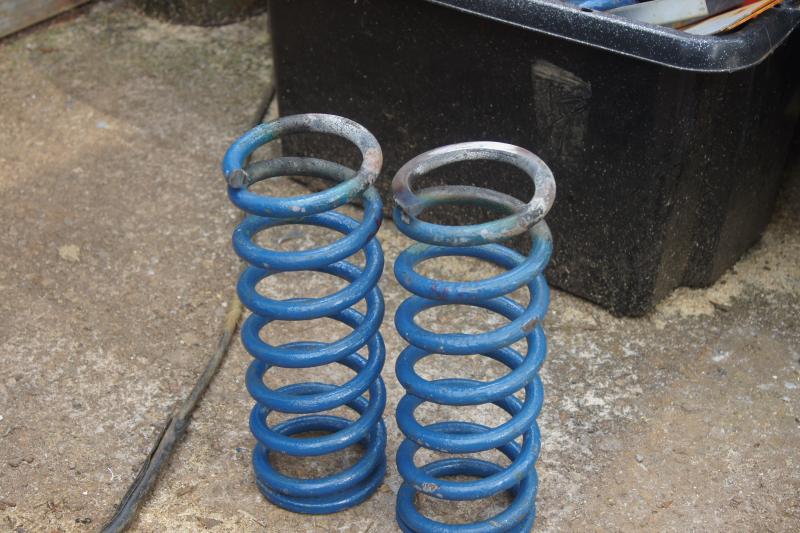

These are the springs with another coil removed bent and ground flat.
It didn't go well fitted it all up lowered the car ant the suspension went all the way down to the bump stops. Doh :eusa_wall: I think there is sommit wrong with my calculations. :icon_cry:

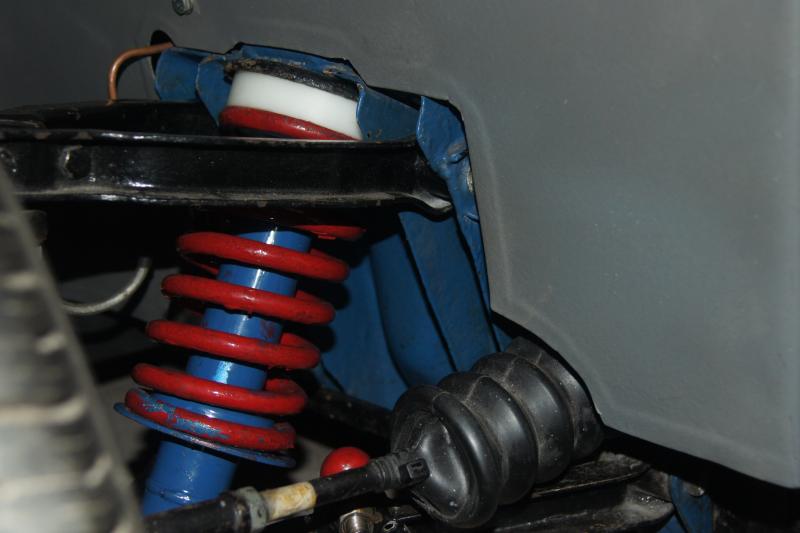

15 May 2017, 3:23pm
Fixed it
The front suspension is sorted now with a couple of 7/8" spacers from those nice people at Moss. It's still a little bit higher than I wanted but it should look ok once the wheel spacers are added (fill the wheel arches better)I hope:whoo:

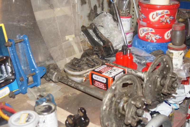

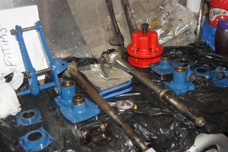

I started work on the long drive shafts a few days ago.
Getting it all ready for strip down
Hubs off cleaned and checked the shafts are only just usable why would you have the needle roller bearings running directly on the shaft however designed that should have been sacked?
Waiting for the bearings to arrive now. Of course once it's all assembled and installed I have to make some new radius arms as they never fitted the long shafts to the herald :idea:

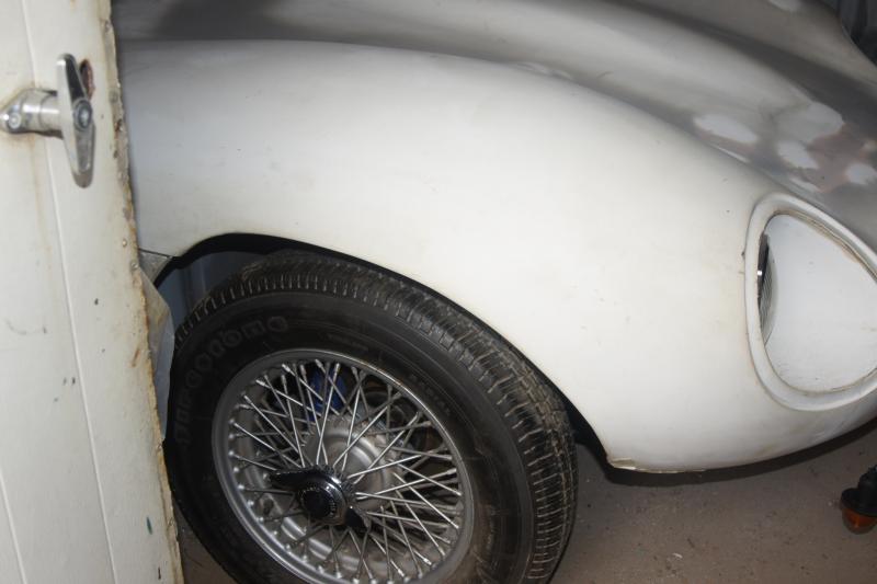

this of course caused it's own problem the tyres were now catching on the lower wheel arch these were cut back and a new lip made with glass paste.
\I find this shooooo much easier than fafing about with matting, resin, and hardener.

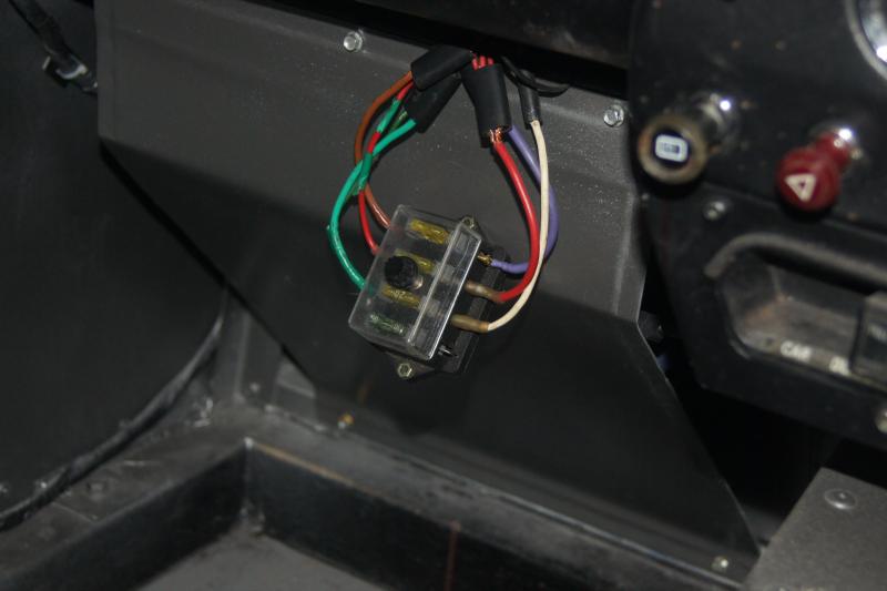

I tried to turn the car around yesterday to state work on the rear drive shafts but the blinking thing wouldn't start again? after hours of playing with it I concluded it was a fuse box bad connection I had no indicators fuel gauge or ignition unless I pressed on the fuses so I spent all my free time today wiring in a new one very fiddly when you can't gat at the wires properly. With the new one wired in the car eventually started I just have to tidy up the wiring and decide where to locate it when I have five.:juggle:
4 Jun 2017, 2:43pm
Deggsy - I know that useless Spitfire fuse box feeling all too well. :icon_sad:
It is just a shame I had ripped the wiring loom for the front lights to pieces trying to find the fault before I fitted this.
Although making a nice alloy cover to protect the fuses is still on my 'To Do' list. :rolleyes:

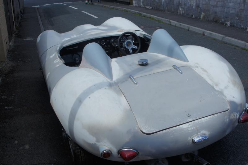

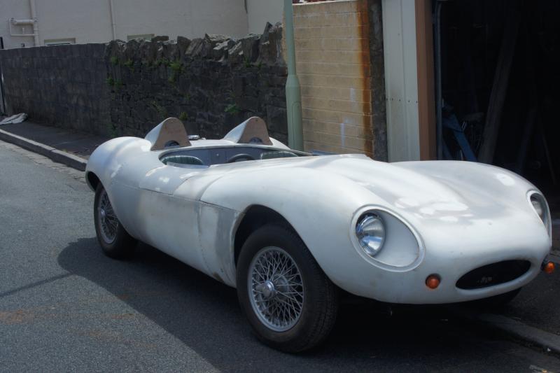

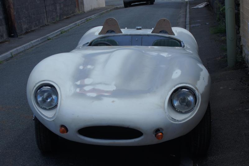

I've spent a few hours trying to re-setup the front suspension and steering It's getting closer the camber is now 5% neg (should be 1%) and the wheels are just touching the chassis on full lock so a bit more to do yet!
but whilst I had the opportunity I decided to turn the car around to have a go at the back end and have a photo shoot for the DVLA and you lot of course.
as you can see the back wheels are a bit lost in the arches even with the wheel spacers on I am hoping the longer spitfire shafts will help but it eill be an awful lot of work for an extra 25mm ouch:faint2:
