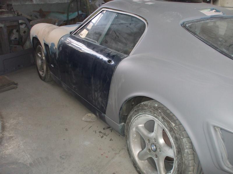

25 Feb 2016, 11:22am
Colour choice made final now and will probably be followed by several other final decisions on colour.
Door to wing issue pretty much sorted now bar a little fettling to stop any rubbing. A version of the Nubodi split, cut and fibreglass method was used.

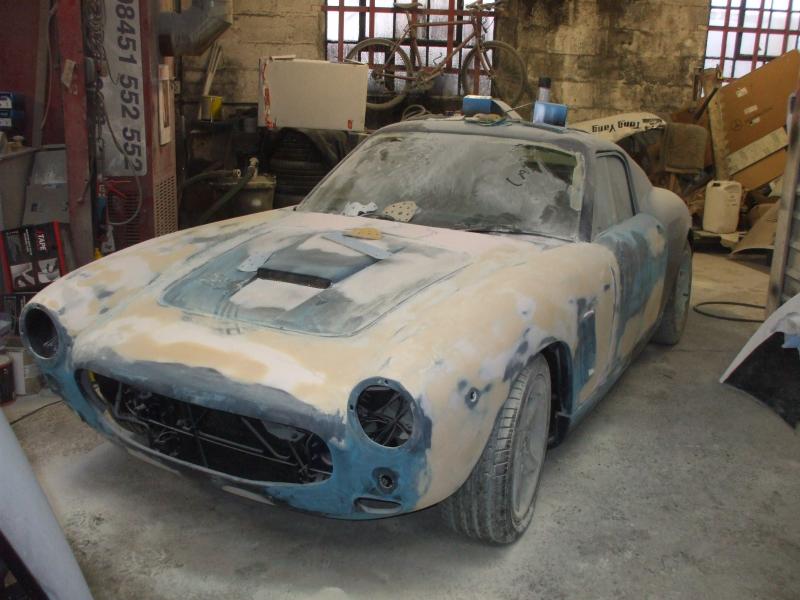

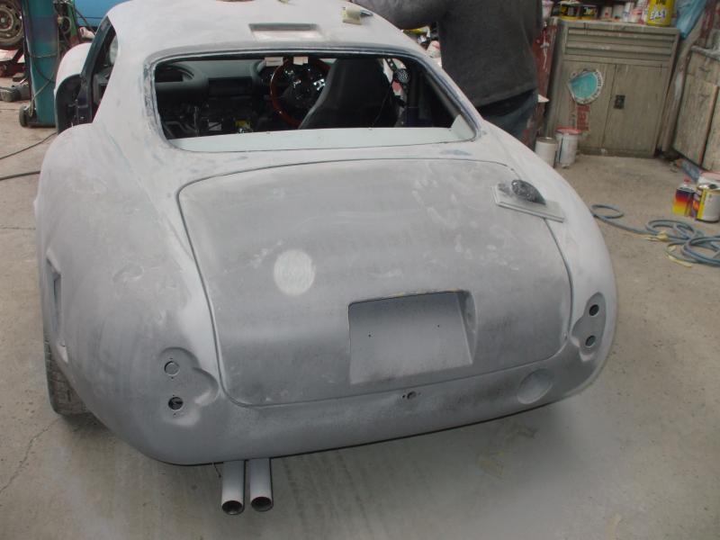

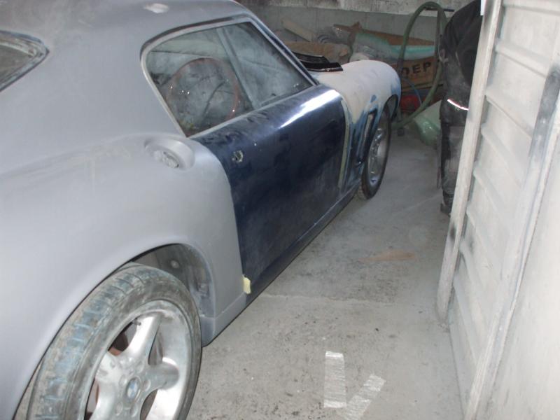

Paint shop trip this morning. They've put loads of work in this week and it should be in primer today or tomorrow. Hopefully I'll be putting top coat photos up early next week.
Paint is finally set at the dark blue from the sample painted on the wing earlier. Paint ordered now so no more idea changes.
Bob.

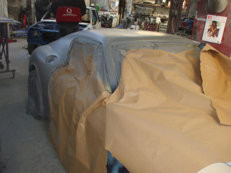

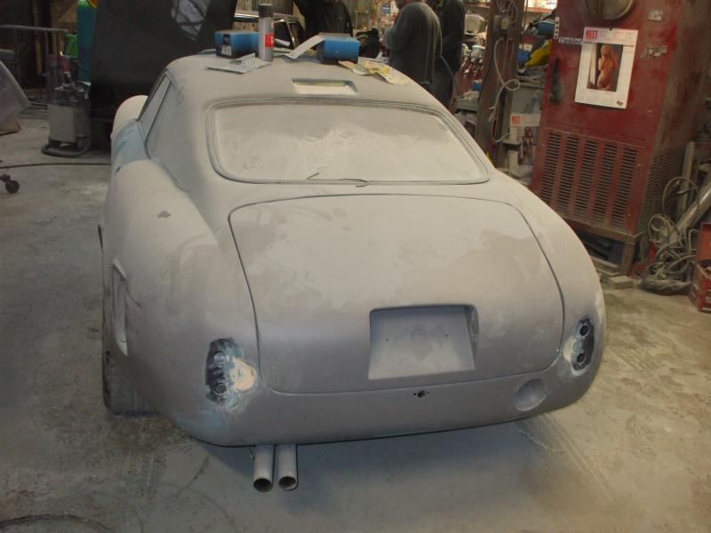

11 Mar 2016, 3:41pm

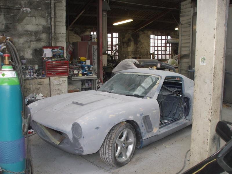

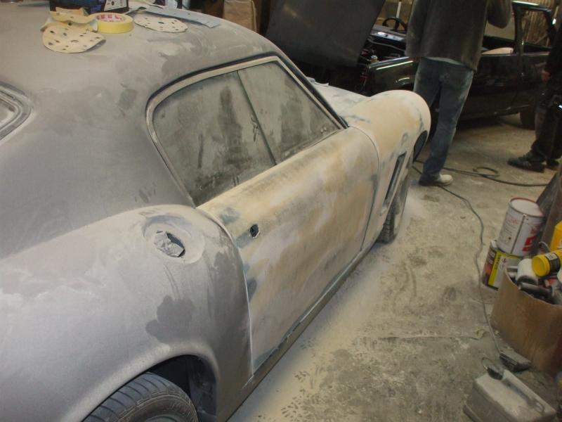

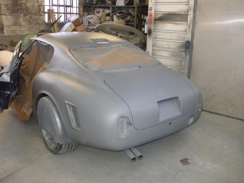

It's getting close.

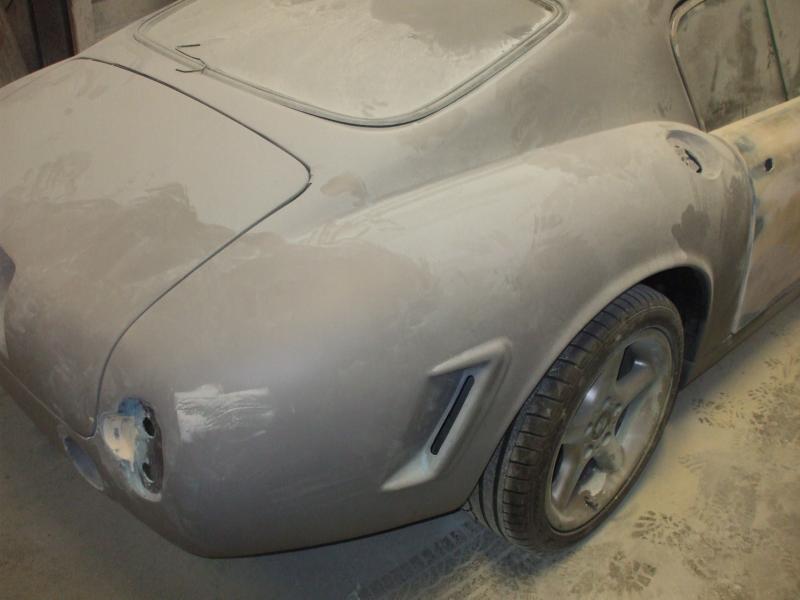

Whilst the doors were off the check straps were shortened a bit to ease the door gap issues.
Window frames are also off for me to fettle and repaint.
Body has been primered, stoppered, primered, and is getting it's was rubbing down. door shuts and the inside of the doors and boot lid are being prepared for paint.
Undercoat this weekend, top coats soon after.
Bob.

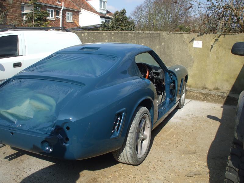

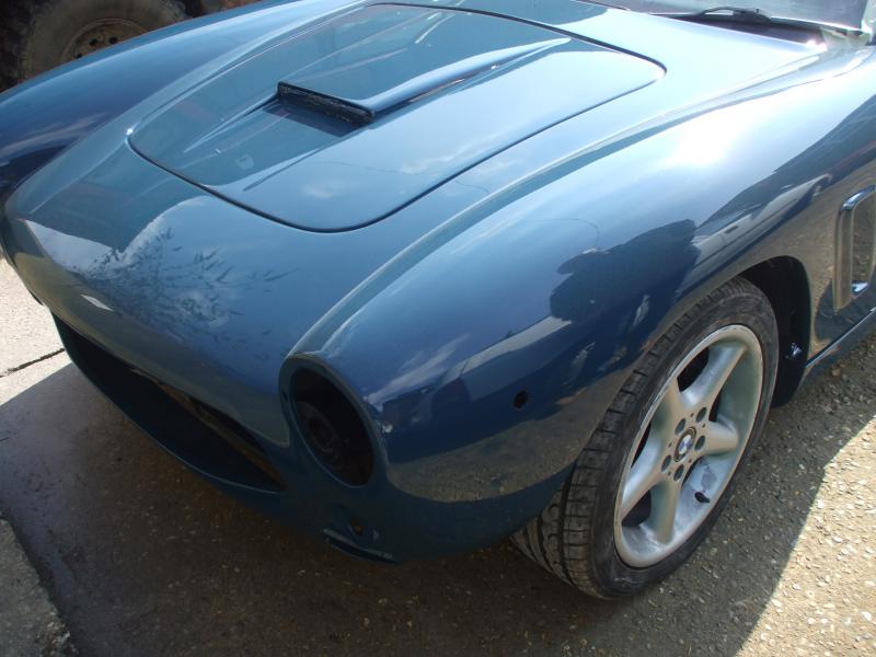

17 Mar 2016, 12:18pm

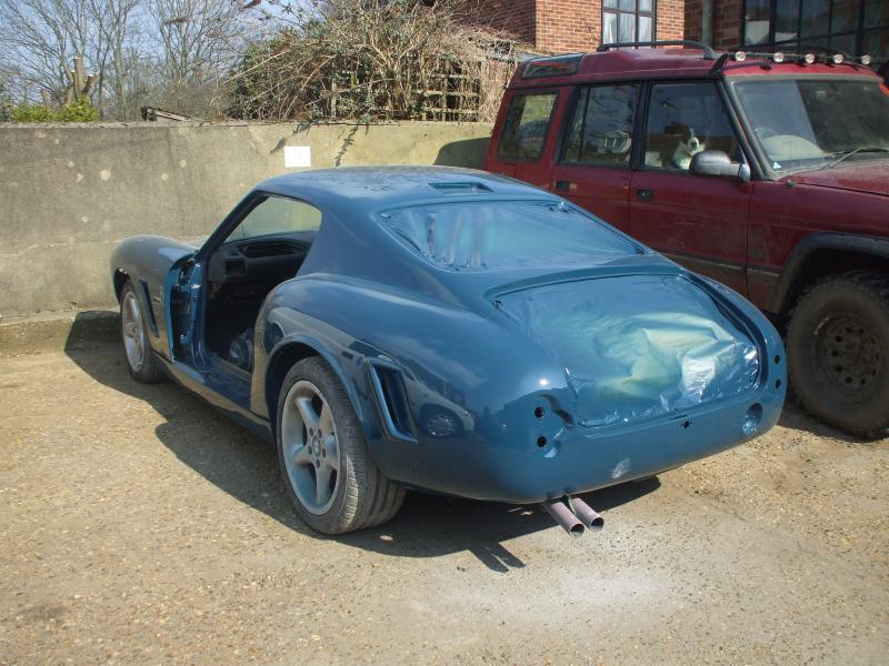

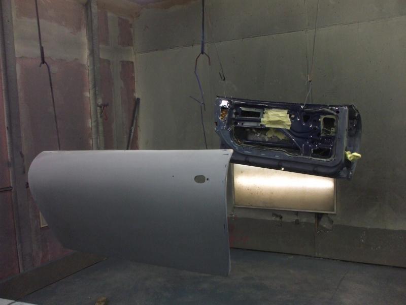

PAINT
It came out of the spray booth this morning. It looks lovely, the blue seems to change from blue to greeny blue to even purplish blue in the shadows depending on the light although it only a straight colour with no metallics, pearls of other fancy stuff in it.
The doors and boot will be painted this afternoon and the car flatted and polished tomorrow. I've got to finish filling/sanding/painting the window frames now as I need them reassembled and ready for fitting on Saturday when the doors, skins and handles go on.
Fitting up starts early next week.
