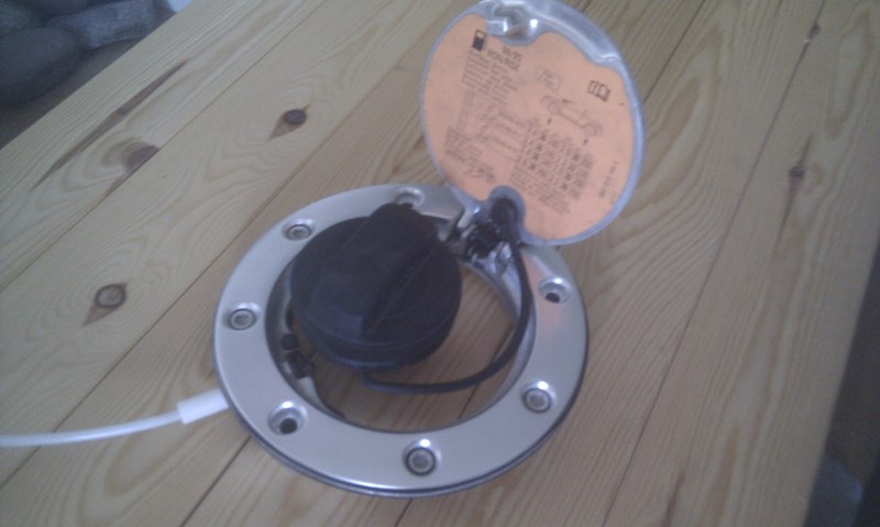

Anyway, I bought this recently. I might use it. I will have a Monza flip cap whatever happens because they look the part, but it may just be a dummy. If so, this will house the Mazda tank filler and add a tiny level of security. As I said, I may not use it, but it is quite neat.

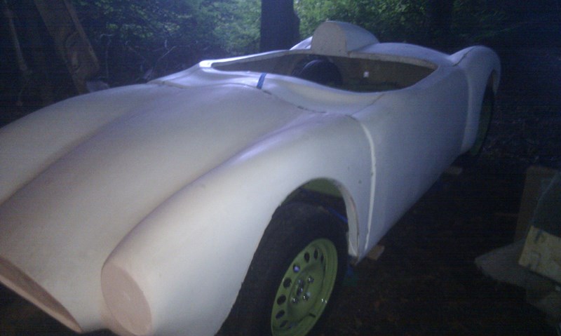

Some very preliminary trial fitting tonight to get some measurements. It is morale boosting to have the body out of the loft space for the first time in more than a year. It doesn't appear to have suffered. First signs are that the wheels will fill the arches nicely........when everything is tweaked.
First impression is that the bonnet will require a couple of Oxford bulges, which I am quite glad about.

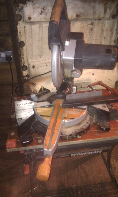

Two unrelated pictures. The first is the world's loudest power tool. I used it tonight to cut the first lengths of box section. It all went to plan.

Oxford - At least the sound of the metal cutter will not disturb the neighbours. :icon_wink:

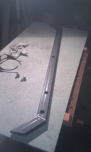

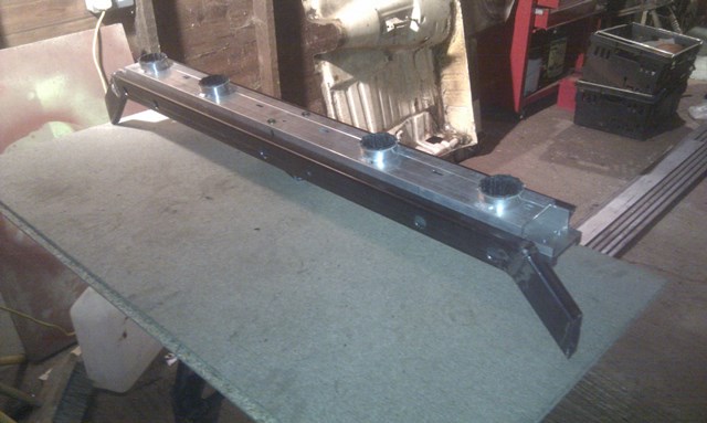

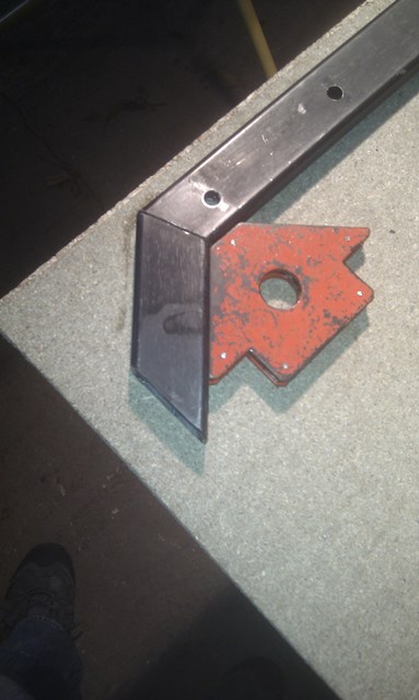

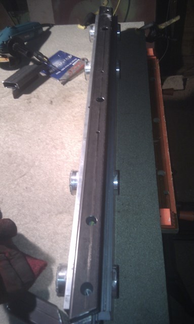

Just over an hour down at The Glade this evening. I continued work on the rear bulkhead.

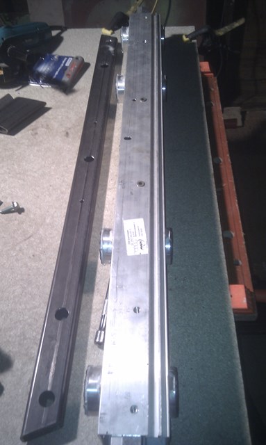

The Audi crosssmember will form the top. This will be sandwiched between two lengths of 50x25 box.
The two pictures below show the aluminium crossmember and the front length of box.
The two below show before and after welding.
The final one shows the three pieces of box that form the top of the front of the bulkhead welded together. An identical one will attach to the rear. Vertical lengths of box will attach this to the ends of the rear outriggers.
The bolts are recessed so that a sheet of ally can be riveted to it to line the rear of the cockpit.

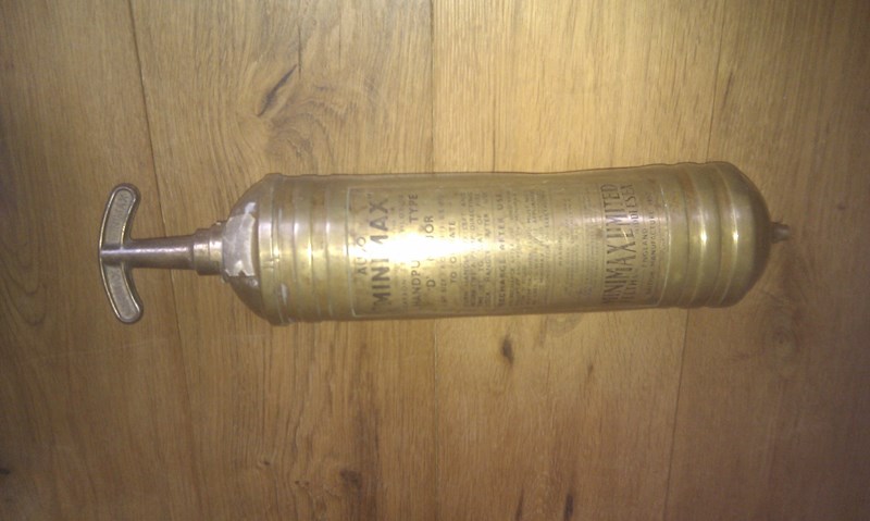

I picked up this fire extinguisher which I shall mount inside the cockpit as a period prop. It is stamped "1960". Just a year before mankind put one of its own into space, this was the type of kit that people used to fight fires - a lump of brass filled with a dodgy chemical.

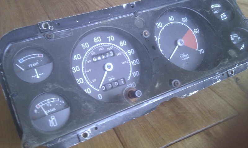

The other item I bought was a set of gauges. I doubt I will use them on this build but I just liked them. I feel they look older than they are. And, what is more, they all work. Can any former boy-racer recognise which iconic 70s vehicle it comes from?
Whilst at the show, my teenage son fell for a Lomax. I've always fancied building a Morganesque three-wheeler and I am a fan of the 2CV lump. So, next project decided.
22 Aug 2013, 7:48am
Gauges
Something LHD? ... Something American? .... Corvette?
22 Aug 2013, 7:56am
Capri?
22 Aug 2013, 8:17am
Spot on. Capri GT MkI.
