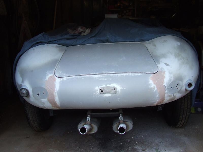

Good progress, keep the pics coming!
1 Dec 2016, 7:31pm
Deggsy - Your boot is coming together nicely. :cool:
Good to see I am not the only one using old cardboard beer cases during the build process.
I even used empty cans of Fosters for my fibreglass tail pipe cut outs.
1 Dec 2016, 7:34pm
Nice one Degsy!
Don't you dare blame me if it doesn't come out right!!
Mine came out right!! Seriously, it looks fine, and I'm sure that your's will come out just perfectly. As you say, it is a lot of extra work, but I am really pleased I did mine that way, and have never regretted it. Don't forget the drain holes in both corners!
1 Dec 2016, 8:19pm
Thanks' gents Aghhh both Scottie corners if you look closely you can see the one and only one in the centre doh!
1 Dec 2016, 8:21pm
or even both corners Scottie oops
1 Dec 2016, 10:52pm
One two or three holes Degsy, it doesn't really matter as long as whatever you choose stops water getting in the boot!
Rock on! Its looking good.

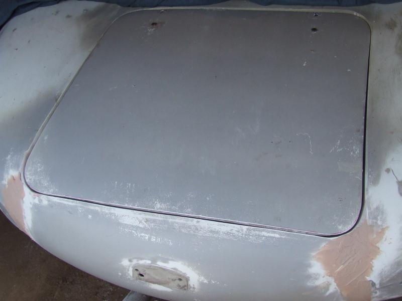

7 Dec 2016, 10:35pm
Almost finished the boot lid mods just a lot of sanding filling sanding etc etc my D.A. decided to give in just when I needed
it most as usual so blocking by hand until a new backing disk arrives I also fitted the boot lid lock (not in the pic)

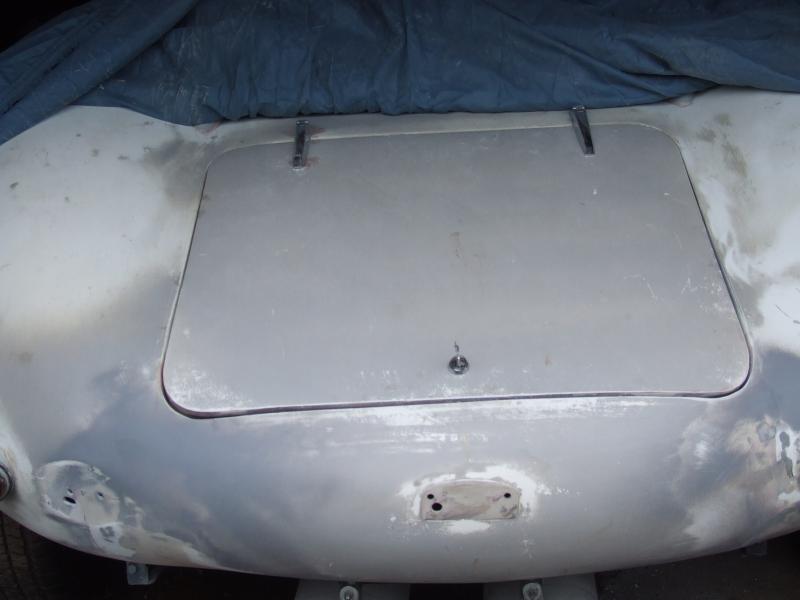

17 Dec 2016, 9:23pm
Not a lot happening at the moment the boot lid is finished apart from final sanding.

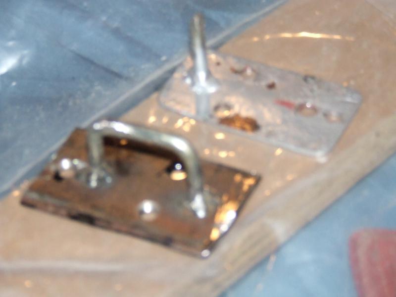

And I have been reworking the door looking pins I didn't like the single pin arrangement too east to snag your clothes on. I expect I'll be refining them in any spare time I have over Christmas.
Sorry about the fuzzy photo.

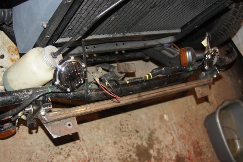

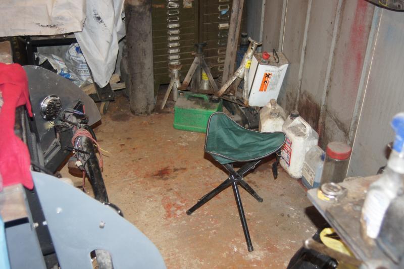

No work done on the car over Christmas but I have managed to make some space in the garage I realised some time ago that I didn't have enough room to fit the front end so after moving storage lockers and throwing out of that stuff you keep in case you might need it one day I have managed to create a bit of room.
just about enough to fit and work on the front end.

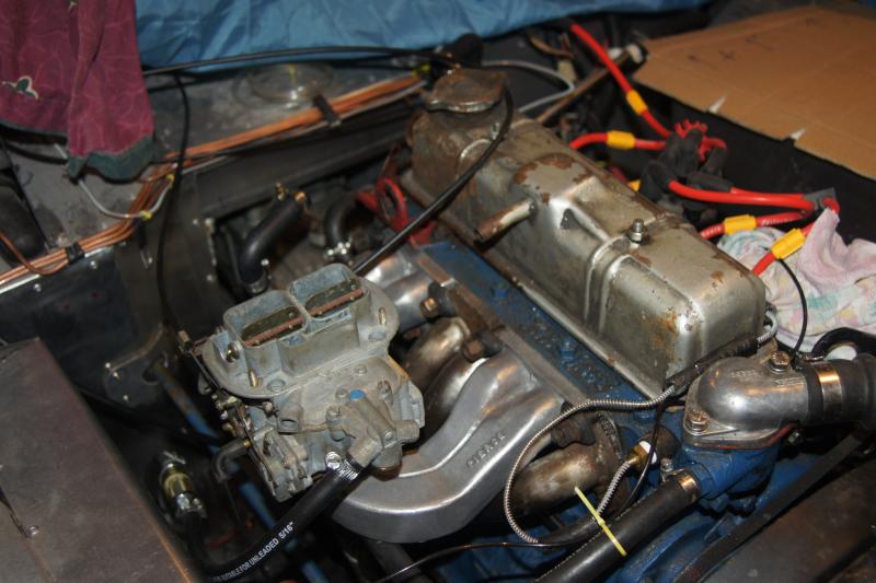

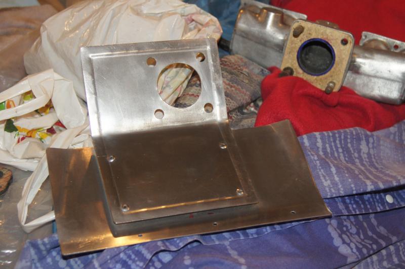

I finished the door locking pins over Christmas and they seem to work quite well now. As I said before I am changing the twin 1 .1/2" carbs for a single 1.3/4 SU whilst waiting for the carb and re-build kit to arrive I made a heat shield out of a couple of bits of ally.
I've also sent for a grinding bit too open the inlet manifold out to 1.3/4.
I had a small disaster I've lost the cap for the alloy rocker cover so I've reverted back to the tin one for now doh!

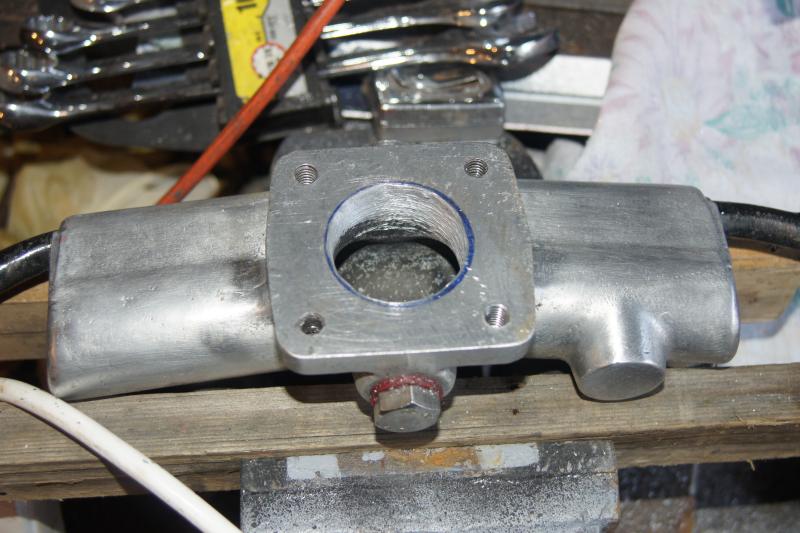

14 Jan 2017, 4:59pm

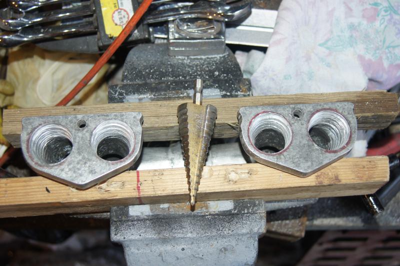

I started modifying the inlet manifold the carb side was quite easy only a small amount of metal to take off but the head side ho boy in the end I used a stepper drill opening up the ports to 32mm then grind them flush.

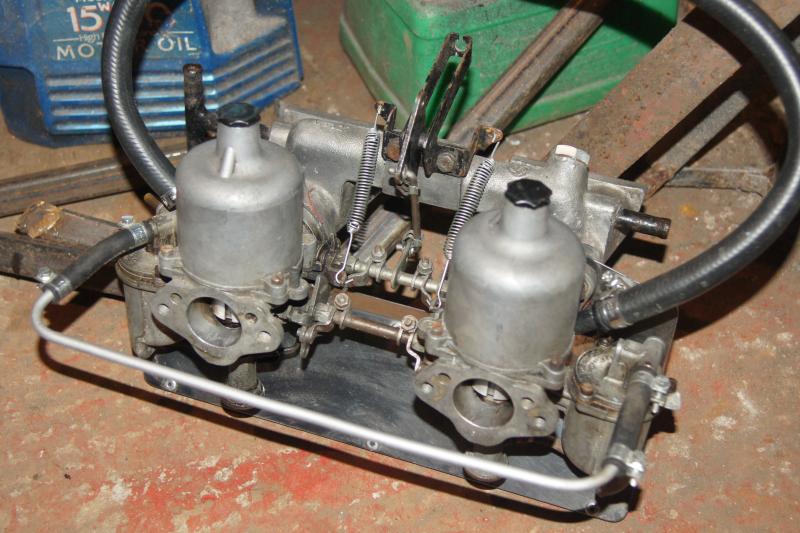

When I removed the twin carbs I found out the manifold gasket was blowing in about half a dozed places probably why I couldn't tune them but being a stubborn git? I will press on with the single carb setup.
Once I now it is running properly I will sell the twin carb setup should be a nice buy for someone as it will come with stainless steel heat shield and filters.

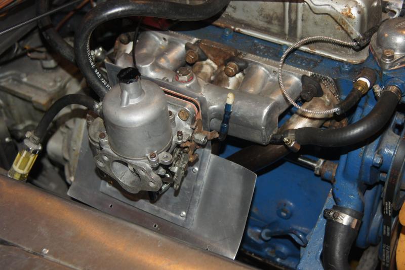

This is my new carby setup a single 1.3/4 Su running but not properly yet I need a different needle and jet and having issues getting the right ones :exclaim: in the mean time ill have to make a throttle bracket for it.
also started planning the flip up bonnet brackets.
I will update you on them later.

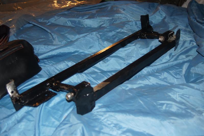

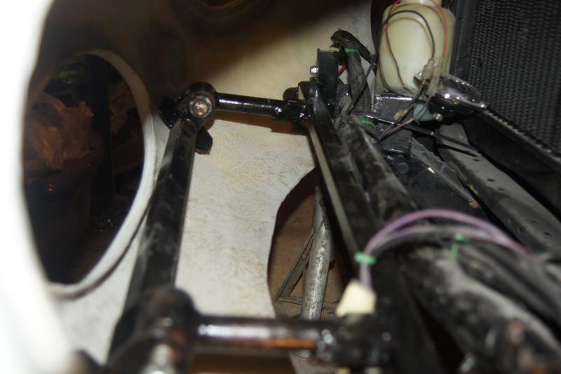

Started making the brackets for the bonnet I have also got a pair of locost suspension arm bracket ends which will be the swivels unfortunately the bonnet is quarter mile away in a lockup so cant be finished until I get it into my garage.
I couldn't get the right needle for the 1. 3/4 su then this came up on eBay it cost £100 less than just the inlet manifold and linkage for my side draught weber so I bit the bullet and went for it just waiting for some stainless pipe and it will be done.
I've got a sneaky feeling I'll have to put a bonnet bulge in though:icon_question:
Trouble is I bust my budget so I'll have to sell a few bits and pieces ho joy soon:violin:

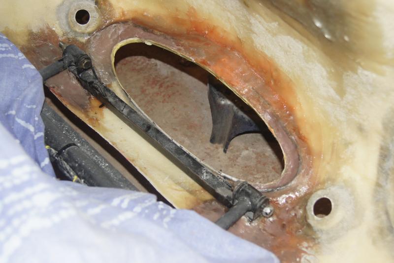

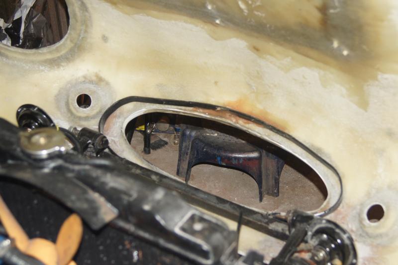

Finished making the bonnet brackets today looks good but
as always with welding thing move due to the heat and where as it all fitted perfectly before I now have gaps which will have to be filled somehow before the bonnet can be bonded into place
I did think of cutting and welding again but that could make things worst??
I couldn't get a decent photo of the bonnet in place the garage is to small but It looks too high so a bit more suspension lowering may be needed (at a later date)
bye for now
Deggsy :noidea:
