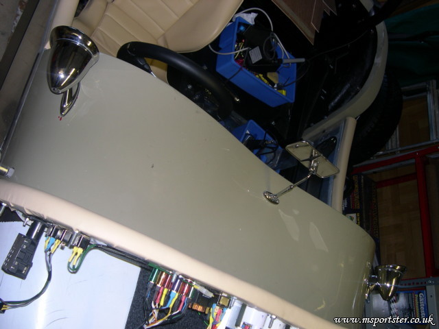

Patrick cant see what the back of your interior mirror looks like but the post i had mine mounted on falied the SVA as it has non radius edges facing forwards. I had to cover mine with some rubber to get it through the test.
27 Aug 2007, 8:50am
Stuart, it looks like this:

27 Aug 2007, 11:03am
Looks very similar to mine Patrick so some form of protection would be a good idea just for the SVA.

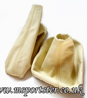

Hand brake gaiter installed, this was an eBay item made from leather, much nicer than the one that comes with the kit! Do have a nice handbrake handle but it wont pass SVA edge testing so here's a budget rubber hose item for the interim! Gear gaiter installed, may put the stainless ring round here to finish it off. Do have a nice knob to go on here, the donor ones is broken and wont stay on anyway.

Gear gaitor now completed properly. Handbrake gaiter, this has the original E30 rubber cover (top part of rubber only) underneath so there''s nothing sharp to cause an issue at SVA.
