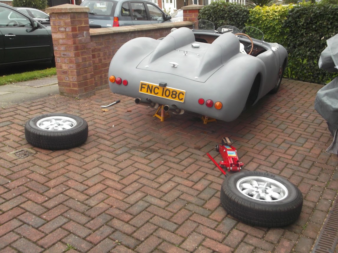

Today started well enough as I fired the car up before I started to work on it.
The back end of the car slipped down the driveway a bit when I jacked it up to remove the wheels.
But I didn't thing this was a problem, as I have worked with the car being at an angle before.

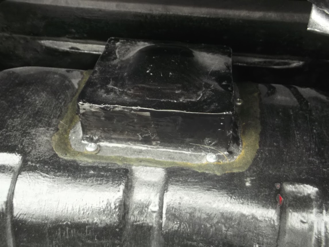

Unbolted the ends of the rear spring.
Removed the boot lid to get access to my Frankenlid.
With that removed, I could get to the studs.
And the second nut trick helped me remove them.
At this point there was a slight technical hitch…
As there wasn't enough room to pull the spring out with the lowering block fitted.
Not a great photo, but there was just about enough room to lift the spring up and remove the block from underneath it.
I was just about to pull the whole spring out, when I realised I didn't need to.
As with the lowering block removed, I just had to put the old studs back in.
( Thankfully, I'd put these in my "might come in handy one day pile". )
Unfortunately, this was a lot easier said than done.
After an hour of fiddling around, I still hadn't managed to get a single stud fitted, which was quire frustrating.
Little did I know it was all about to go horribly wrong…
In an effort to line everything up, I'd tried bolting the passenger end of the spring in place to see if that would help.
Then I was on the driver's side pulling at the spring when I felt the car starting to topple off the axle stands.
Note: When my uncle came over from American, I had tidied all my planks of wood away at the bottom of the garden.
So today, I had just grabbed a couple of axle stands to support the car instead.
The key point (with hindsight) is that the car is now a lot heavier than it was the last time I used axle stands.
Thankfully, I was able to put my shoulder against the car to keep it balanced while I reached for the car jack.
I managed to get the hydraulic jack in position and pump it up until it was taking the full weight of the car.
Phew!
I think I was so relieved that I had averted a disaster, that I wasn't really thinking straight.
As, by now, the back end of the car had slipped still further down the driveway.
So I decided to shove the car back up the slope using the wheels on the jack.
Again, I've done this before, but (with hindsight) usually there were four wheels fitted to the car at the time.
The car was on its way back up the drive when the jack got caught in a driveway paver and stopped, but my shoving didn't.
Then, in sickening slow motion, the car slipped of the jack and came crashing to the ground. :icon_sad:
I could see the jack crushing one of the twin silencers and my heart sank.
I had to use a scissor jack to get the car up high enough to remove the hydraulic jack.
But it then went from bad to worse as I stupidly tried to straighten the car again.
I made a point of being really careful this time and had roped in my wife to help.
Watching the car fall off the jack for a second time was almost too much to take.
This time the jack clipped the other silencer and attempted to hold the car up using the boot floor, which obviously buckled with a sickening sounding crack under the strain.
So once again, I had to scissor jack the car up and re-group one more time.
I couldn't put the wheels back on, as the rear spring was still loose and that might cause even more damage.
So this time I used a big length of wood under the jack as I tried to more the car for a 3rd time.
By now, I'd also got the planks of wood from the back of the garden.
Finally the car was straight and resting completely stable on the wood.
( Photo taken after I started packing up. )
This is one of my, now squashed, axle stands.
To be honest, I couldn't bring myself to take any photo of the damage, as it was just too upsetting.
Ironically, I was removing the lowering block to stop scraping the new silencers and now they both have dents in them.
But the boot is much worse, as it has been caved in slightly, which in turn pull away the joins to the body shell.
I spotted damage to a small area on the inside edge of the driver's wheel arches.
Although I really need to come back with a clear head another day to check the whole area carefully to get a full damage report.
However, for today, I just packed everything away and put the cover's back on, as I really couldn't face it.
Now I know everything can be repaired, and as my wife said, it could have been a lot worse if I'd been under the car! :eek:
If I can bring myself to face it, I might try to finish off the rear suspension work tomorrow, just so I can refit the wheels.
But as I type this report up I realise I have a lot of aches and pains, so I have clearly strained a lot of muscles trying to save the mess I made.
So until then, take care, Paul. :)

But before I started, I thought I'd better take a proper look under the rear of the car…
Damage Report:
Remember I was removing the lowering block to avoid scraping the edges of the silencers…
And now I've ended up with dents in both of them instead. :rolleyes:
An axle stand took a small lump out of the Tetroseal on the underside of the boot floor.
The black 'circle' was a small fibreglass repair that was dislodged & the red metal 'hole' is where two original Spitfire panel were pushed apart. :icon_sad:
A large 'crack' opened up on the underside when the boot floor was caved in.
It is not easy to get a decent photo of just how dented the inside of the boot floor is on the passenger side.
( Another fibreglass repair was dislodged in the centre of the boot, near the drain hole. )
There was also a chip taken out of the rear driver's side wheel arch.
So, overall, nothing that can't be fixed. :pray:

My main priority for today was to get the rear spring fitted and the wheels back on.
It took absolutely ages to line up all four studs and get them fixed back into position. :rant:
Then the spring could be reattached to the hubs.
Before the wheels went back on loosely.
They were then tightened up after the car was jacked up, wooden blocks removed & then car lowered back down.
The only repair work I did today was to bash the dented boot floor roughly back into shape with a lump hammer.
This definitely made a difference, as the gap underneath has closed up quite a bit.
Then it was time to head out for a short drive to help settle the suspension.
I didn't get far before 3 of my 5 gauges were all steamed up. :rolleyes:
But at least the car seemed to be running OK, although I can't decide if the exhaust sounds different.
I made one stop for some photos to get a basic idea of how the back end now looks.
But my plan is to take it out for a longer spin another day, before re-tightening the spring bolts and fitting the Frankenlid cover.
Then I will go back to the Sainsburys' car park with my tape measure to check the new heights properly.
There was just time for a quick photo next to a Figaro.
Before heading home and putting the covers back on.
