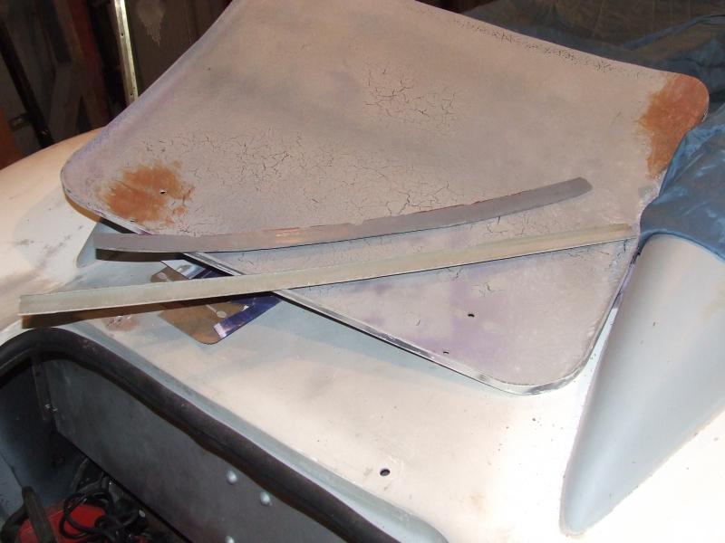

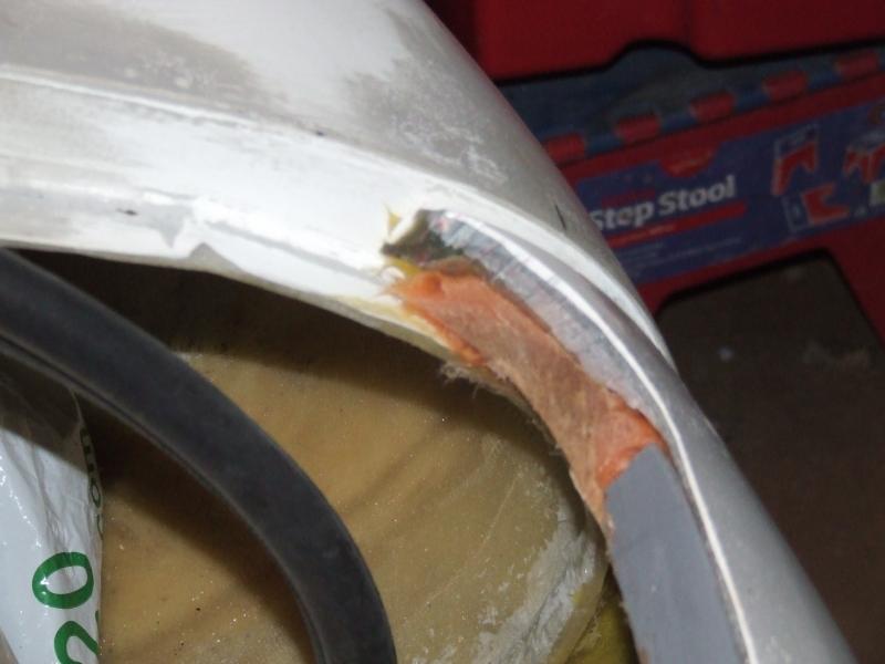

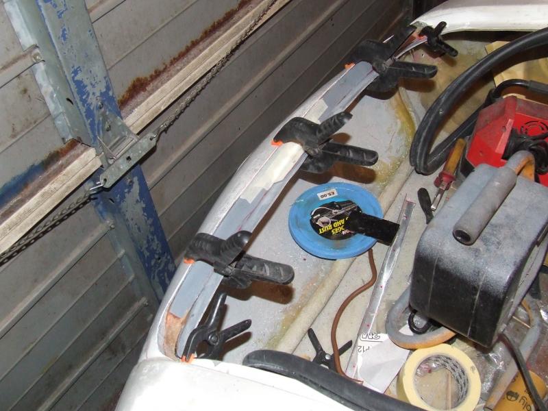

15 Oct 2016, 8:21pm
Started on the doors a friend has a metal shrinking machine and our first attempt at bending the angle alloy the wood is some beech hardwood for the passenger seat to raise it to the same level as the drivers one which has runners.
[IMG][/IMG]
The errant lips have now been cut off the doors which will have to be reinforced along the top edge then filled and sanded before taking them back to my friend to get the angle to a good fit I hope.
[IMG][/IMG]

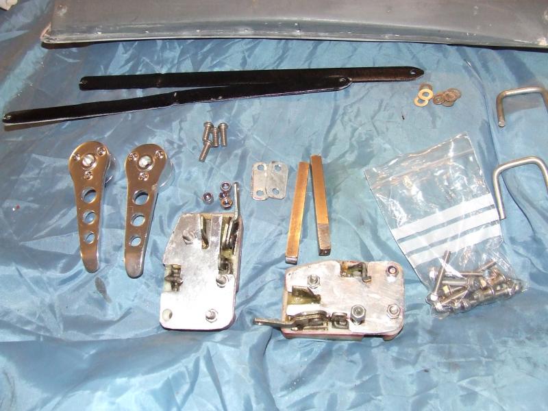

I also managed to get some door latches very cheep off flea bay, they are off a mini and should do the job nicely I will have to make some locating pins as they didn't come with them the leavers are actually the locking arms I could use them as openers or try to make some?
[IMG][/IMG]

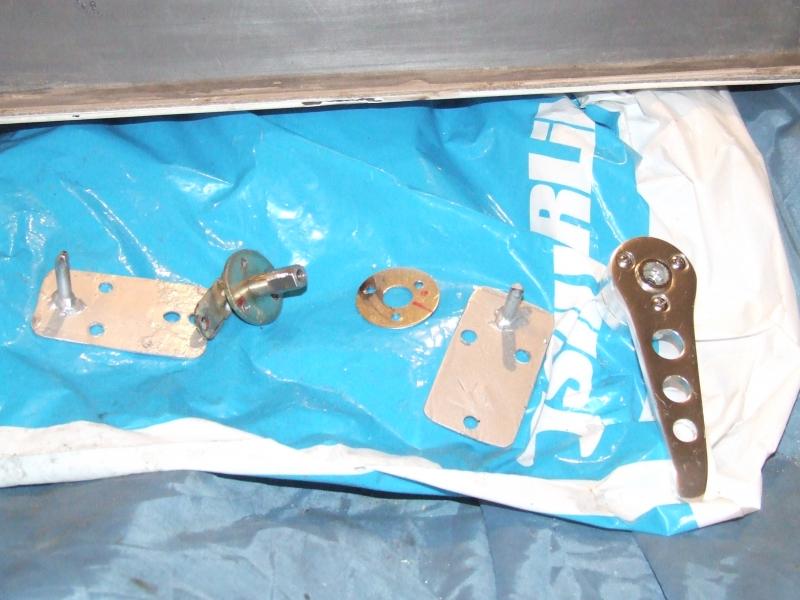

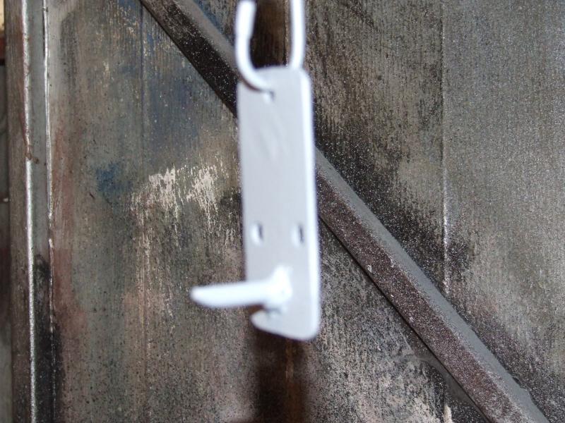

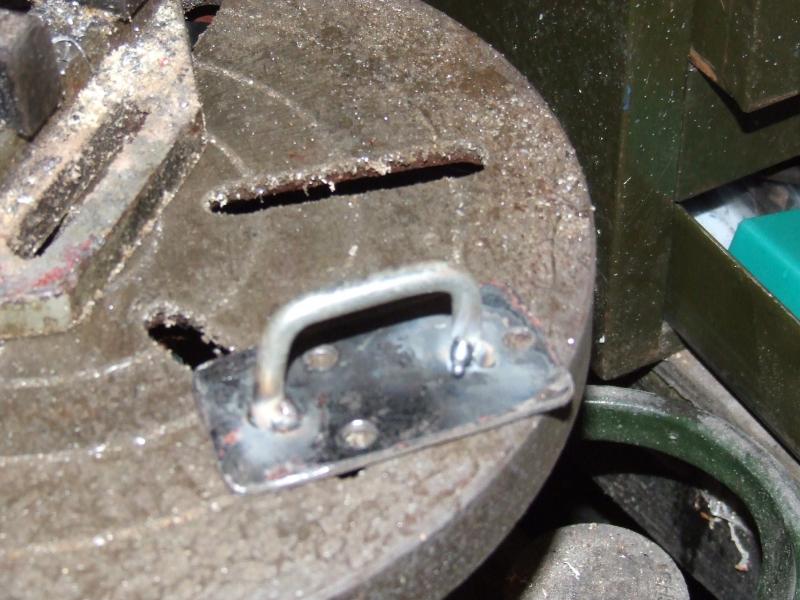

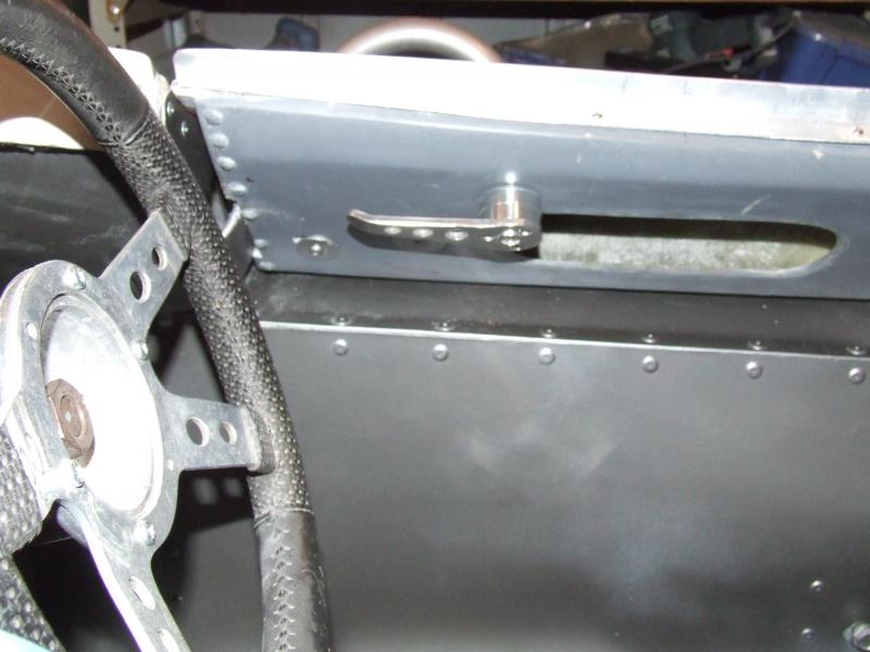

I cant believe the time and effort it is taking to make these door mechanism's, this is the first effort to make the striker pins but they wouldn't lock something to do with the bends I think?
I ended up with this but will probably change them as I may catch my clothes on them.

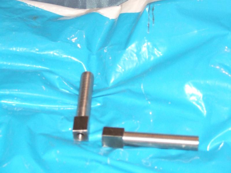

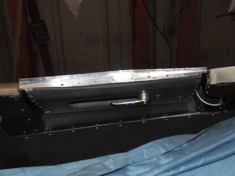

my tool maker friend Paul R turned the handle spindles for me
I have welded the lugs on with a 5mm thick washer as a bearing
and it will look like this when finished
or like this
as the doors only have a single hinge they tend to drop a bit (lot) so I have to make some sort of alignment thingy??

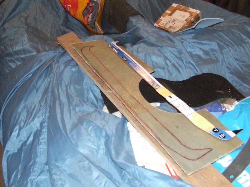

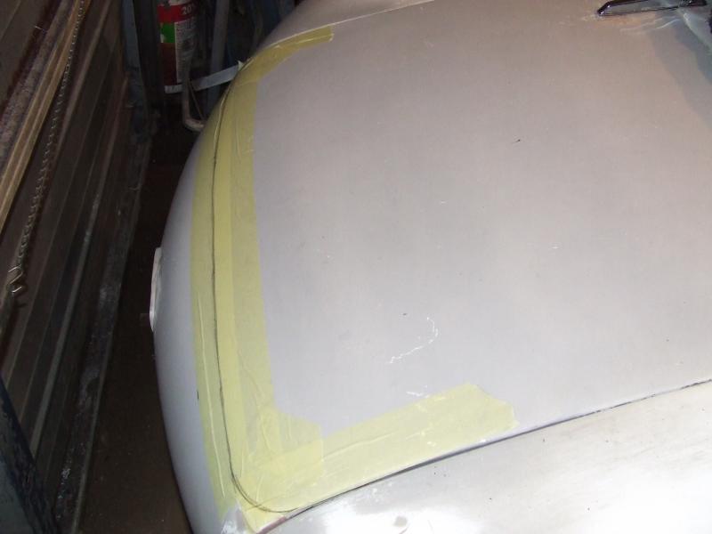

I am considering doing a Scottie on the boot lid and have marked it out ready for cutting Pros more usable boot space moor manageable boot lid and easer to make a locking system. Cons an awful lot of work
15 Nov 2016, 12:50pm
Well I took the plunge and cut the boot in in half if it all goes wrong I'm blaming Scottie It was his idea and I'm just being a copy cat!!
:flame: That's my excuse and I'm sticking to it.
28 Nov 2016, 7:12pm

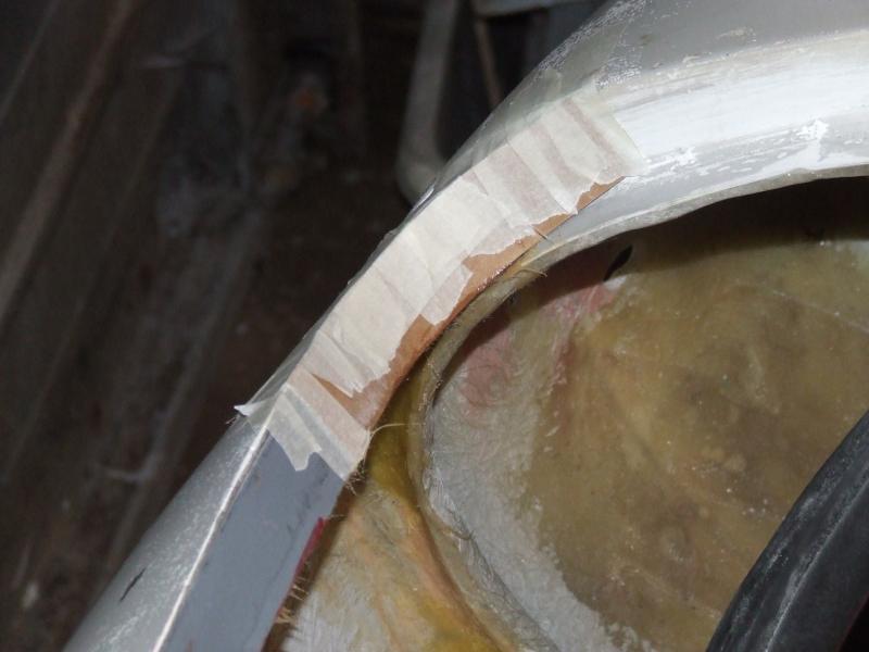

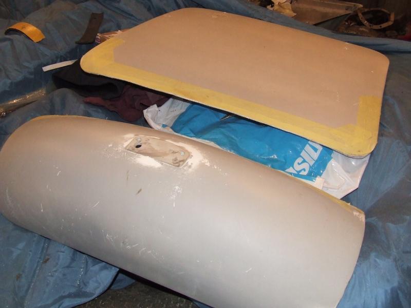

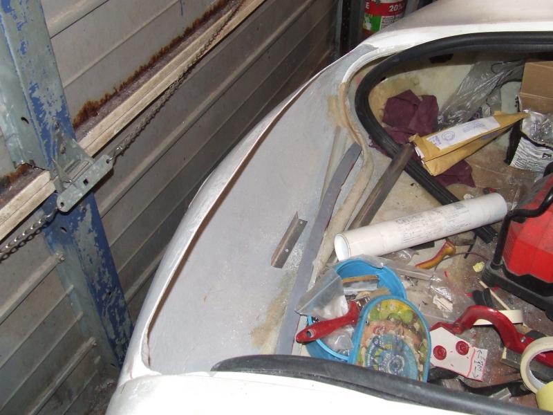

This is the bottom half of the boot lid being glassed into place
28 Nov 2016, 7:27pm

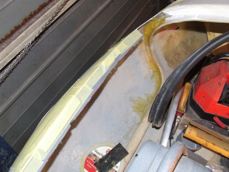

cutting the first lip out of glass fibre sheet
and the lip glassed into place
The corner sections are were made by simply taping a strip of card to the right profile and back filling with fibre glass paste again.
It will all be filled in later
The lower lip marked out ready for cutting but it was getting too cold in my tin shed to continue so Ill have a go at that on Wednesday with a bit of luck till then tata for now :drum:
1 Dec 2016, 5:31pm

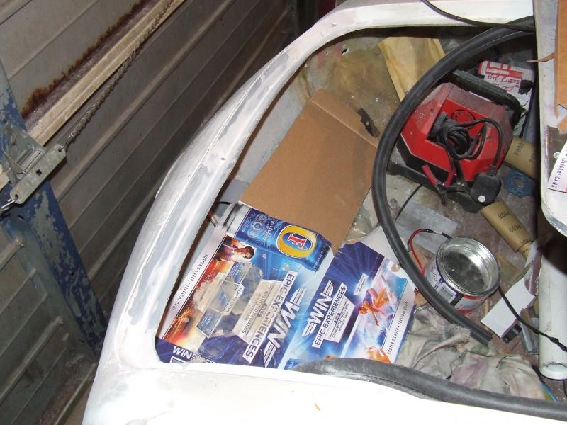

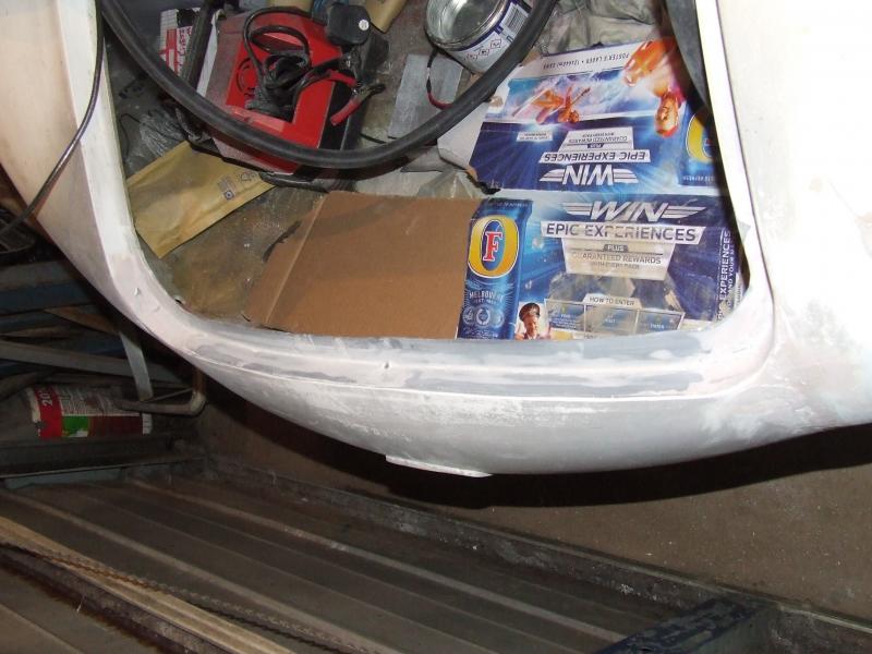

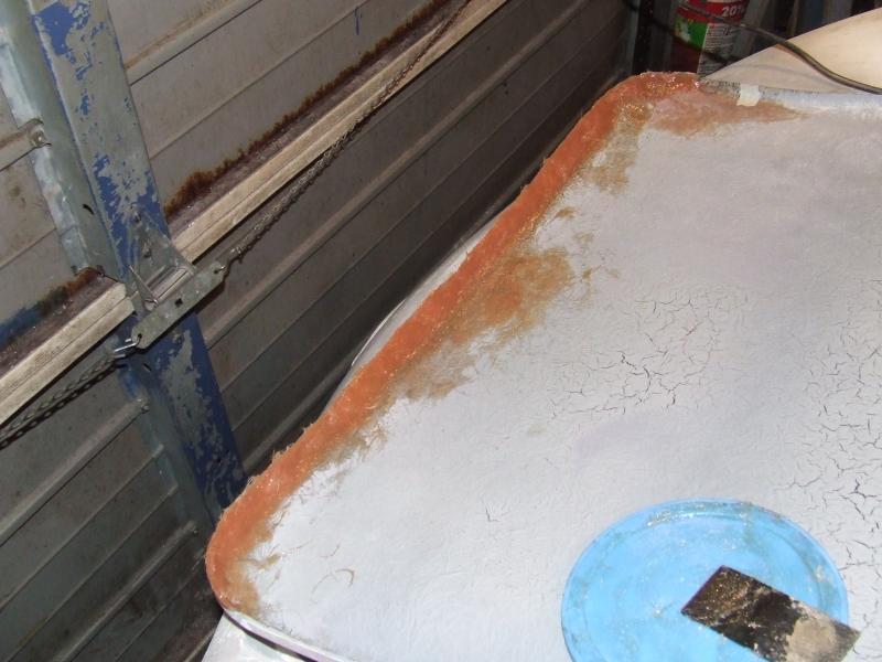

I managed to get some moor done yesterday I cut out the lower boot lip clamped in place and glassed it in.
much filling and sanding later.

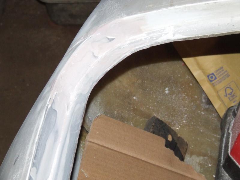

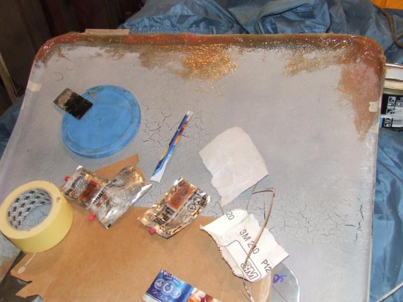

I then decided to do the boot lid lip :icon_eek: it should have been quite easy a card strip taped in place and back filled with glass paste
but it was so cold it took over an hour to set and it sort of bowed a bit
a bit of sabding and filling to get it right:shocked:
