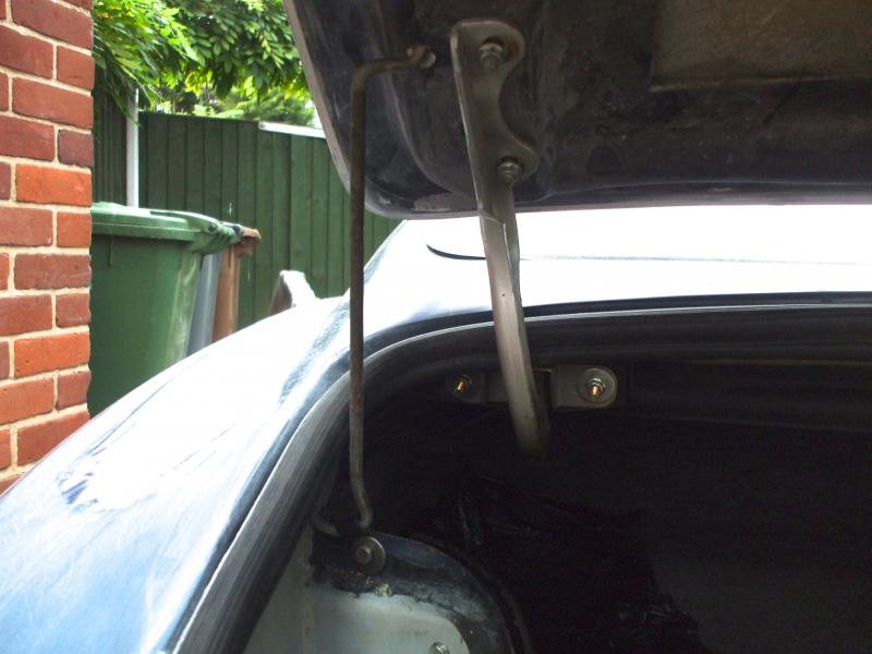

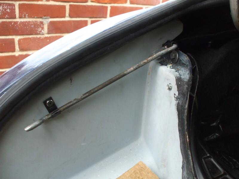

I've made the boot stay, which works well, using a cut and bent bonnet stay and a few bits I had lying around. Not much to look at but when the boot's all tidied, painted and carpeted it will look fine.

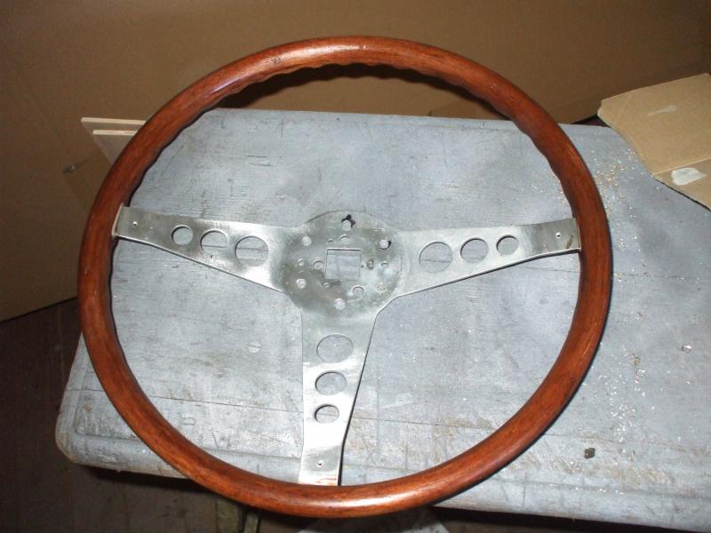

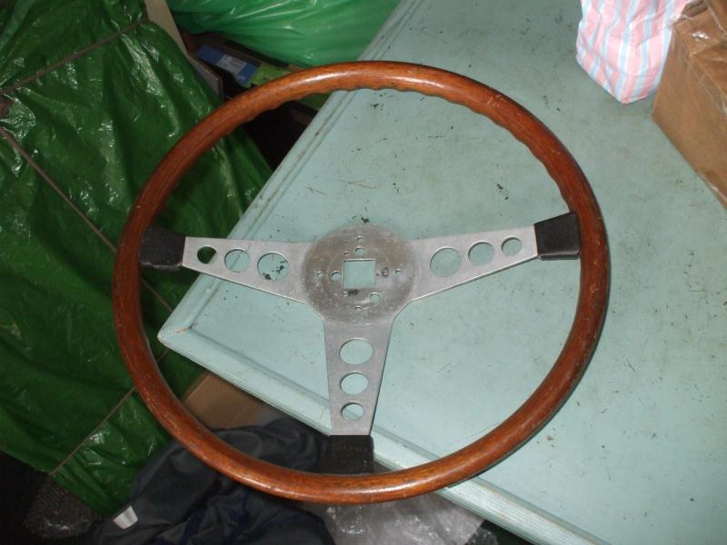

I've bought yet another steering wheel. The first was when I was going for a more modern look, so that was sold again. The one on there now is a nice wood rim but a bit modern looking and being 13" it nicely blocks out the indicator warning lights, which as the boss doesn't self cancel is inconvenient.
This one is an old 15", much more suitable and when I've drilled it for the boss, cleaned and varnished it and made a centre cap, should look fine. Just the sort of small fiddling about job I enjoy.

I've started restoring the new steering wheel which I hope will look good when done. My original wood rim will be for sale eventually for £30 if anyone's interested.

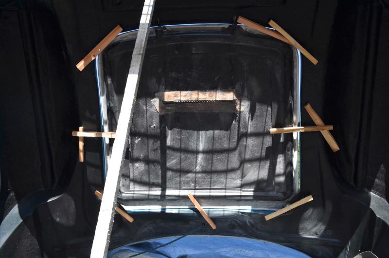

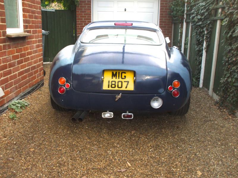

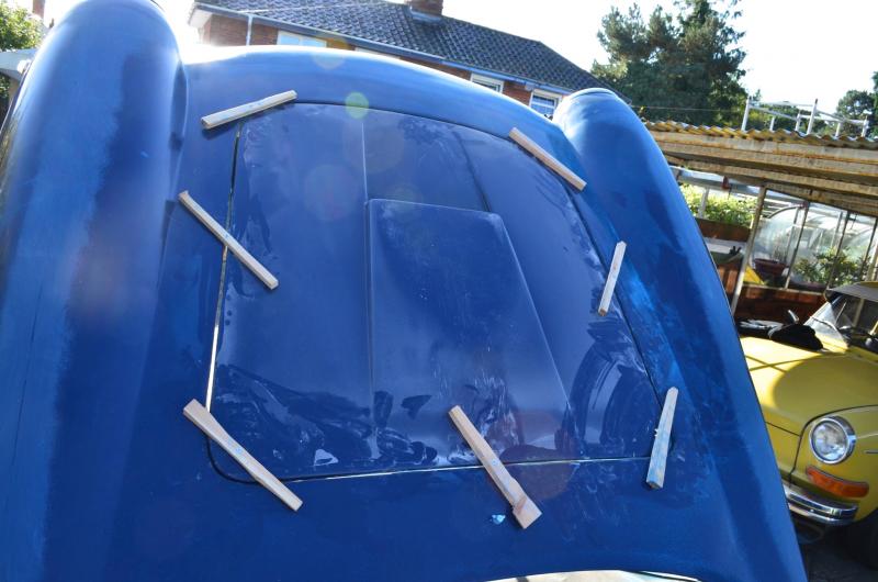

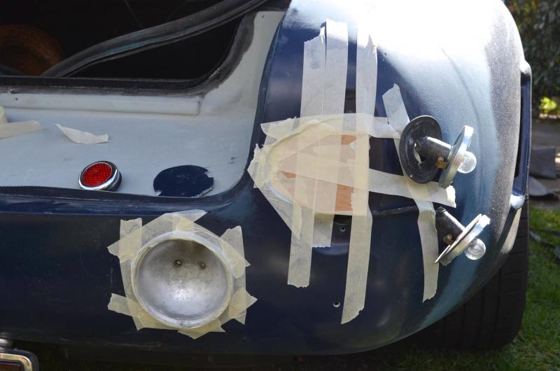

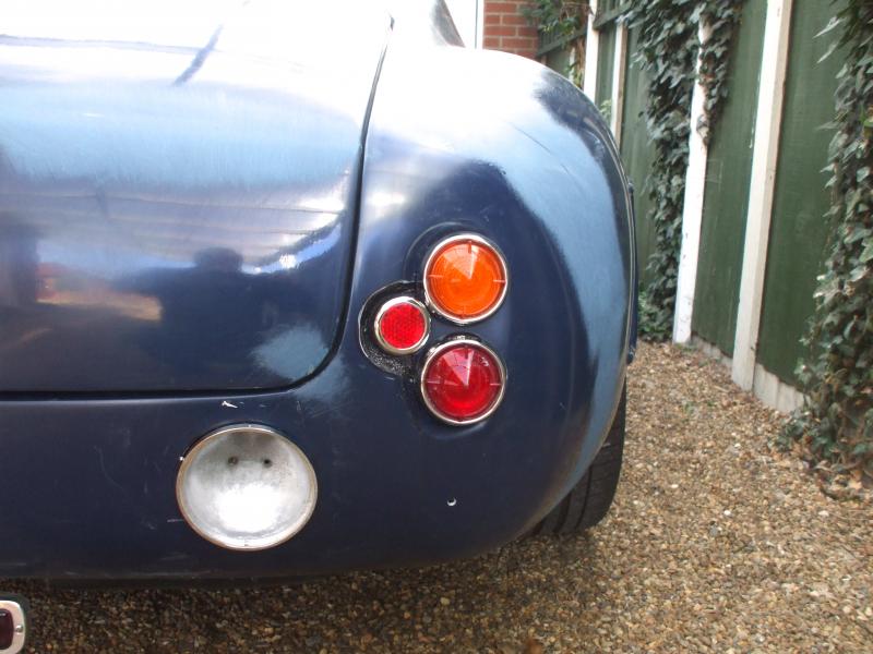

Today I've been at a mate's (Thanks Graham) having some fibreglass work done. Finishing off with a little filler is still needed but I'm pleased with how it's turned out so far.
The bonnet was fixed in place and adjusted with wooden wedges to get it and the surrounding panels reasonably level. It was then fibreglassed in place from the rear but leaving a groove to give the impression that the bonnet still opens. An idea which came from Andy (Ericholm)
The rear reflectors have been relocated in a cut out next to the rear lights. I hope the new cutout will with flow with the same curves as the original light housings when finished.
A spot light has been set into a mould in the rear panel which will be the new reverse light. (the original rear fog light will later be relocated out of sight).

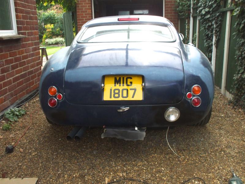

26 Sep 2015, 6:00pm
WorldClassAccident wrote:
Your drive needs weeding but the rest looks good
I'll tell my wife what you said about her geraniums and tell the blackbirds, that nest in the ivy, about you as well.
Expect a visit!!

Great work Bob!, great to to see how you aligned the small bonnet, and the reflector aspects look great also! The back end of your car looks really wide compared with mine. it looks like yours is on steroids :first:

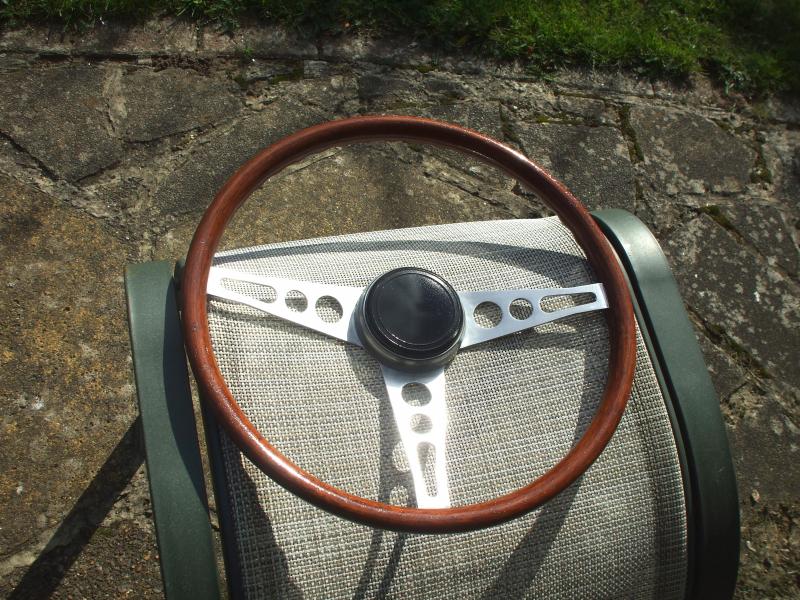

I've just finished the steering wheel. Not a perfect finish, but I didn't want one as the car is supposed to look like an old road racer with some history.
I've altered the holes in the spokes to loose the small holes where the pads were riveted on. (The shape is nothing to do with any poor measurement when I first drilled them. Oh all right, it is). The centre cap is the surround off an old Lucas rear light lens and a bakalite middle, both of which I found in my auto jumble stock

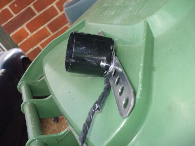

This is a racing car wet weather light which was very cheap on ebay (second hand) which I mounted on a bracket which will be fixed across the corner f the roll cage. It will replace the rear fog light. I may fit a cheap hidden swing down one inside the rear panel incase there are issues at MOT time.

Nice one Bob!, steering wheel looks ace! :icon_cool:
How are you going to get the horn working on that wheel?

I've just had number 1 coil pack replaced. The mechanic said it was damp around it. I've had the car out in some very heavy rain in the past and wonder if the gap around the centre bonnet may have let water in which has gathered there.
Not a problem for me now as the bonnet is sealed but possibly, for those that prefer to keep it as opening, worth sorting a rain gutter/seal.

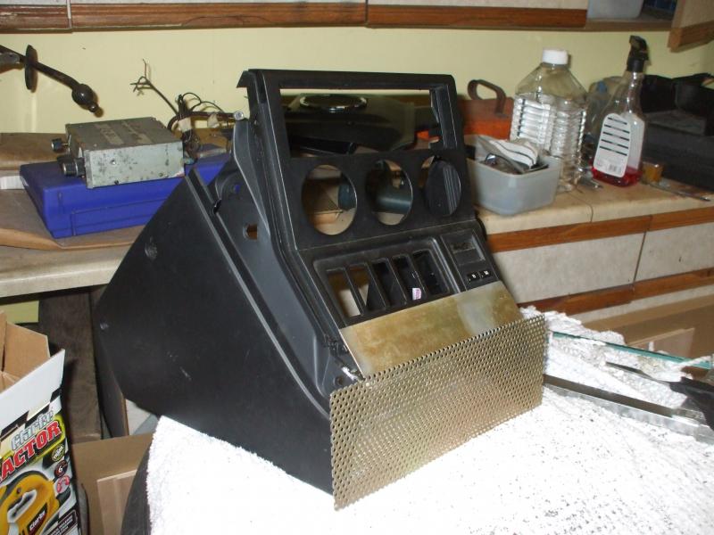

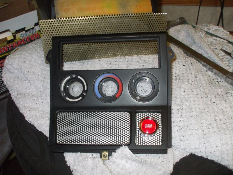

The current little project is to make the centre console a bit different.
I've checked what Geoff is doing and adapted his idea.
The heater panel now has mesh with an alloy backing with the horn (start) button where the clock was and the other panel will have 3 flick switches and the socket for the sat nav fitted.
The shortened console will have the mesh fitted at the bottom in a form that's not fully decided yet as I tend to make it up as I go along.
