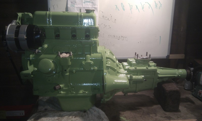

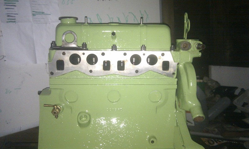

Ancillaries to go on this week (Tuesday?), and as soon as I get my flywheel back from having its new starter ring fitted I can bolt on the gearbox. Then will come the ceremony of dropping them into the chassis. Possibly next weekend......and then I can start building a bl**dy Sammio.
The eagle-eyed among you will notice the fuel-pump blanking plate (from Rimmers). I shall be using an electric pump.

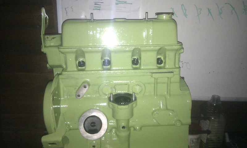

A few more hours this weekend. I'm just about where I planned to be.

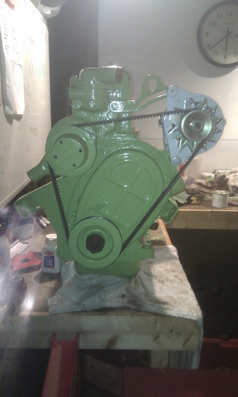

From this pic you can see that the fan belt is too long. I ordered a Spitfire Mk IV item because I had switched to an alternator. Stupid me; the dynamo/alternator pulleys are very similar sizes, but the crank pulley on a Mk IV is much bigger than a 13/60....hence the belt is too long.
The pic also shows the problem of having gone too green. The alternator stands out like a sore thumb. Might just flat-off the plastic back-casing and give it the treatment.
Spot the really embarrassing item above.......yes, once I'd spun the oil filter on it just looked too white so I flatted it off and gave it a coat of green.

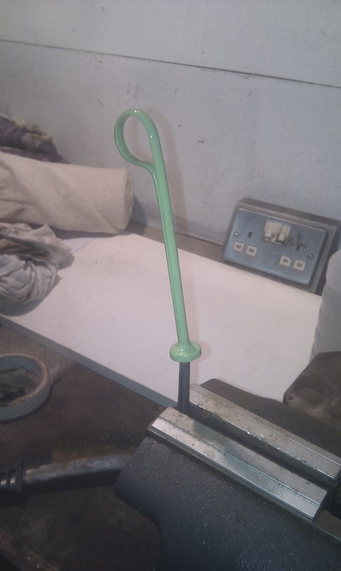

And, of you think that is bad, this takes the biscuit. The obsession is now out of hand.
I don't want to fit the distributor just yet as I will probably damage it when I lift the lump into the chassis...........which should be this week.

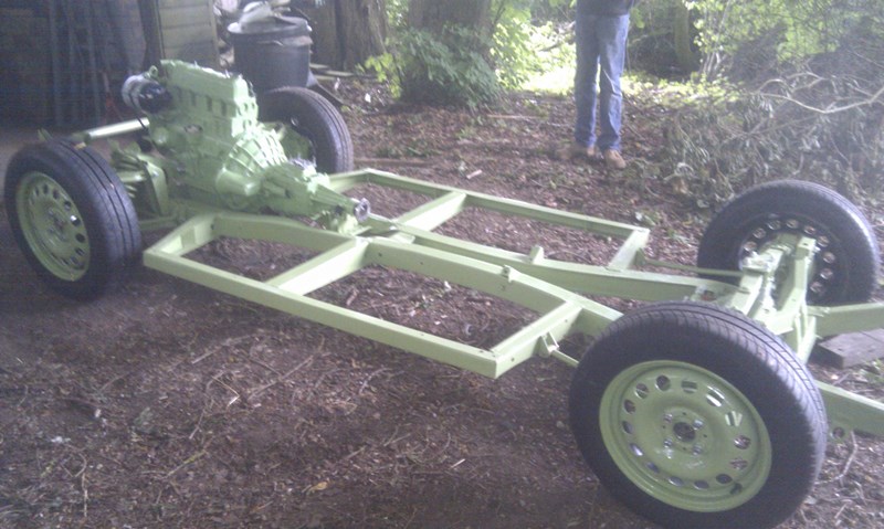

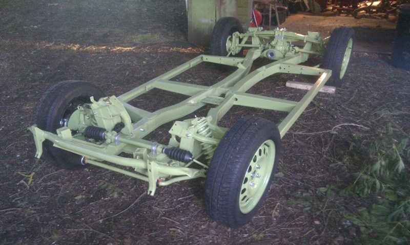

Pictures.......
They say that a picture speaks a thousand words. Well, two of those are "f*****g hallelujah".

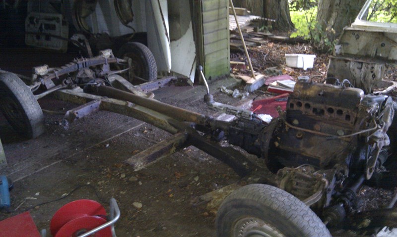

And, just a little reminder of a year ago.
"Operation Floorpan" should begin next week.
I'm very pleased with the ride height. The front of the siderail sits 1.5cm lower than the rear which, in my book, is perfect.

O, looks amazing... those wheels are going to look great. Have you squirted an waxoyl into the chassis?

Gary - thanks - Waxoyl is on my "to do" list before the floor goes on.
V - I know what you mean, but I'll still know what is underneath. I've always liked that Triumph promotional picture of the chap sitting on a Herald rolling chassis.
