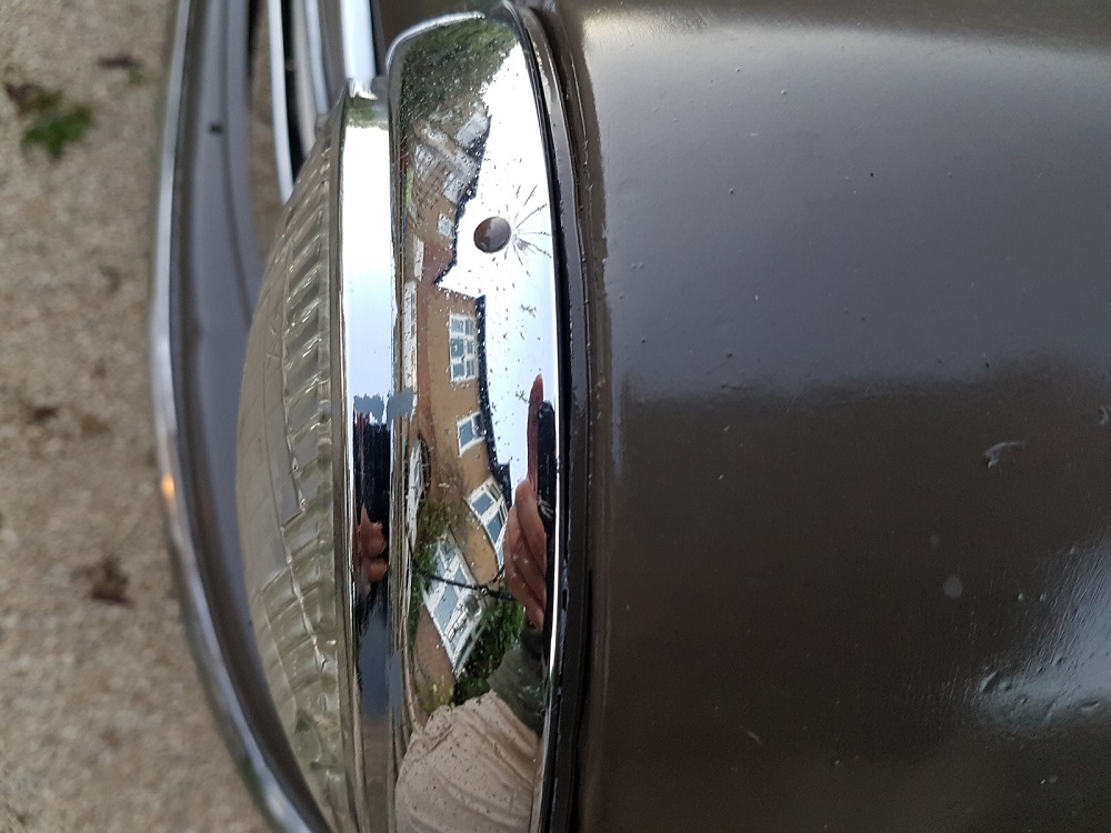

Headlight Grilles:
After another trip to IKEA today and yet more flat pack building, I got a chance to play outside.
Now the headlights are pointing in the right direction, I can finish them off before the MOT re-test.
Before:
Then 3 small brackets are screwed into position where the headlight is clamped to the bowl.
( Sorry for yet another poor photo. )
Then the outer headlight rim is fixed into position with a small screw.
After a lot of trial and error, gaps in the grille finally lined up with the fixing brackets.
( Which are then bent backwards to hold the grille in place. )
Driver's side:
Passenger Side:
[color="red"]Question?[/color]
- Is the rubber seal supposed to sit between the outer rim and the bodywork?
- Or is the rubber seal supposed to be "tucked in" the outer rim?

Paul, my '68 Minor has the same headlamps. You can see the rubber -
29 Aug 2016, 8:58pm
Oxford – Thanks for the photo, it is good to know it is OK. :cool:
