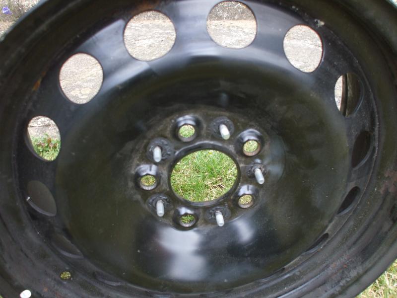

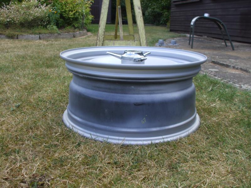

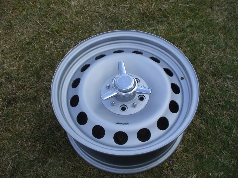

The bolts have now been welded into the small holes in the wheels and the backs sanded smooth.
The first of the spinner towers and wheels sprayed a flat silver and the Campagnolo sticker fitted. Just need a coat of satin lacquer over them.
3 more to go then get some tyres for them.
I originally thought I'd have them blasted and powder coated but to keep costs down, stick with my 'old race car' plan and mindful of my wife's words "don't build another show car because you won't use it much if you do", paint will be fine.

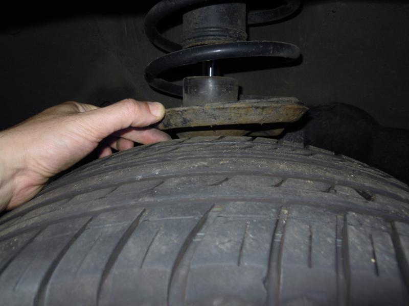

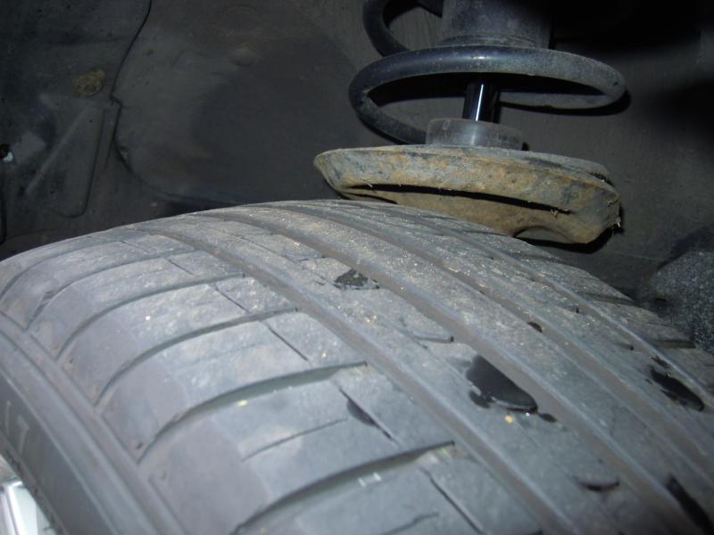

Very nice Bob, Iv'e got my spinners on order, due to arrive any day now and a fixing method I have devised once I had slept on it, like you suggested, however I have a front wheel issue in terms of height availability from centre of wheel to bottom spring mounting plate, the only way I can think of clearing it is by having a 2" spacer but this would not be an ideal solution. Of course to fit a high walled tyre on 235/65/17. Any other suggestions welcome...... there seems to be around 5-10mm of space between it and the tread of the tyre.....:help:
Updated - Ok, after extensive research on the web for around 1/2 hour it looks like coil overs are needed and they have a smaller spring to allow larger wheel/tyre combos, however will drop the front by 20mm (TA Technix), I dont want it dropped any though :-(

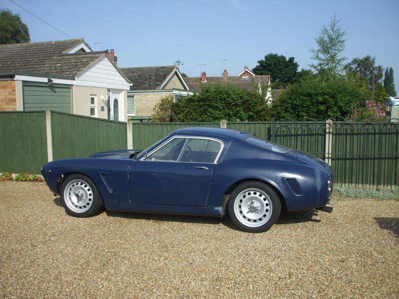

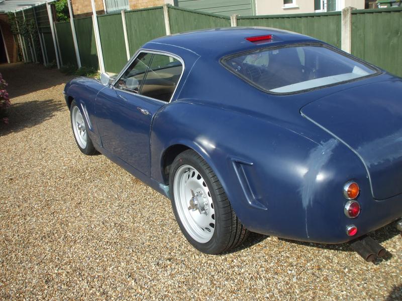

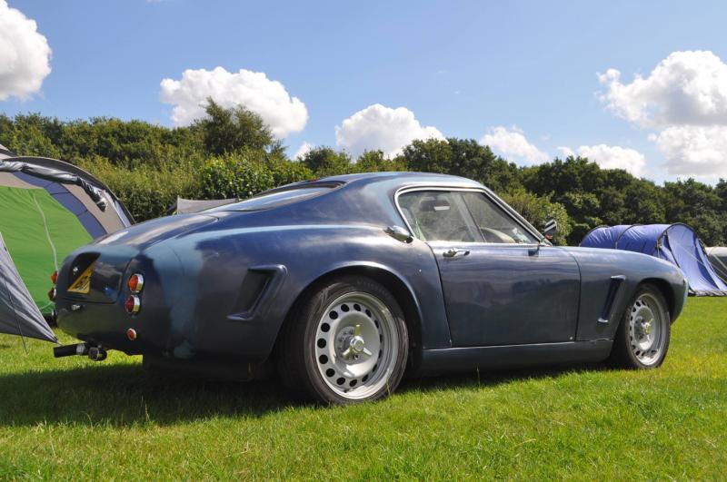

New wheels and tyres fitted this morning. A quick ride down the road and nothing has come loose or fallen off so I guess that jobs done.
31 Jul 2015, 8:57am
Bob, its looks great... When you walk round it, does it convince you that its period? What do the neighbours think are they into cars...
31 Jul 2015, 9:04am
Morning Bob , wheels look good and that colour is spot on! Geoff .
31 Jul 2015, 9:15am
Thanks for your comments gents. You're right Geoff, it's the best colour and by coincidence, the same colour as yours!
The wheels have been a big step forward in loosing the modern look. !7" wheels may still not suit everybody but that's the beauty of these cars, they are all being built differently.
My neighbours barely notice my cars as I've owned a variety of weird stuff over the years and this one is very tame in comparison to some.

I think for a period look the ride height is spot on.
Bob, how much has it already been lowered and how did you achieve that?
Steve
31 Jul 2015, 1:27pm
It's had a full Spax adjustable lowering kit with new springs & shock absorbers. It sits about 40-50mm lower.
It does need care over some speed humps but is generally fine.

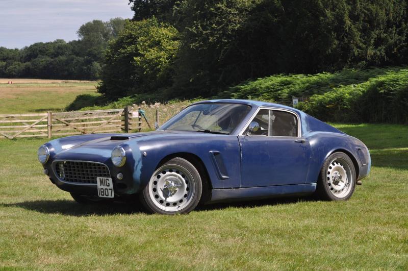

I'm just back from a long weekend at the Hot Rod Supernationals at Old Warden in Bedfordshire. A fantastic weekend of lovely weather, lovely cars and great company.
Dust was the main issue for those who like to polish but I loved the grubby look so left it on. The reception the car got was amazing. I wasn't sure if hot rodders would poo-poo it but I lost count of the number of times I got stopped and asked about it.
I'd also removed the flash lines and roughly cut out the wing vents last week.
With a couple of club mates cars
Parked up
On the way back

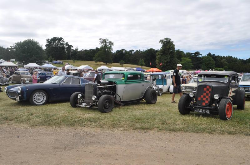

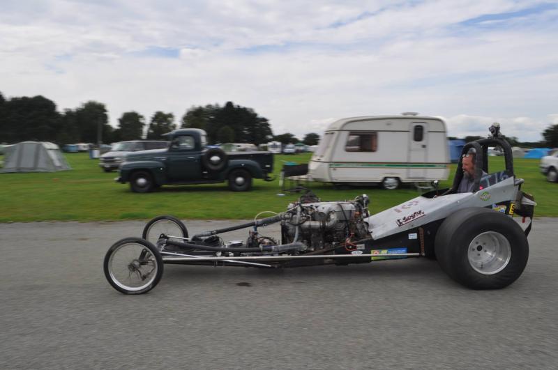

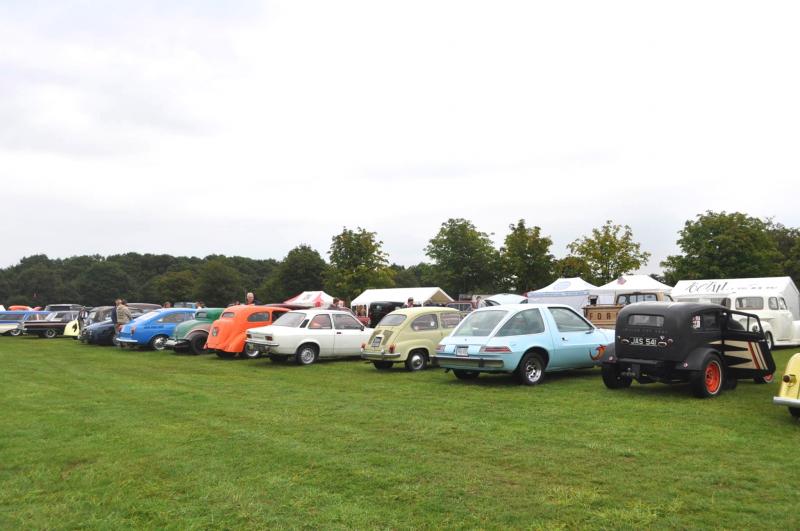

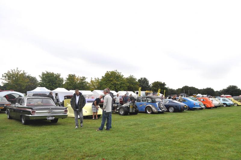

We got 12 club cars in a row on the showfield to show our eclectic mix. Everything from American classics and hot rods, slingshot dragster to VW, and a Waynes World replica to a Fiat 600.
I put a little notice in my window to save answering all the questions. It worked as I'm told the sign was often photographed.

Hi Bob, car looks great in that line up, looks like you might have dodged the rain also! Is that a Chevette I see a white one? I learnt to drive in one of those ha ha. Showing my age.
1 Sep 2015, 7:46am
The Chevette, a very rare 2 door saloon, belongs to Jack, one of our younger club members. He's the son of Keith who has the green/silver '32 coupe (amongst other things) so he's been brought up right.
Dry Friday, hot Saturday, dull but a good walking about temperature on Sunday but horrible for packing up tents and the trip home on Monday. So all in the right order really.

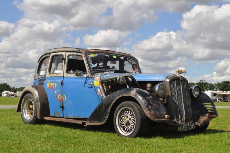

This is Pete's car. Collected last week and his first chance for a little ride. It's Supercharged jaguar powered…and very loud.
Normally he just drives this much more sensible old Morris 14.
