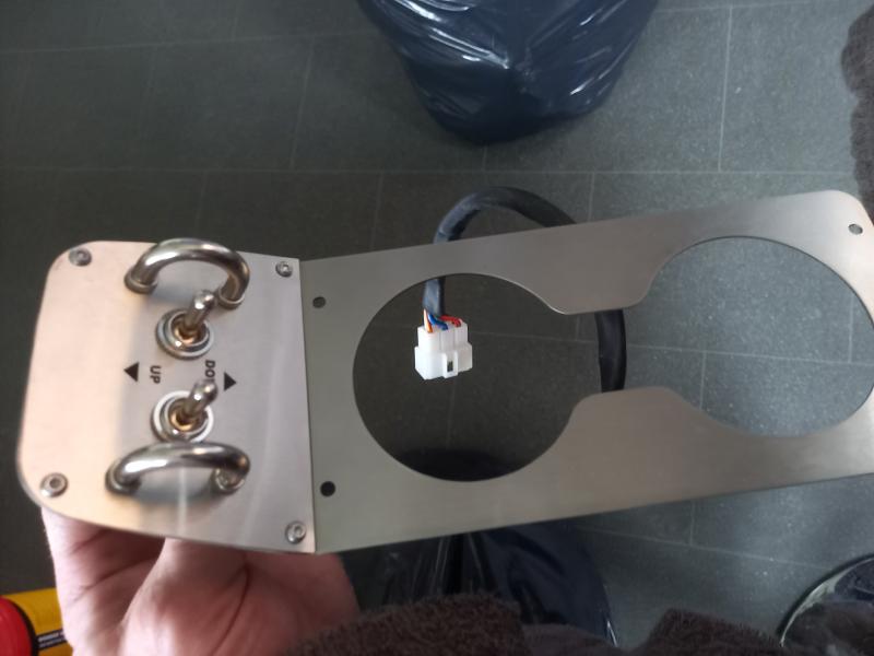

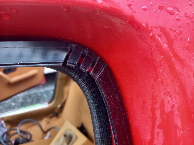

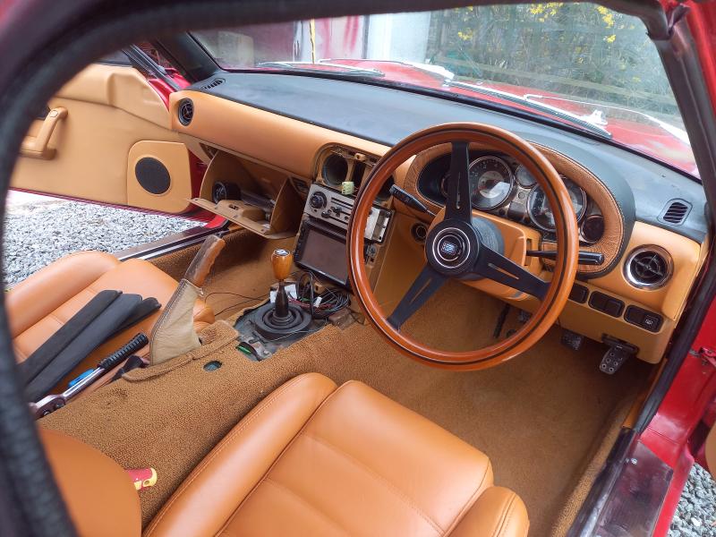

Having a go at the seal to the roof, I've used plastic upvc corner profile, to get the 90 degree seal in the position I need, unfortunately my electric window switch has given up on the passenger side down, so I've ordered some retro toggle switches
29 Mar 2021, 9:38am
New window switches, had to modify the stainless cup holder/ash tray replacement, as they only did an "all in one" blackened one
29 Mar 2021, 9:41am

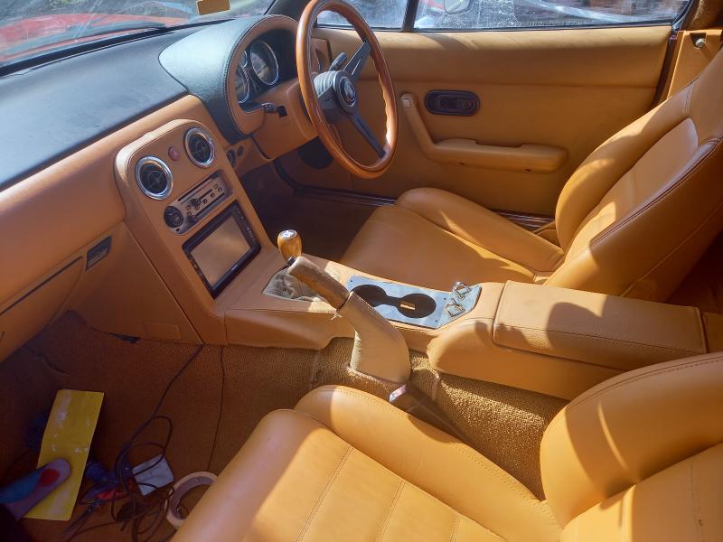

Pulled all the carpet and wet vacuumed it, tidied up the seats, painted some trim, just waiting on the leather wrap for the console and tombstone

31 Mar 2021, 11:42am
jones wrote:
Looking good, did you recover the seats?
I ended up using a nylon brush on a drill with a steamer to strip all the leather back, then recoated them with leather paint in a hvlp spray gun, really pleased with them, but long term I'm planning on getting leather bucket seats
