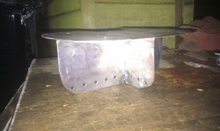

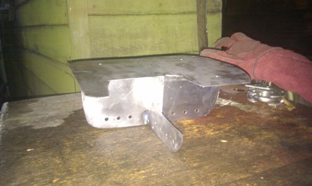

Not much progress in the last month due to work, not being well, and an Under-14s rugby tour. But, I should get some more opportunities in the coming weeks. Tonight I had my first few hours in a long time and made a sump baffle. It was quite rewarding.
12 May 2013, 11:10am
Good to see you've started again, why did you need to make one for... What are you upto?
12 May 2013, 12:38pm
Yep, it's got me baffled too. Looks pretty slick. Looks like you're surging ahead. Will it make the grade or will it be a flash in the pan? Etc, etc :drum:
12 May 2013, 1:19pm
I like your work , you are a clever man :thumb:
12 May 2013, 7:01pm
Thanks, chaps. The baffle is a little indulgence that I couldn't resist - I wanted to cut, grind, drill and weld.
Once you start reading some of the Triumph tuning manuals you feel that you should have one. And, when you look at the location of the oil pump pick-up, it does make sense.
I plan to do some hillclimbs and sprints, and while the engine was in pieces it seemed sensible.
The funny thing is, there are no plans available online and you can't buy one off the shelf. I cut up a cereal packet to build my mock-up.

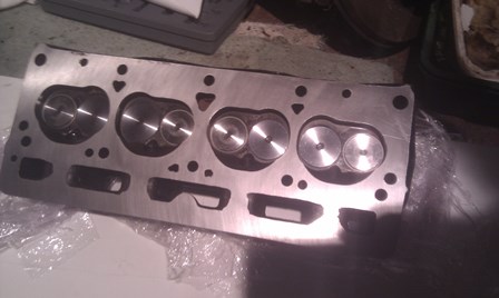

I managed some time on the engine today. It's getting there - unleaded head now bolted down.
Next job is setting the valve timing. The new duplex system has no marks so I will have to do it "the Triumph way" which is more fiddly than any other engine maker's way.
Oh, and the engine is far too black........it will be green soon.

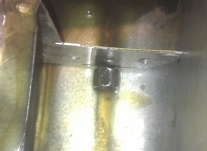

Mr T, here is the offending article........
But, but, but.........this little cloud had a silver lining. As I was undoing the sump bolts I noticed the dip-stick hole.......and I realised that I had not made a hole in the sump baffle for the dip-stick to pass through. So, much better that I realise now rather than when the engine and box are sitting in the chassis.

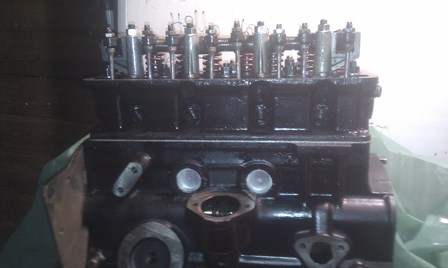

I had a good four hours today down at The Glade. The engine is together. Tomorrow it will get a coat of green and I shall add some pics.
