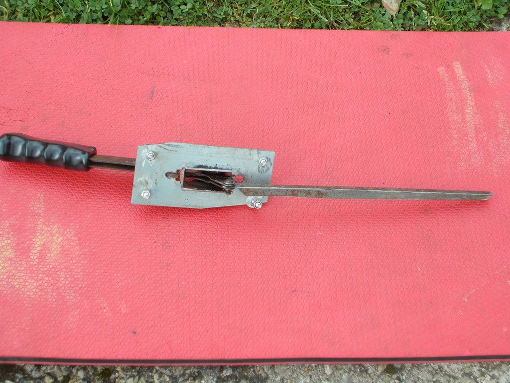

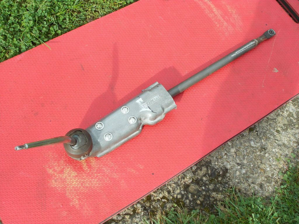

Anyway, at last my extended gear change remote, hand brake lever mounting plate and multiplier lever mounting bracket are ready for installation. I've now realised that final bolting of the body to the chassis will be almost the last job of all as being able to pop it off facilitates so many of the building tasks.

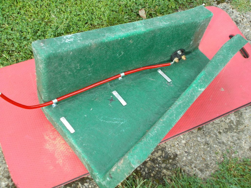

I've run the battery cables from the 'boot', through the transmission tunnel, to the starter solenoid and cranking motor mounting bolt respectively, with an isolation switch in the +ve. Working out how to crimp the terminal eyes caused a bit of head scratching until I hit on using my water pump pliers with inch box over the arms to multiply the effort. This worked a treat .
Careful measuring of the limited space for the handbrake effort multiplier lever showed that it could be used, slightly modified, as the manufacturer intended, rather than by my previous idea. The problem of shortening the primary cable was overcome by substituting a length of angle cut from some scrap box section. I've angled the mounting hole in the top of the tunnel to align said rod with the business end of the multiplier lever. As soon as a dry day comes I'll bolt the handbrake bits and gear lever in position with the body off. End of part one.

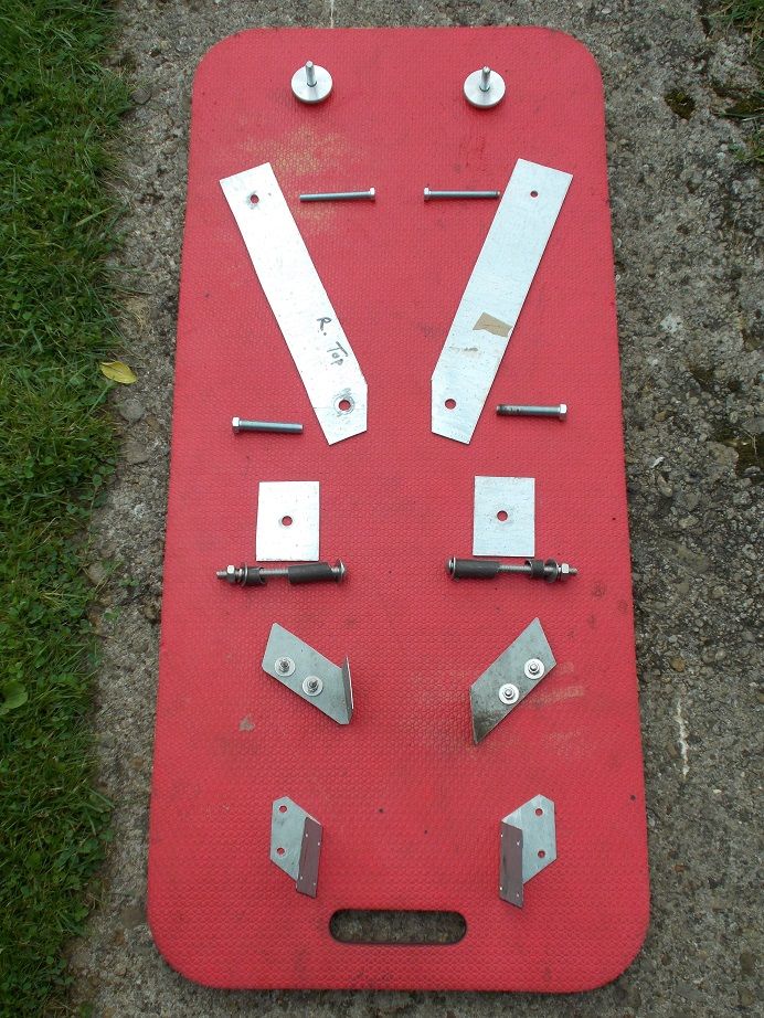

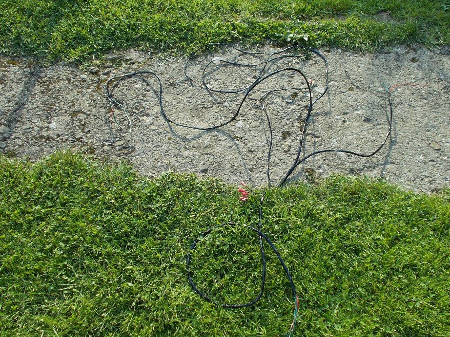

This weekend I dug out the loom which I'd carefully wound into sections secured with cable ties. Offering it up to the body revealed two problems 1) The front section for the lights and indicators is missing. This isn't a great problem as 'Spitfire Steve' can bring me one when he drops off my stainless steel exhaust on his next foray up the M5. 2) The rear lights and indicators, being wing mounted, will need their cables routed along the wing stays. Offering up the brackets supplied revealed that, not only are they substantially over-engineered for the lightweight GRP wings, but they're designed for bolting to some other style of chassis frame. Scratchbuilding will be required!
Here are a few pictures of the various bits and pieces mentioned above.

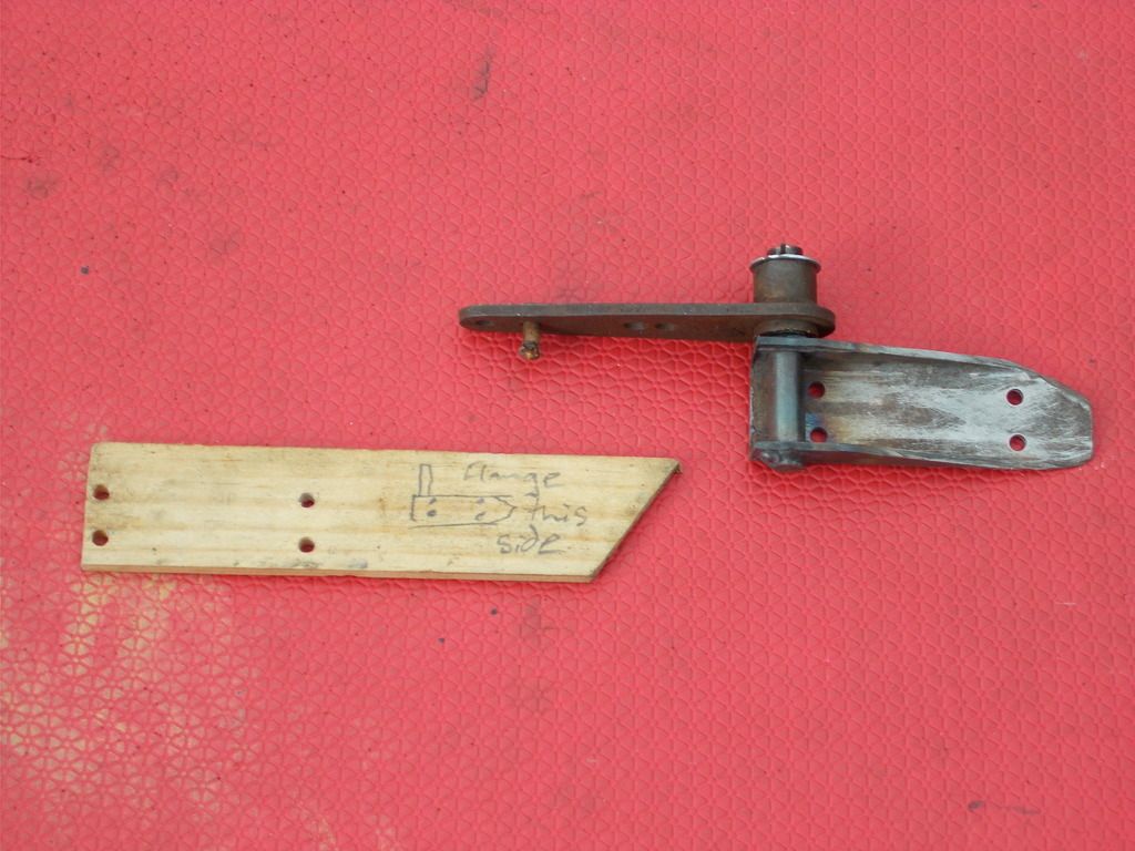

This last picture is of the modified radius arm mountings which will bolt through the floor. I doubt this will be strong enough so some sort of anchoring strap to the angled outriggers will be needed.

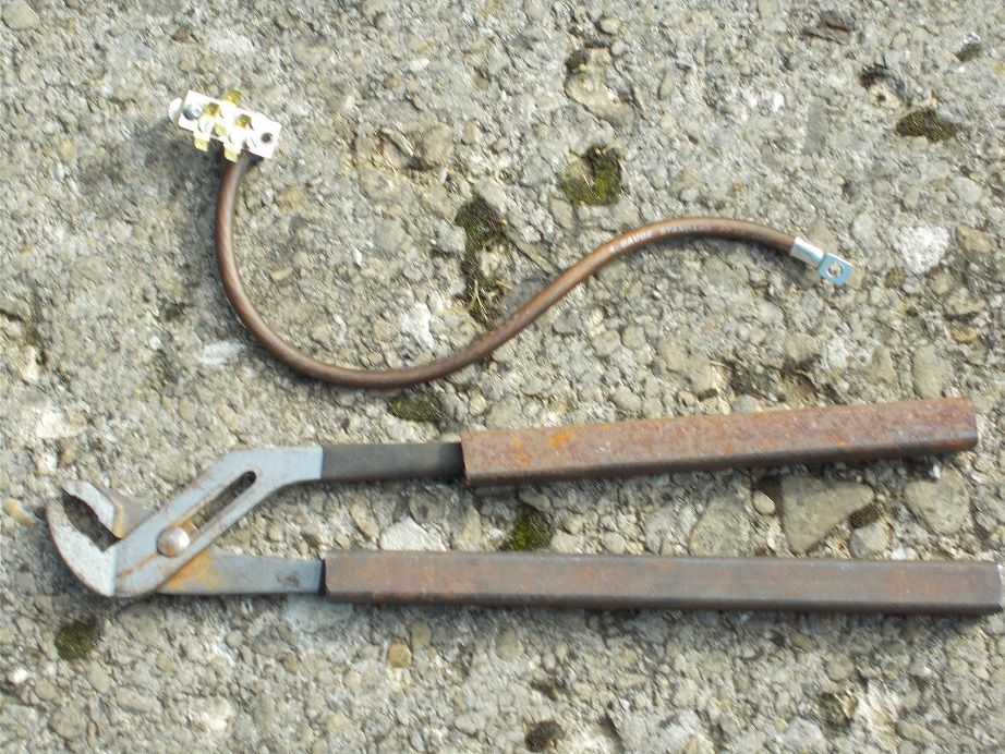

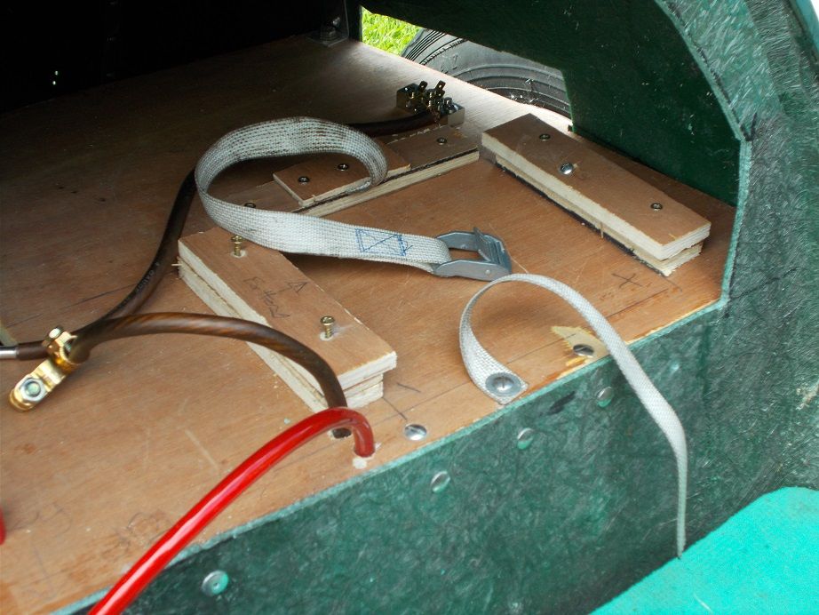

Today I concentrated (between showers) on the battery area of the 'boot'. In my box of electrical bits and pieces I found a terminal block for earthing? The screws for clamping the wires were the right size for mounting three double ended 6mm spades (from Volks Spares) to the block, the fourth clamps being used as intended to secure a spare length of 6mm diameter cable. To the other end of this I crimped an 8mm eyelet connector which will go behind the battery earth clamp pinch bolt. Once it's bolted to the boot floor just below where the rear loom will run, the six spades will provide sound and hopefully corrosion proof earth connections for all the rear electrics . The picture also shows my Heath Robinson heavy duty crimping tool.
I next pondered the attachment of the battery to the wooden boot floor. I built up stepped strips from 12mm ply which fit nicely over the end flanges on the bottom of the battery and screwed them to the floor. A similar strip is across the back. In a bag of bits which might come in useful I found some straps which originally held down BMW motorcycles in their delivery crates. I cut one of these to suit and fixed it to secure the battery fore and aft. Once the sun comes out I'll post a picture of this arrangement. It isn't pretty but it's very secure.

As Promised :)
Here's the picture of my battery restraint system and earth block. I had to buy a new +ve battery clamp when the one that matched the earth proved too small. 'I'll just lever it open a little' - it promtly snapped in half. Monkey metal! Buy cheap, pay twice

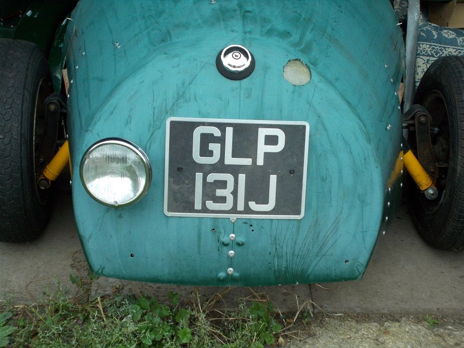

Yesterday my jumbo old-skool reversing light arrived. Down in the man cave I was eager to ensure that it worked. Touching the wires to the battery resulted in a flash which left a few copper strands welded to one of the posts. Hmmm? I drilled out the rivet (which should surely have been a self-tapper?) to access the innards and connected just the bulb to the battery. It lit correctly. Hmmm? I cleaned all the contact areas on both the bulb and its holder, paying particular attention to the area around the fibre insulator under the +ve. Bulb in holder test? OK. Hmmm? I noticed a small area of discolouration inside the bowl opposite where the +ve bulb holder would sit. Emery and acetone ensured a surgically clean area for a small square of insulating tape. I did the same to the offending area of the bulb holder. On re-assembly it worked perfectly . Interestingly, despite the lens having the moulded legends 'Lucas' and 'Made in England', the sticker on the back of the reflector was 'Bosch'!
I carefully slackened then cleaned the mounting bolts after WD40ing them, drilled a mounting hole and balanced my new toy (and number plate) in position for the shot below. The space to the right of the plate awaits a suitably distressed AA GB pressed metal badge. I also have a boot rack so the rear end of my creation will look suitably busy.
The monkey-metal battery clamp. Its replacement is very sturdy!
