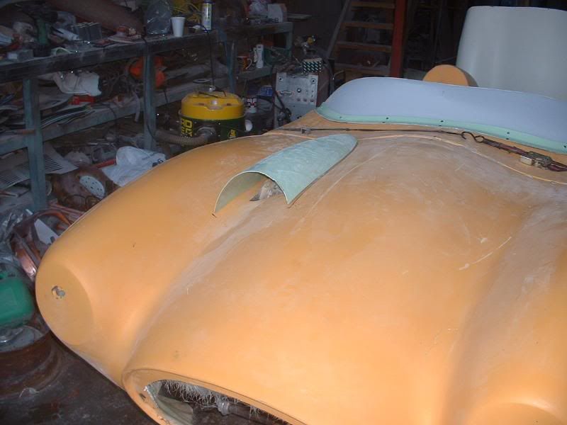

Final instalment shows the beginnings of Mikes patterning for a bonnet scoop.
We were lucky with the GT6 engine - it has been raised which I thought was going to be an a*se ache , but because it has been moved back a few inches , it has saved the day....no part of the rocker protrudes the bonnet...I thought we were going to have to fit a Phil Jacklin style scoop AND a blister for the carbs , and it could have looked a bit too busy....now we just need an asymetrical scoop for the carbs....I think it is going to look ok for it ...the tail fin , scoop and sidepipe give you a suggestion of the six cylinder thats lurking and gives the Sammio a bit of an edgy look....

bit more detail on the scoop now....Barry asked for Rivet detail on the scoop and the rear fin.
Mike has made some goor progress here.....
I like the opening to the scoop- cut back slightly with a bevelled front lip and the mounting flange...looks like it could be hand crafted ally and when its all painted in the Ecosse Blue , its going to look great...
