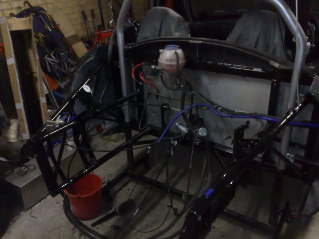

Slowly getting there........
Incidentally, the rear frame definitely needs to be welded in - out of curiousity I tried a "chest expander" style grip on the outer ends of the main chassis legs, and I could feel them flexing. I'm far from a powerlifter.

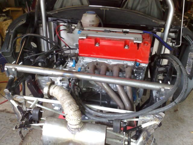

Engine in, new rear engine mount 90% fabricated, and rear frame welded in place.

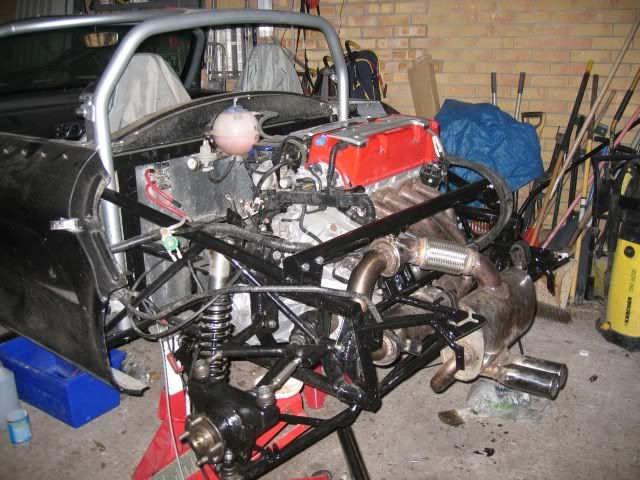

A day of grinding, welding, painting, and bolting.... and voila, the back end is almost back together. It's staggering how much time and effort it takes, even when you know your way around the car!

Nearly there John and looking a lot more industrial!!
I must ask what the little welded tails/plates are that are coming off the rear clam pivot points??
Craig
18th August 2008, 20:02
Join Date: Jul 2005
Location: Dorset
Posts: 1,180
Hangers for the diffuser.

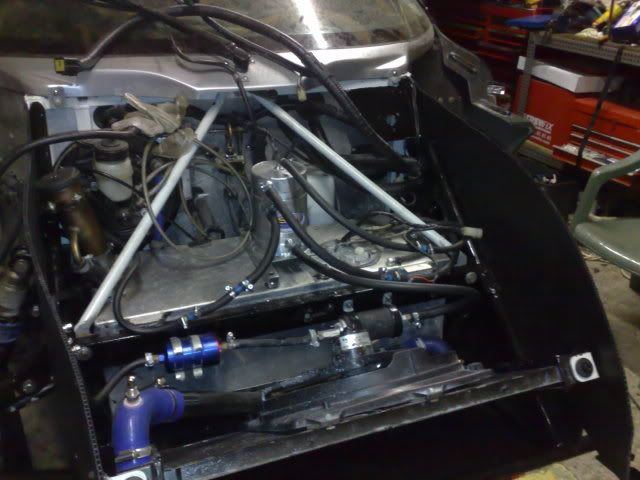

Function is heavily dictating form..... swirl pot in.
