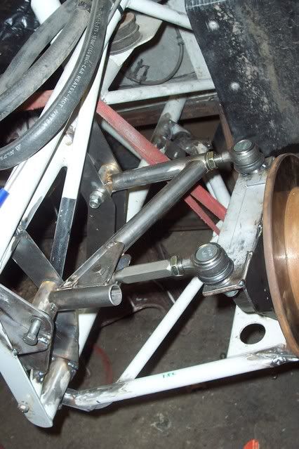

On the story of the mods to my car - the "software" (I think it's more of an elaborate excel sheet to be honest) analysis of my car has revealed the mods required to get the car to handle, and stop being a ditchseeker.
1) fabricate and weld on new suspension hard points on the front and rear of the chassis.
2) modify the rear uprights to remove bump-steer
3) make new front upper suspension wishbones to separate the castor and camber
4) make spacers to reposition the steering rack and eliminate front bump-steer
5) fit front and rear anti-roll bars to counter the increased roll moment, caused by lowering the roll centre.

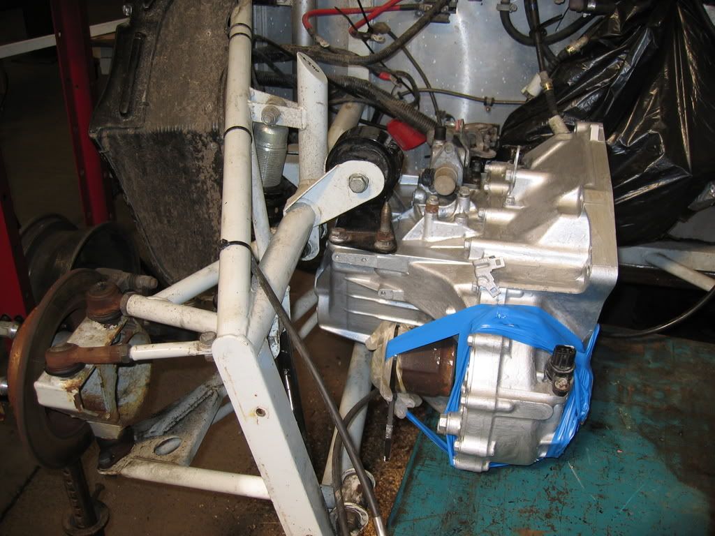

I popped up to Track Developments this morning, taking with me my car's gearbox to chock into place and check clearances.
A couple of pics to keep this thread ticking over....

Offside rear:
