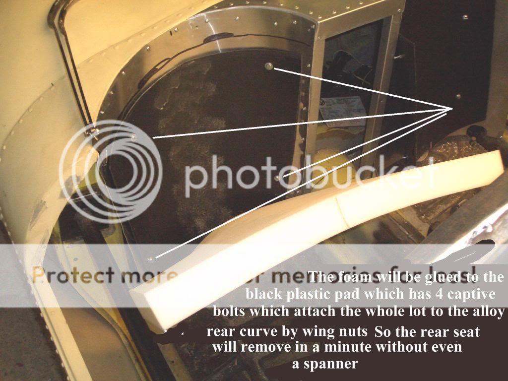

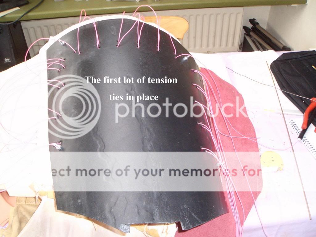

Seat backs
Spent the whole day stitching the seat backs together, and making the plastic backing pads to fit them to.
It is a much more difficult task than I first thought,
(seems like the story of this build!)
But I am closer to the end of it.
Just about everything I put on the car, I try to plan so that it removes easily,
the rears seats are no exception. Although he alloy curved seat backs will unscrew, (8 million screws) I have mounted the foam on the plastic bits I originally used as a pattern for the alloy.
They are held in by only 4 bolts with wing nuts for ease of removal.
I have to somehow make the leather fit the curve, and then colour it.
I thought I could do all this in two days, but now I don't think so.
Here's where I'm at now:

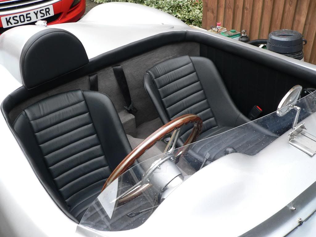

Professionals tackled mine by covering the back and sides first, glueing the leather over thin foam, then adding a 'floating' centre section that runs from top to bottom. Hope you can see what I mean from these pics -
25th March 2014, 18:40
And very nice too! I see how they've done it, but I don't think it will help me as I have already stitched up what I want, ( so don't have the option they had)
And I have to make what I already have look half reasonable when its in place!
It will be awkward, but I now know its do-able, which in my case is most of the battle over. Just gotta do it now!

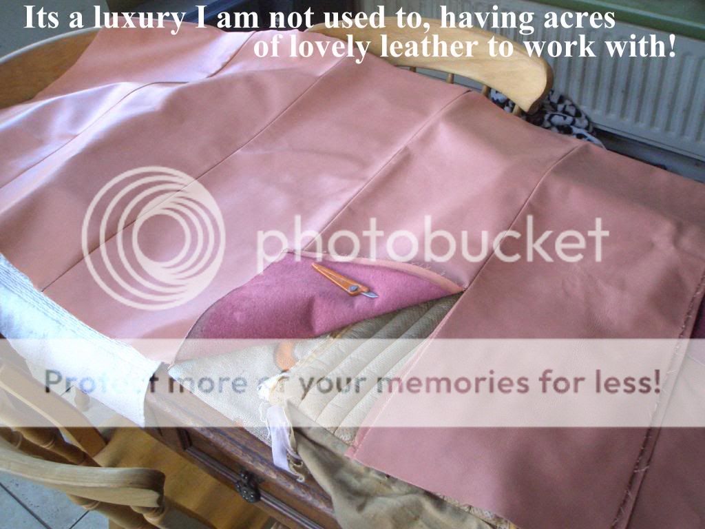

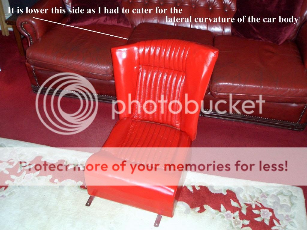

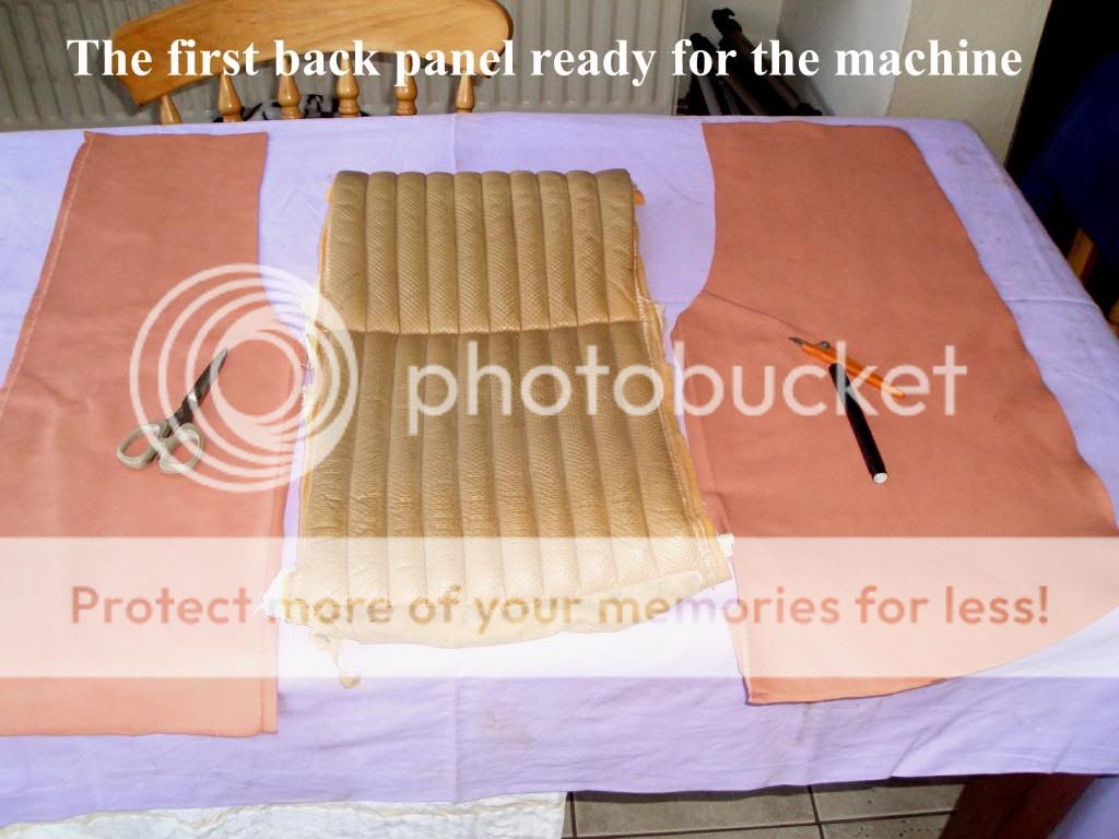

26th March 2014, 21:03
Seat saga
My aim today was to finish the drivers rear seat back.
It proved far too difficult to finish in a day, but I made slow progress.
At least I did move forward. The passengers one will be faster and easier, as I will know exactly what to do, whereas now I am learning as I go, blind leading the blind and all that stuff!
Just two pics:

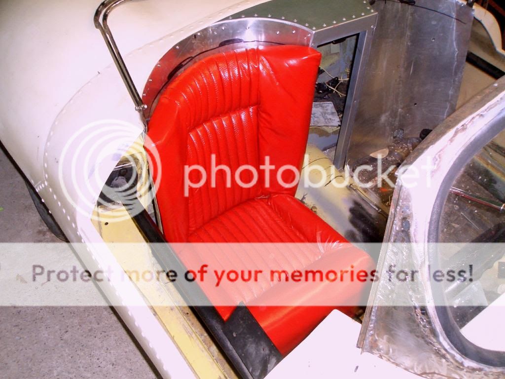

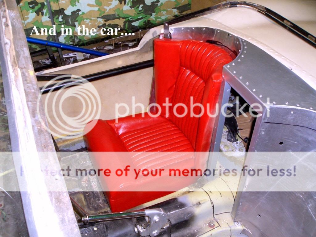

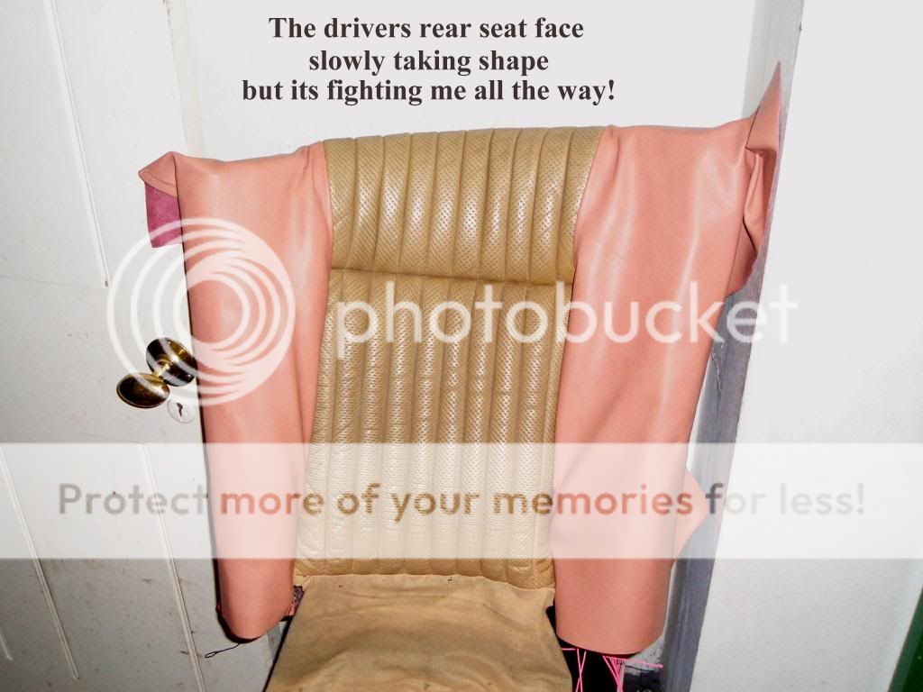

27th March 2014, 14:34
Seat saga.
The aim today was the same as yesterday, which was to finish the drivers rear seat back and get it red.
Today I achieved that. Considering that I had never before designed and made seats from scratch, its not bad for a first attempt.
Similar to the seat bases, its not perfect, and has creases and a few bumps, But by and large I am reasonably pleased with it.
I will tackle the passengers one another day!
Just about had a gut-ful of seats right now.
