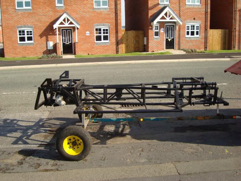

Not quite as quick as that might suggest but I've managed to locate the Jag diff in the chassis and bolt it to it's carrier, just need to get some new bolts to secure it propperly and then the rear suspension can go on. Here it is as was in the road before I dragged it in, it's bolted to an old boat trailer for ease of shifting about, the body is in my avitar. I'll get some pics of the lot soon as and try and explain what I'm trying to do. http://i143.photobucket.com/albums/r...zzzzzzz071.jpg |

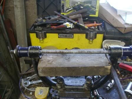

Fitted 12 poly bushes today, that's the back end nearly bushed up. Had a bright idea to remove the old and then fit new bushes. Threaded Rod and two big thick washers,,,,,,,,,,,,,,,, Out with the old http://i143.photobucket.com/albums/r...ldbshout-1.jpg And in with the new http://i143.photobucket.com/albums/r...tol/orthis.jpg http://i143.photobucket.com/albums/r...twoatatime.jpg |

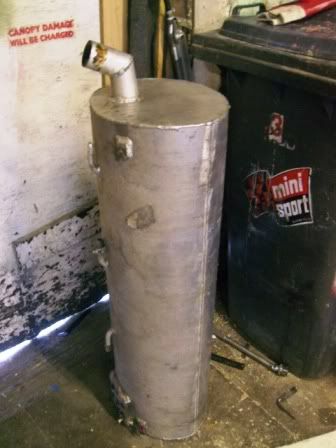

Fuel tank

Seats are small classic buckets from a Cobra and are pretty light, lets guess at 7kg each plus runners for drivers side so that's a guestimate for seats at 20 kg Seats = 20kg Fuel tank comes in at exactly 3 kg so add same again for straps and filler pipe and I guestimate 6 kg Fuel tank = 6 kg So add 111kg to previous total of 509 giving 620 kg on the road without fuel but still have to add radiator and sheet ally covering for tunnel etc so I should think 700 kg is achievable http://i143.photobucket.com/albums/r...tol/kitcar.jpg |
